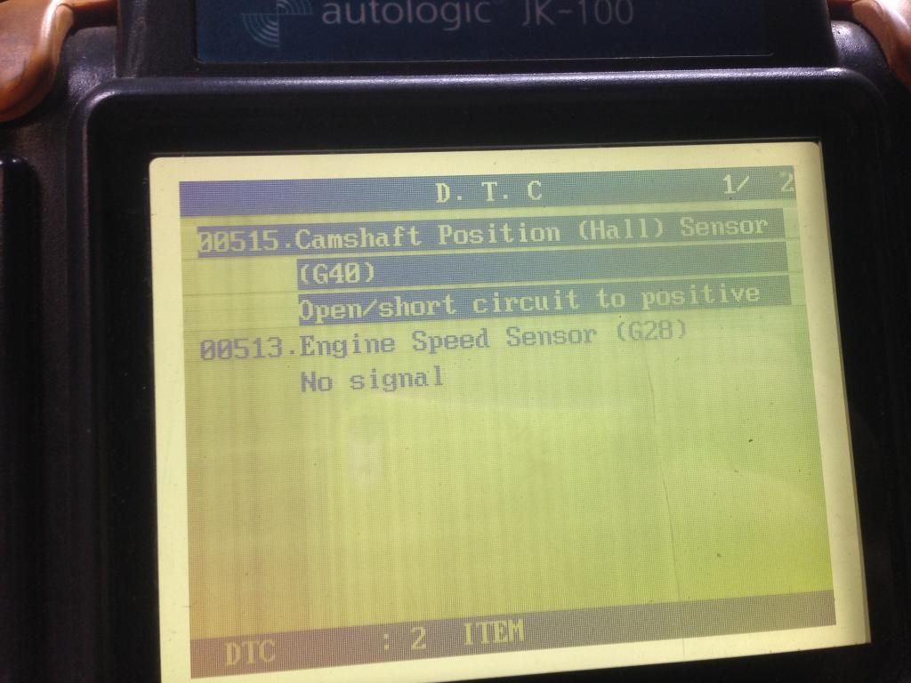

Mccorrymark 10 Posted January 24, 2015 Hey guys so I got the 00515 fault on my 2.9 vr6 corrado it's an early 92 dizzy engine I'm I right to believe this engine doesn't have a cam sensor? I replaced the crank sensor today it's running better but fault keeps coming back any advice? Quote Share this post Link to post Share on other sites

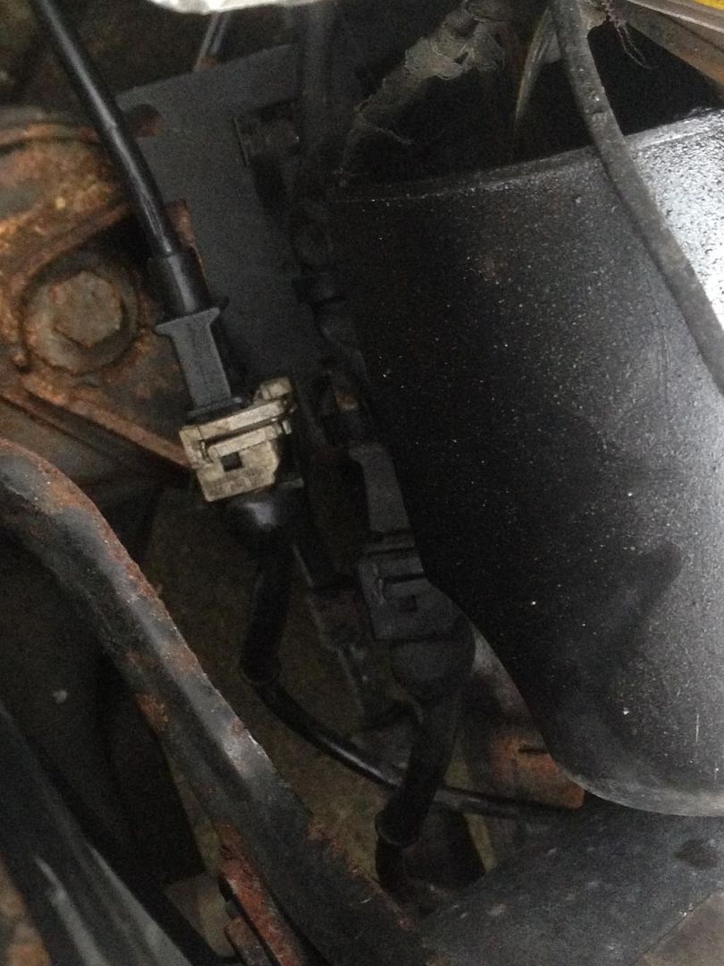

Mccorrymark 10 Posted January 24, 2015 Also someone told me the crank sensor is the black connector but mine was connected to the White one so I reconnected it to the White one perhaps this was connected wrong in first place?? Quote Share this post Link to post Share on other sites
Mk3highline 10 Posted January 24, 2015 I managed to put the cam sensor plug on the speed sensor and vice versa Ignore that mine is ibd2 Quote Share this post Link to post Share on other sites
Mccorrymark 10 Posted January 24, 2015 Yeah I'm not sure mine has a cam sensor Quote Share this post Link to post Share on other sites
Dox 28 Posted January 24, 2015 The speed sensor is the crank sensor (not cam sensor) You will get a code for the crank sensor if if you do a scan and the engine's not running. If the engine runs its unlikely to be the crank sensor - a faulty crank sensor will give no spark or fuel injected. Crank sensors can give missfires when they start to break down. Quote Share this post Link to post Share on other sites
Mccorrymark 10 Posted January 24, 2015 The car was running wrough when I drive it out to get crank sensor done after that it was running a lot better the crank sensor was goin bad when it warmed up apparently this can happen and when the car had been drove some times it died and wudnt spark again sometimes for hours Quote Share this post Link to post Share on other sites
Dox 28 Posted January 24, 2015 I think the hall sensor is inside the dizzy, I'm not 100% sure, my cars are coilpack, others will advise you better Quote Share this post Link to post Share on other sites
