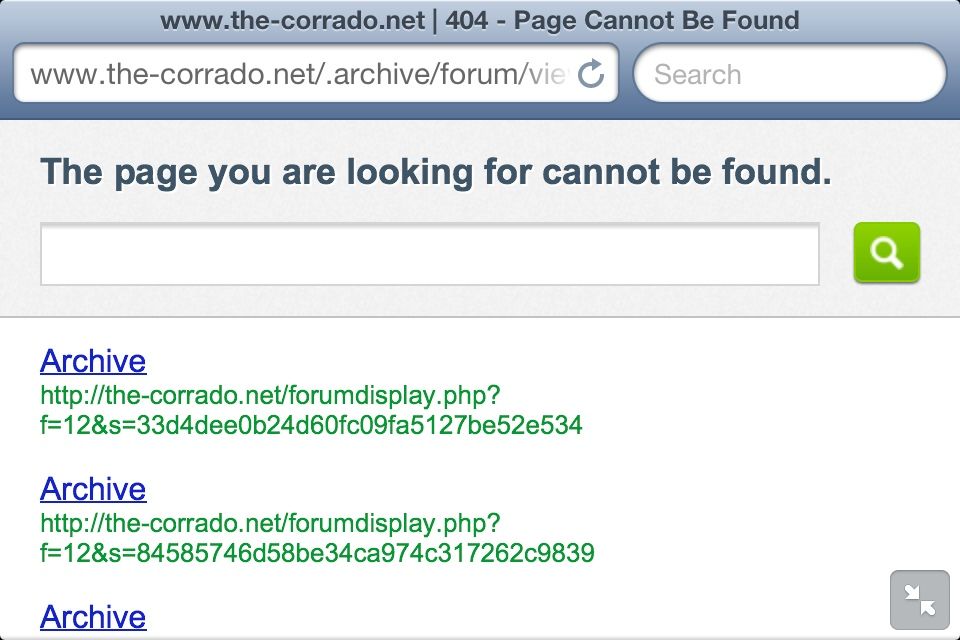

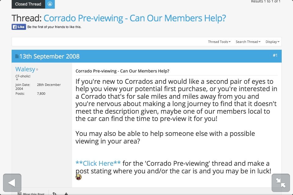

Wayne2015 10 Posted February 20, 2015 How do u find members locally? Link does not seem to work :( http://the-corrado.net/showthread.php?t=40736 Quote Share this post Link to post Share on other sites

Wayne2015 10 Posted February 20, 2015 I would be interested to know of any on my area too Chuggs Admin just said that link no longer works :( Quote Share this post Link to post Share on other sites
