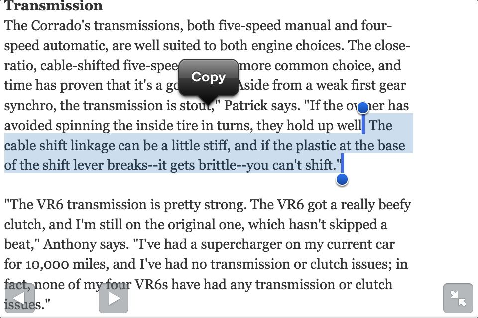

Wayne2015 10 Posted February 22, 2015 (edited) Interesting read here : http://www.hemmings.com/hsx/stories/2013/09/01/hmn_buyers_guide1.html Remember when my car couldnt shift into any gear? Is this the cause? Edited February 22, 2015 by Wayne2015 Quote Share this post Link to post Share on other sites
