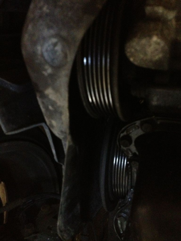

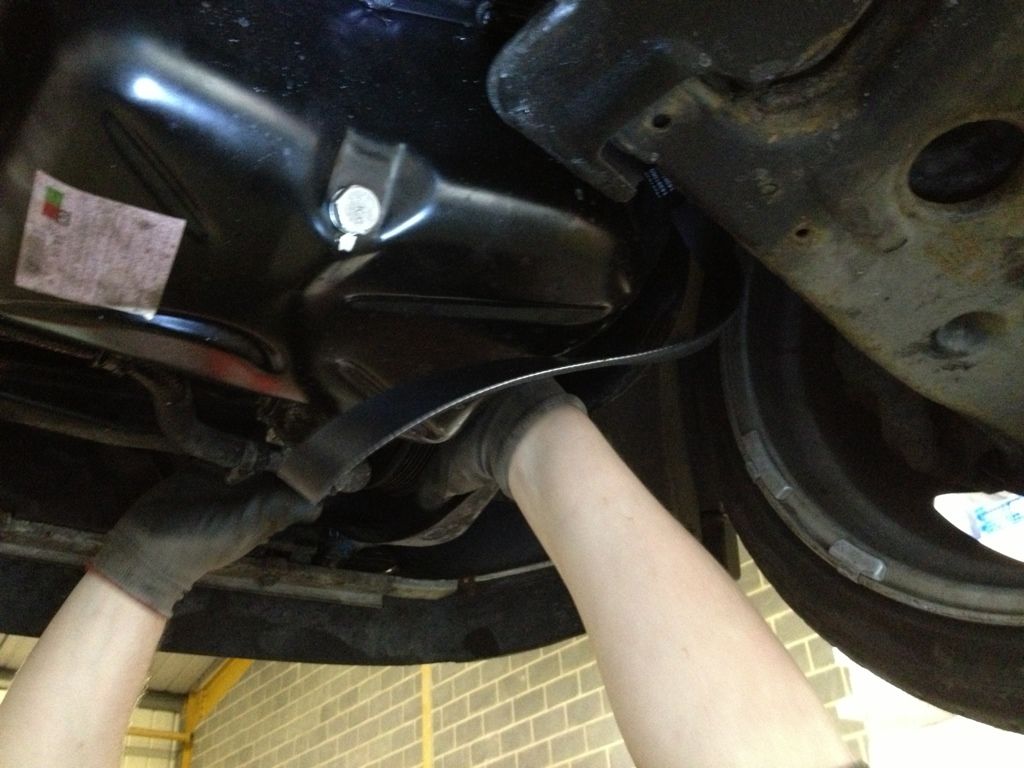

- yank drive belt off from below
And put it back on from below AND above
Insert bolt to adjust width to ease on/off drive belt ...

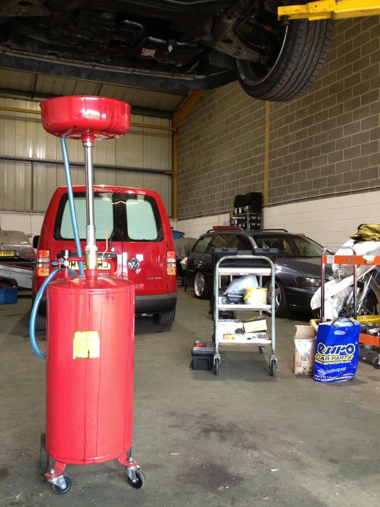

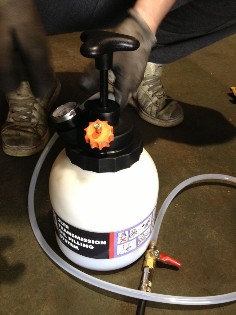

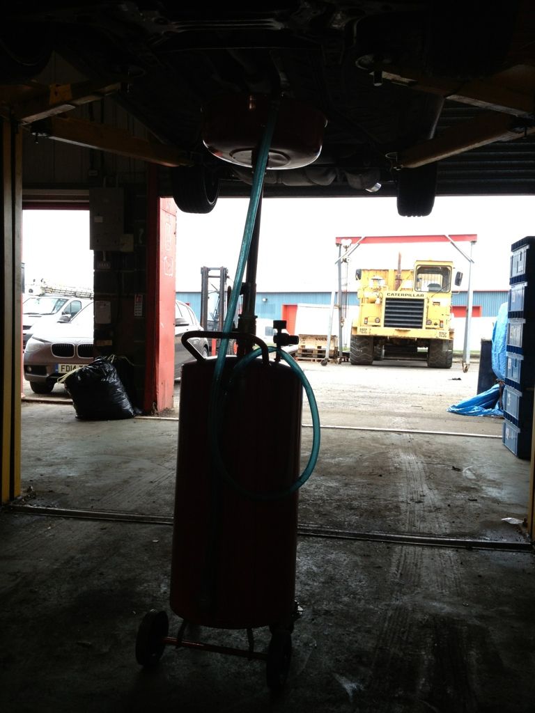

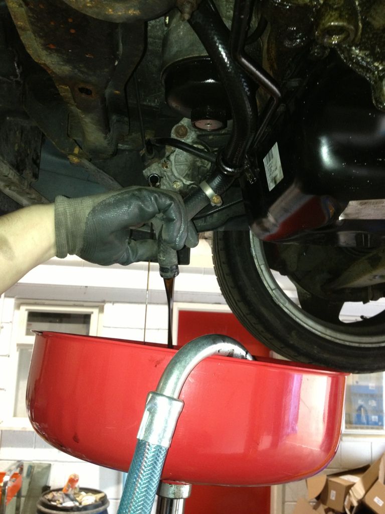

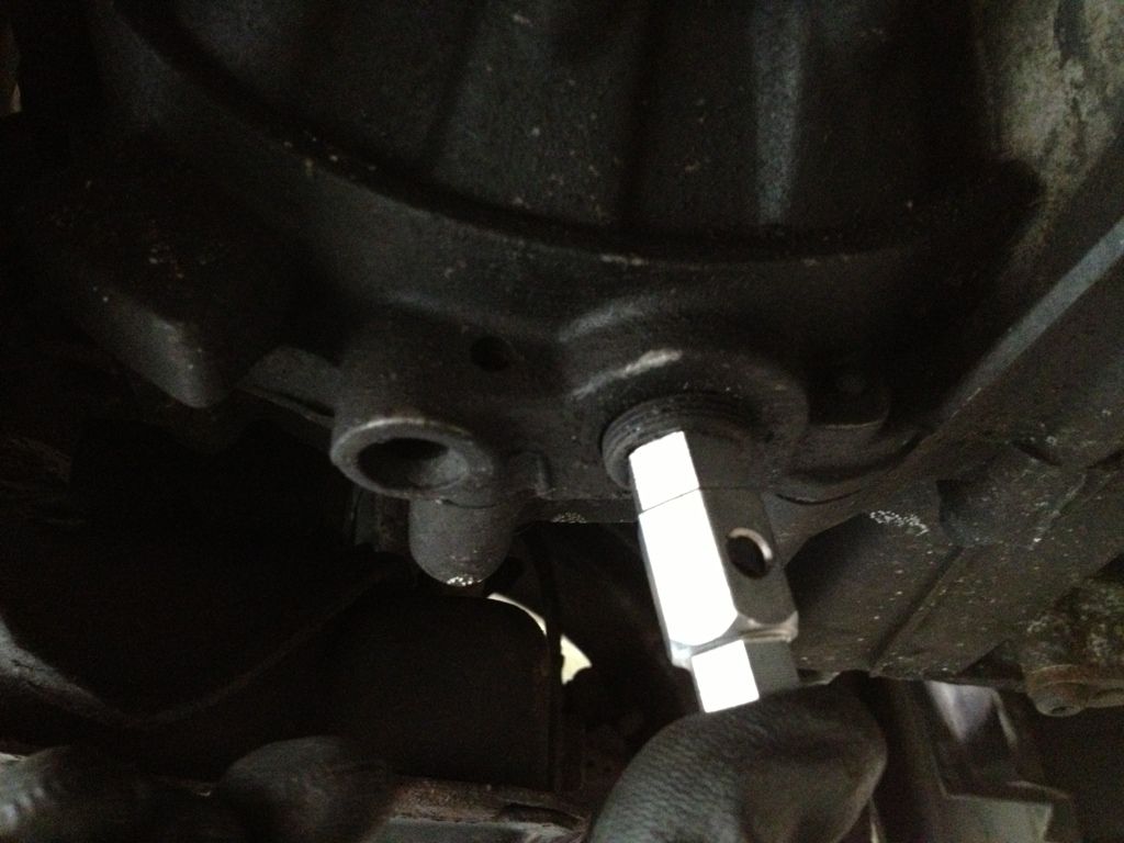

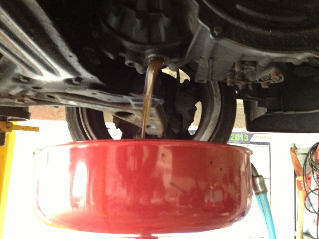

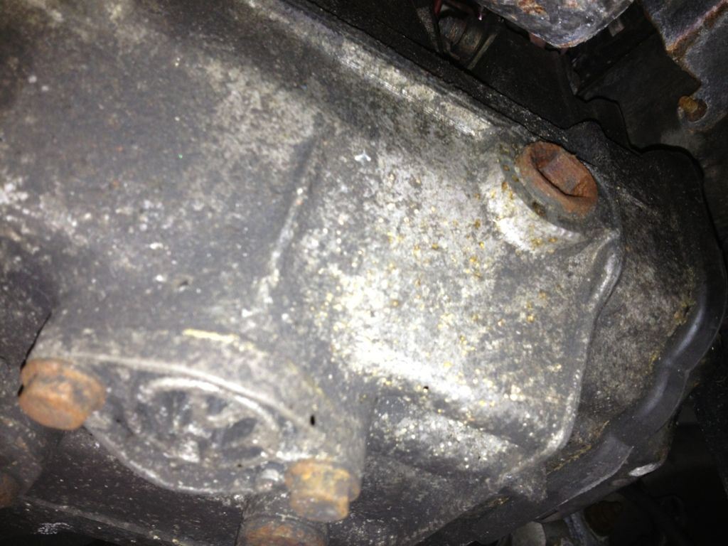

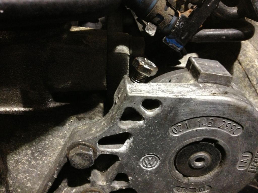

- replace gearbox oil
One plug underneath to drain
One on side to fill from a bottle pressure thing
Drain barrel to catch fluid

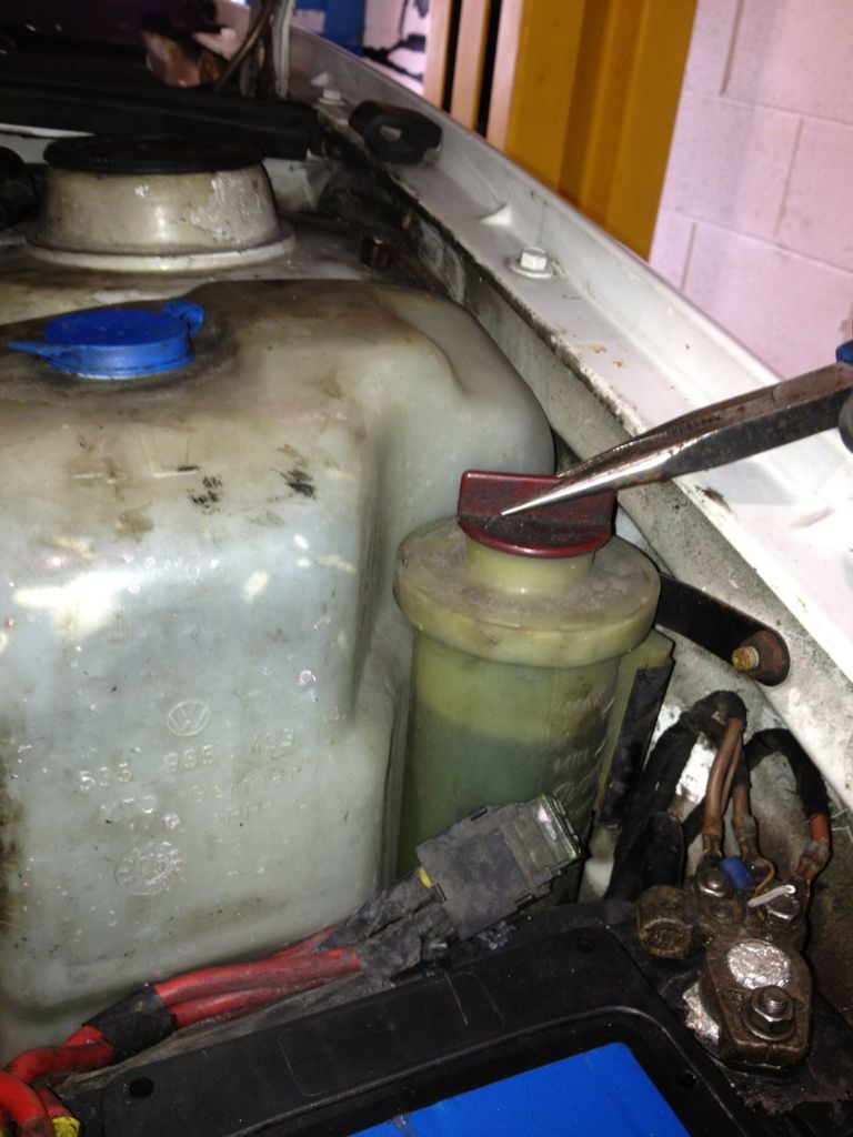

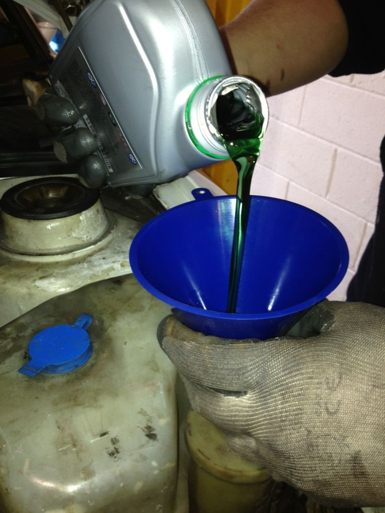

- replace PAS fluid
Open PAS fluid bottle cap
Just unattach lowest tube and drain as much
Fill up (fluid is GREEN!)
Then
We started car and then turn steering wheel full lock and topped up ad necessary

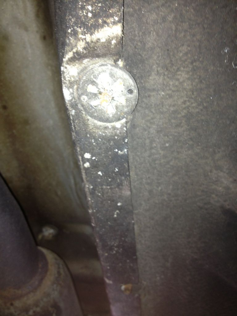

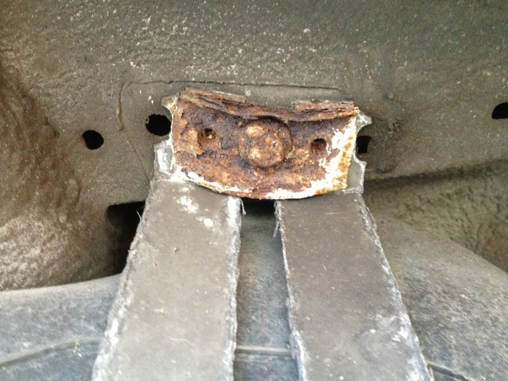

Quick inspection...

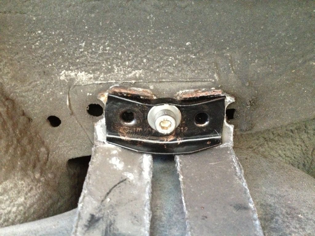

Car front missing a cover for tow eye?
Missing a few of these from underneath
Chris had a spare bracket for this ..

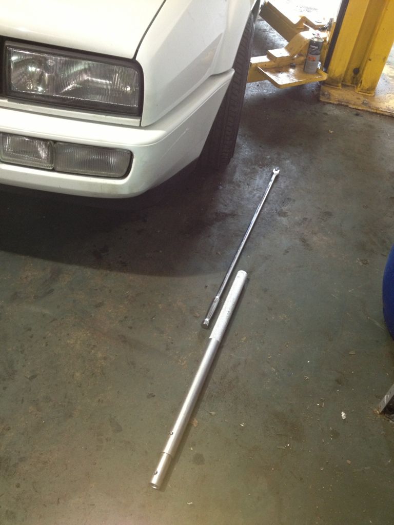

And the nightmare of all nightmares begins...

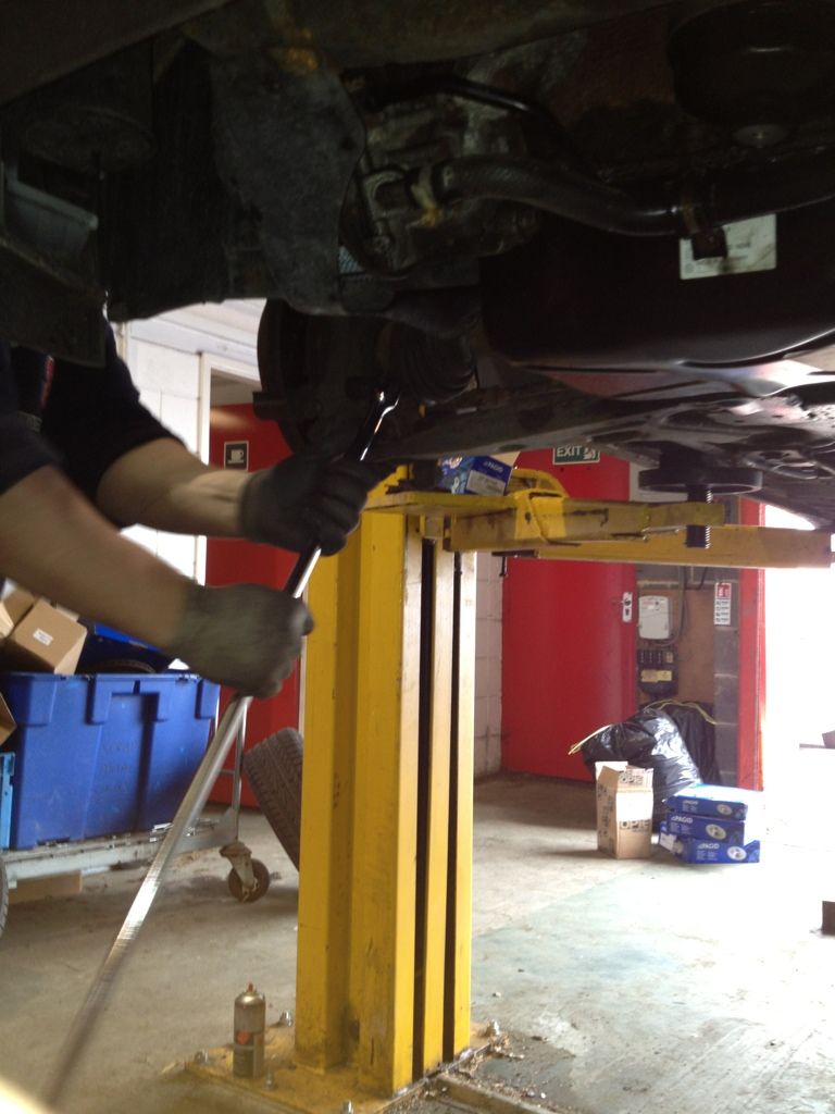

I had a 3ft breaker bar
Chris had a 2-3ft metal pipe
No, we did NOT fall out and fought - lol :)
With these massive leverage on the wheel nuts we could not get the damn nuts off ?!!!!!! EEEKKK!
In the end, Chris next door neighbour s unit - came round with an IMPACT NUT jobbie???
He gave the nuts a few whack and yay!!! :)
(Sorry no pic :()
Nuts off

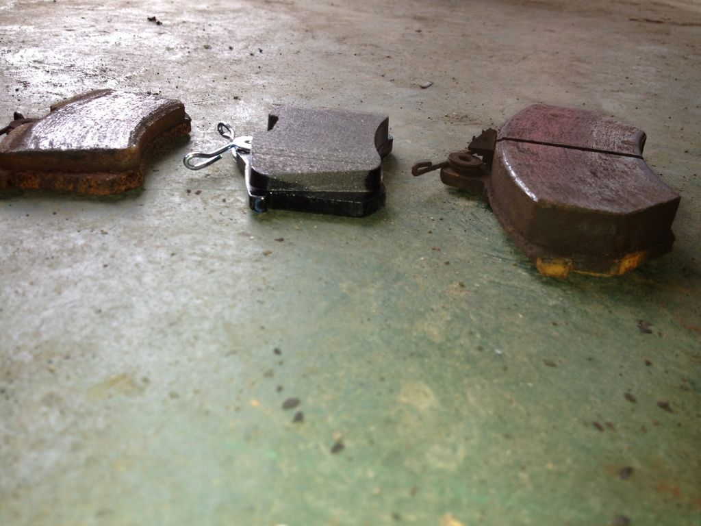

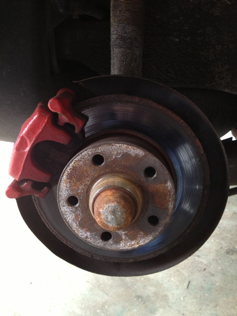

Old discs
Front pads were like NEW!
Rear were shot and uneven wear
(Left old rear, middle new rear, right old front)
Old rears (driver/passenger side)

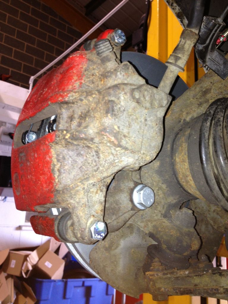

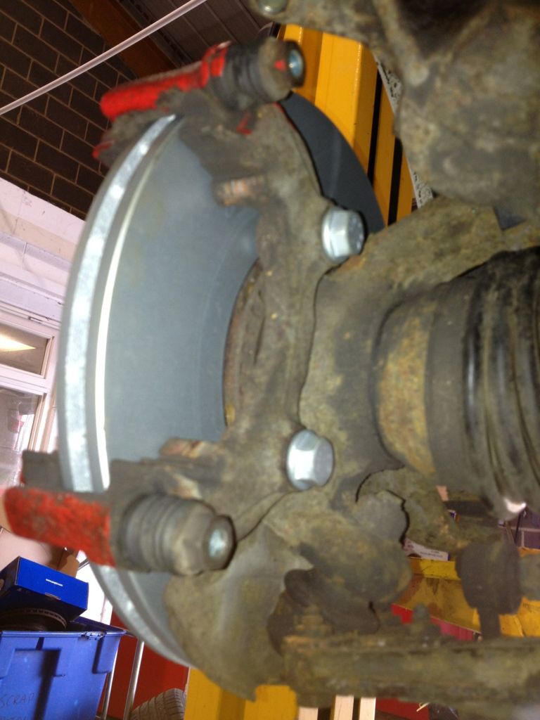

Replace front disc/pad

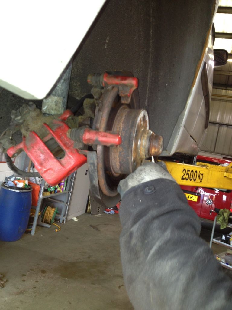

-open brake fluid bottle cap
- remove caliper (but not completely)
- remove carrier completely (with pads)
- remove old discs
- push caliper piston back
- fit new disc/pad
- refit carrier/calipers using new bolts (except one caliper bolt as new pads only came with one...)
We were wondering if new pads only came with one new caliper bolt
how to change pads WITHOUT removing the other caliper bolt??!

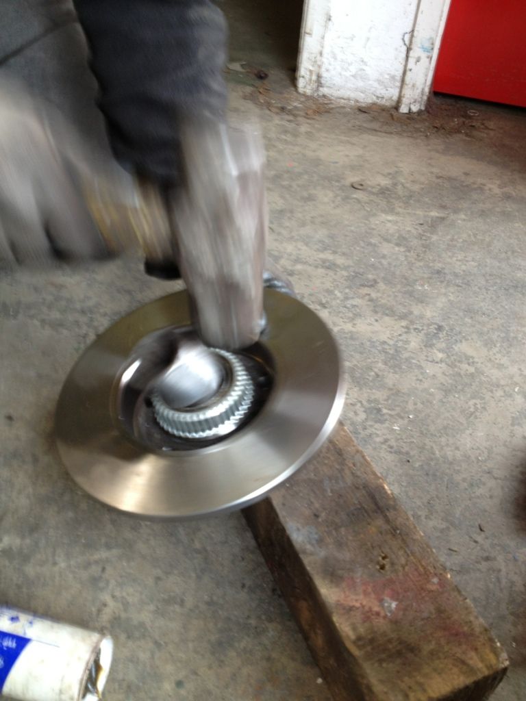

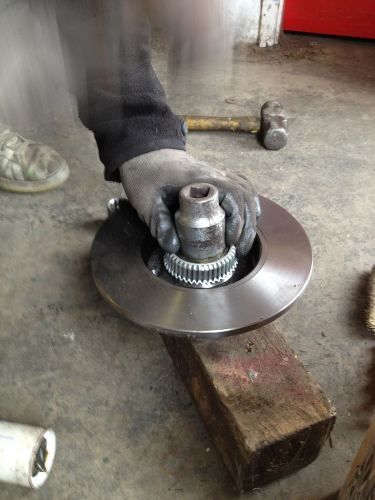

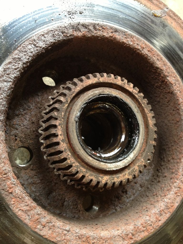

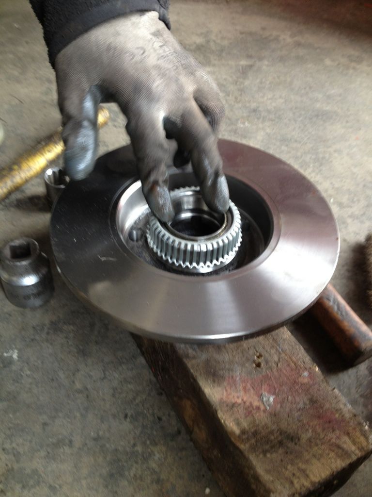

- rear bearings
Remove old rear bearings (cap, pin, bearings)
- fit new bearings ring?
WHACK it in!
Fit rear discs
Insert bearings, pin, grease (wasnt included in kit :(), cap
I tried to salvage rear disc ABS Ring - no chance :(
Nightmare 2....

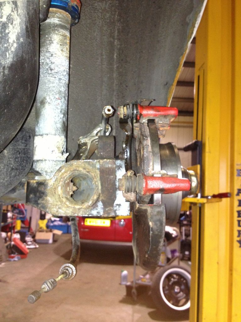

We couldnt push back the rear caliper pistons ?!!! :( EEEEK!
We pushed
Whacked
Small G-glamp
GIANT G-glamp

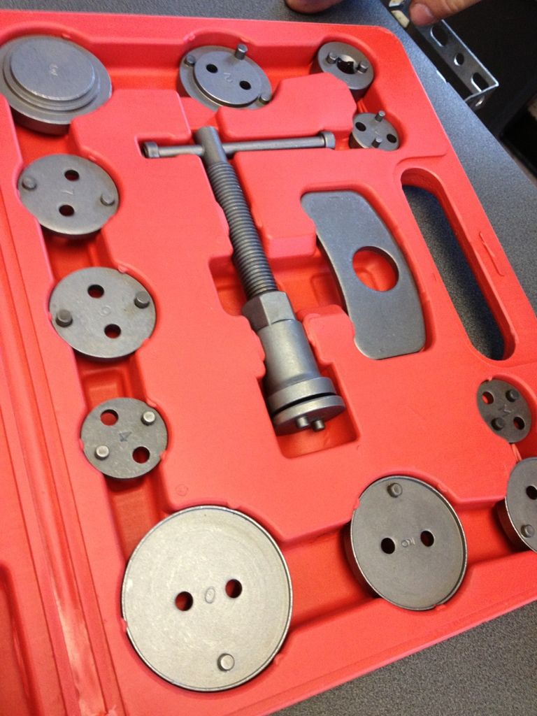

Frantic phone calls all round and we were told to use a Rewinding tool
With being a Sunday and 5mins before Wilco shuts!
Rushed out to buy one £25
Yay!
But ...
Left hand push? Right?
Push and turn?
...it didnt work!
We bled the bleed nipples too ...
ARGGGGHHHHHH!
Our saviour came to our rescue again!
Next door neighbour ...
Chris remove the calipers and asked next door ...
Worktop vice did the job!!! :)

Great stuff.... Sounds like chris did you proud you bought abs rings for the rear then....
With reference to rear calipers, winding back is made easier by compressing the abs compensator, I normally put a g clamp over it. It allows fluid to go back up the system. With the car off the ground there is no load on the rear wheels.
Sounds like the vice sorted it.

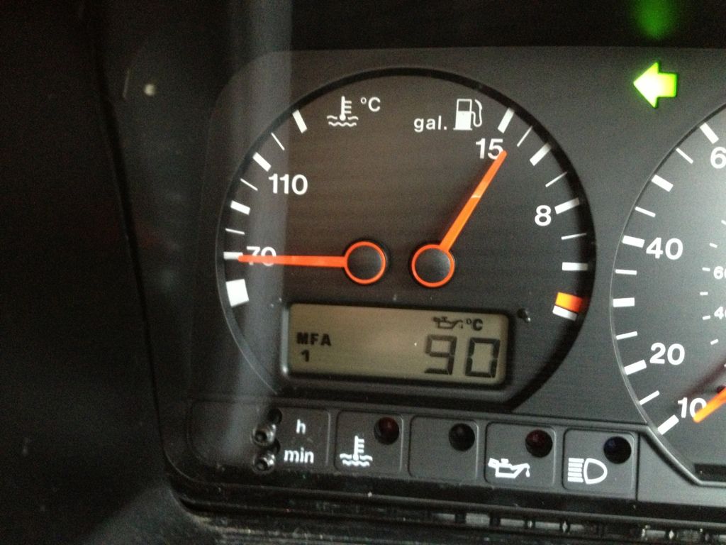

No leaks underneath
Temps fine ...

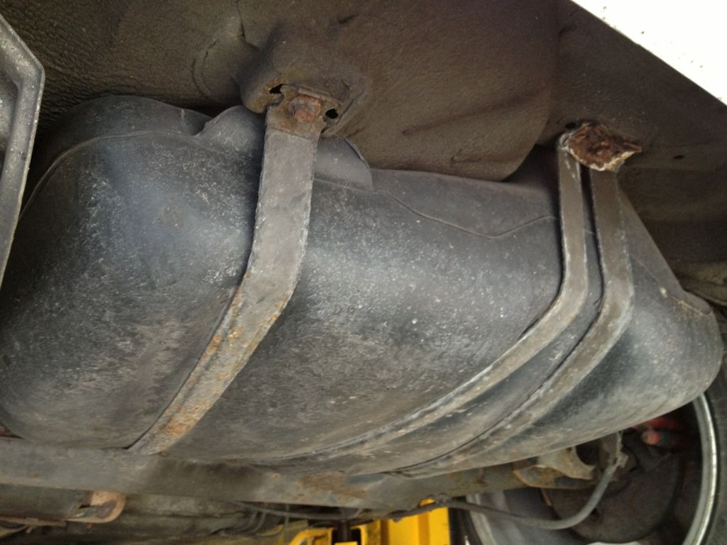

Roof leak i have taped where it leaks ...
But a LOT more surface rust has appeared :(
All around rear arches
All along bottlm of driver door :(
The future is NOT clear
The future is more ££££££ :( and RUST! and STALLING and ...

I mean brake load compensator not abs compensator talking rubbish.... It's a square box on the pass side rear. Just in front of axle.

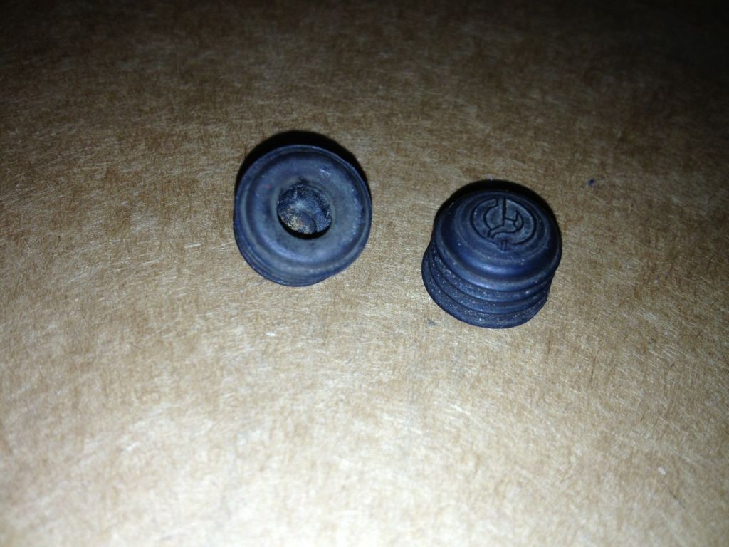

As for the nipple covers... well i did say keep em safe ;)

And if I get a new bolt - what if the bolt threaded hole is worn or knackered by that wood screw??? EEEK! :( :o :((
Crack the bleed nipple when you are retracting calipers. Saves potentially damaging seals elsewhere that are not used to fluid going in the opposite direction. No need to mess with compensator valves either :-)
Didn't you get the car from a trader Wayne? I'd be round there demanding they cough up toward repairs or fix them asap! It's really not going well for you is it mate. Makes me sad someone genuine like yourself is having to deal with all this, and regretting ever buying what CAN be such an enjoyable car to own. :(
OK!
If the thread is gone you need a new handle or to have the thread tapped and helicoiled.
Yes!
That means I can buy ANY cheap bolts to fit after!
I just bought one 7mm for my Prelude! :)
Wait.....I would need to drill into that METAL handle???
No no no :(
And that hole looks teeny too :( :( :(
