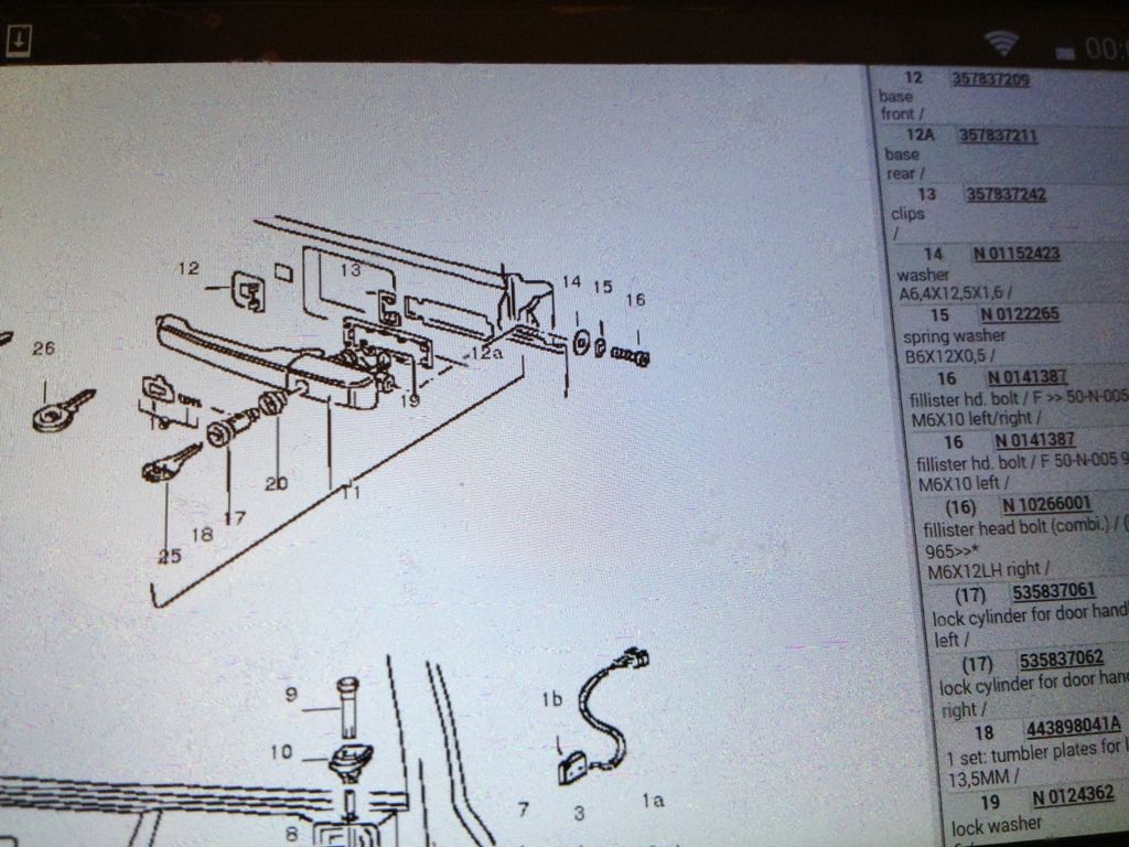

Wayne2015 10 Posted March 17, 2015 Guys I lost the white plastic disc behind the handle U just about see it in the pic here.. Can u see what part number it is from here? Above pic Also confirms door shut bolt to fix handle is a FILLISTER BOLT :) But when the pic says LEFT is that driver side or passenger? As the RIGHT BOLT is a left-hand-thread ... Quote Share this post Link to post Share on other sites
