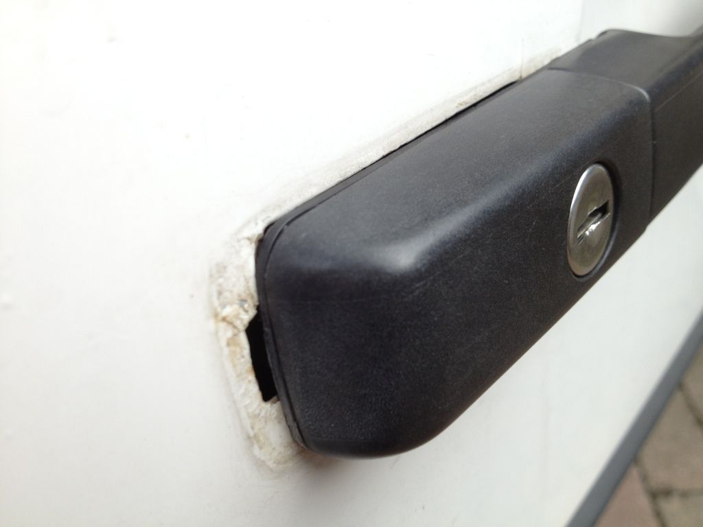

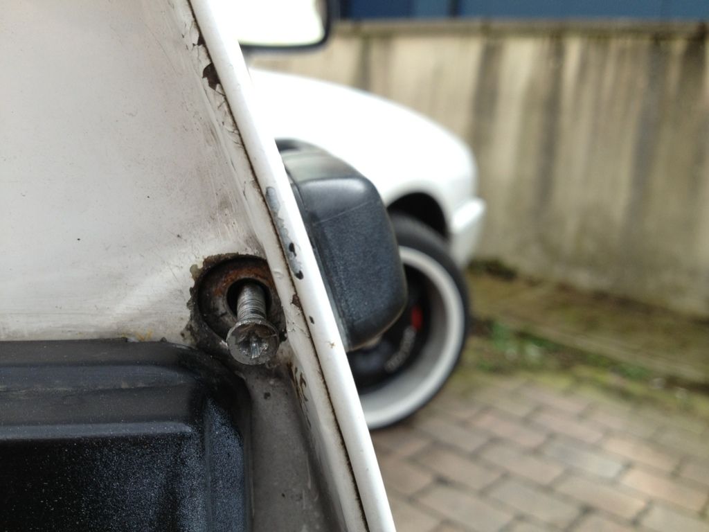

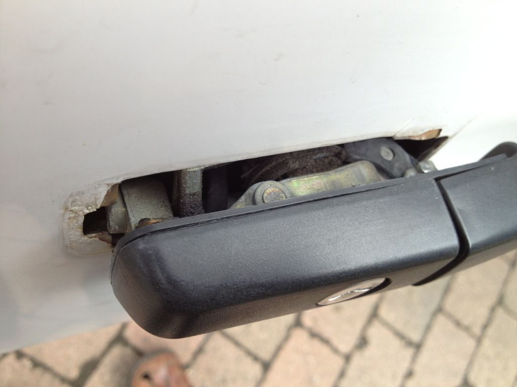

My current door handles:
Hopefully get some new bolts by end of this week?
So i feel UNSAFE to drive (esp with kids)
And car door can easily be OPENED with the handle like that :eek:
