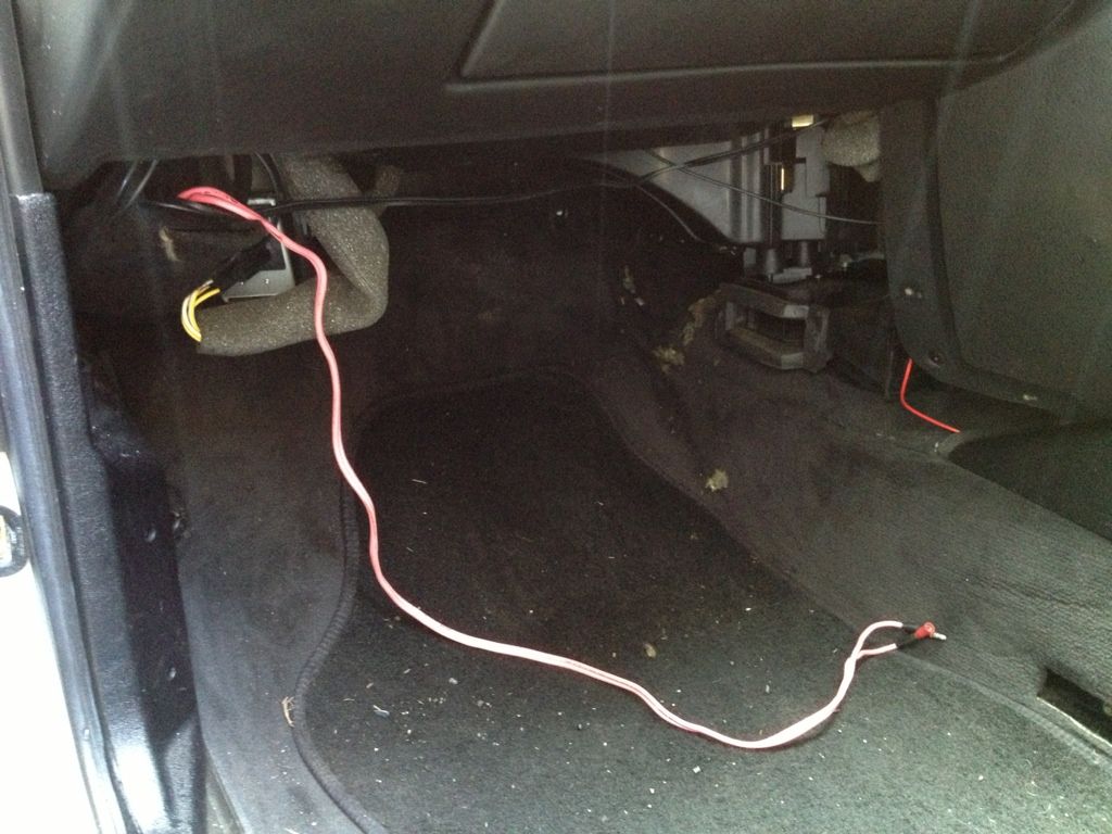

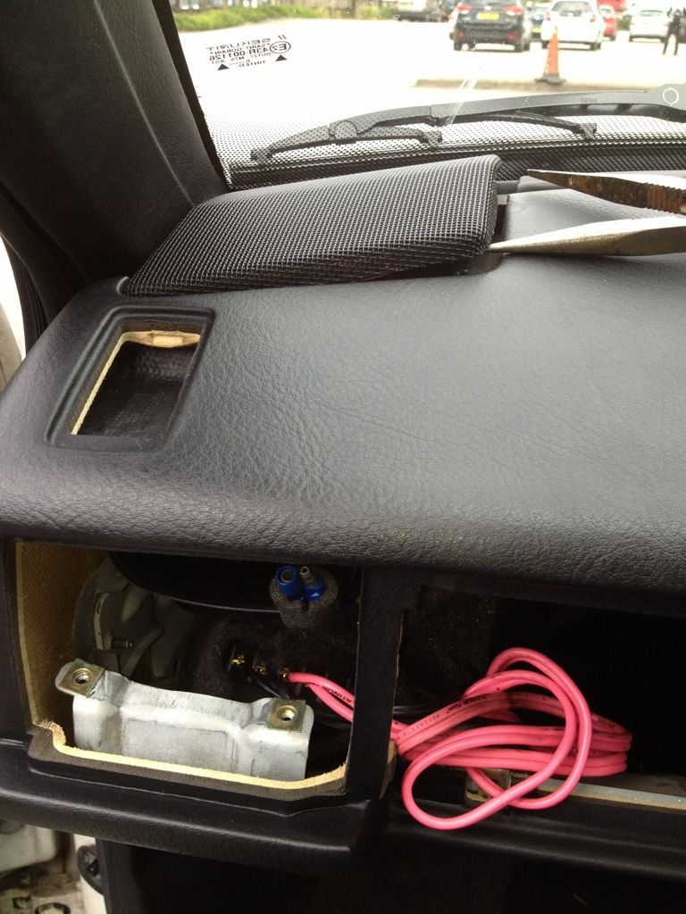

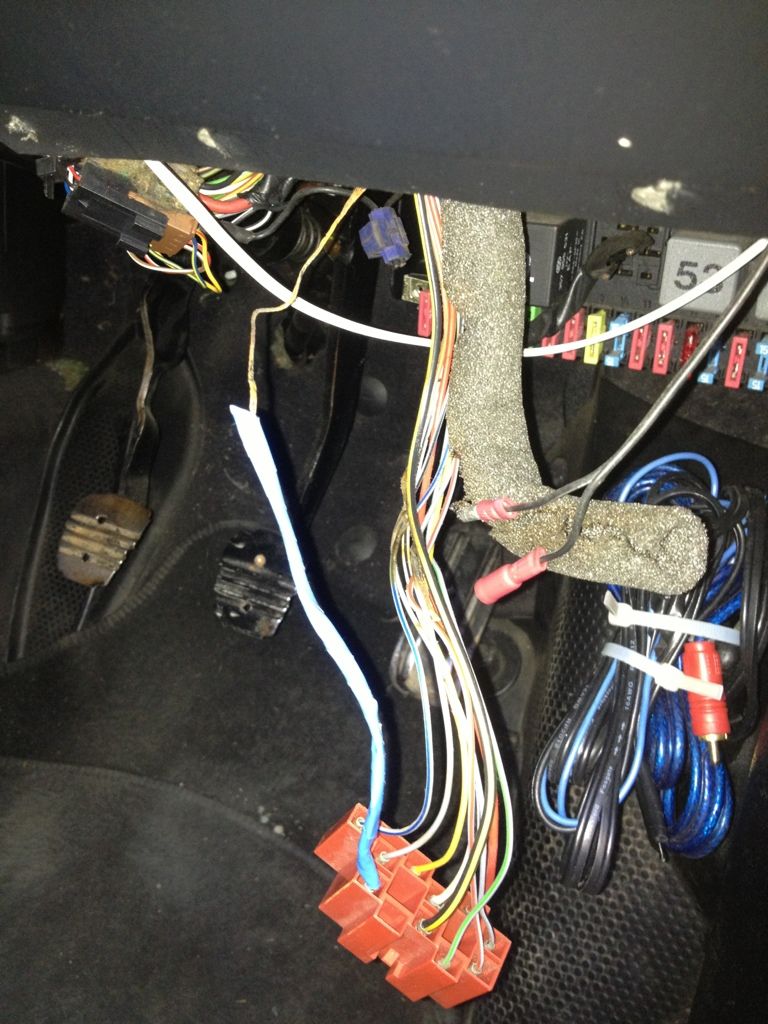

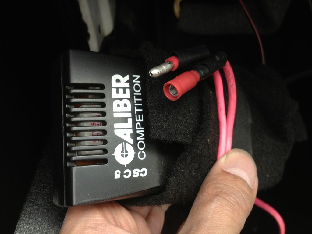

Black doesn't need taping, red wants removing ideally (unless you want to fit an amp) but to do this you'll need to remove the fuse (if it has one and hasn't already been removed).
Cool
Think will leave it in as less likely to create another problem if i start to remove things etc
Is a plastic block terminal best to cap off the red cables that are taped into one?
Cant think of anythingelse to cap it off?? :shrug:
Cool
They need to come out if your not running an amp. Shouldn't take long to do. Need to arrange for you to pop up to mine one night for me to sort and fit your headlight loom.
Cool
Thanks Stuart! :thumbleft: :D
Remember the wires took off your battery they were for the amp, with melted fuse holders. So them wires should be all dead. But like MZPog says, it's best to remove all that crap if your not going to be running an amp.
Oh yeah! :thumbleft:

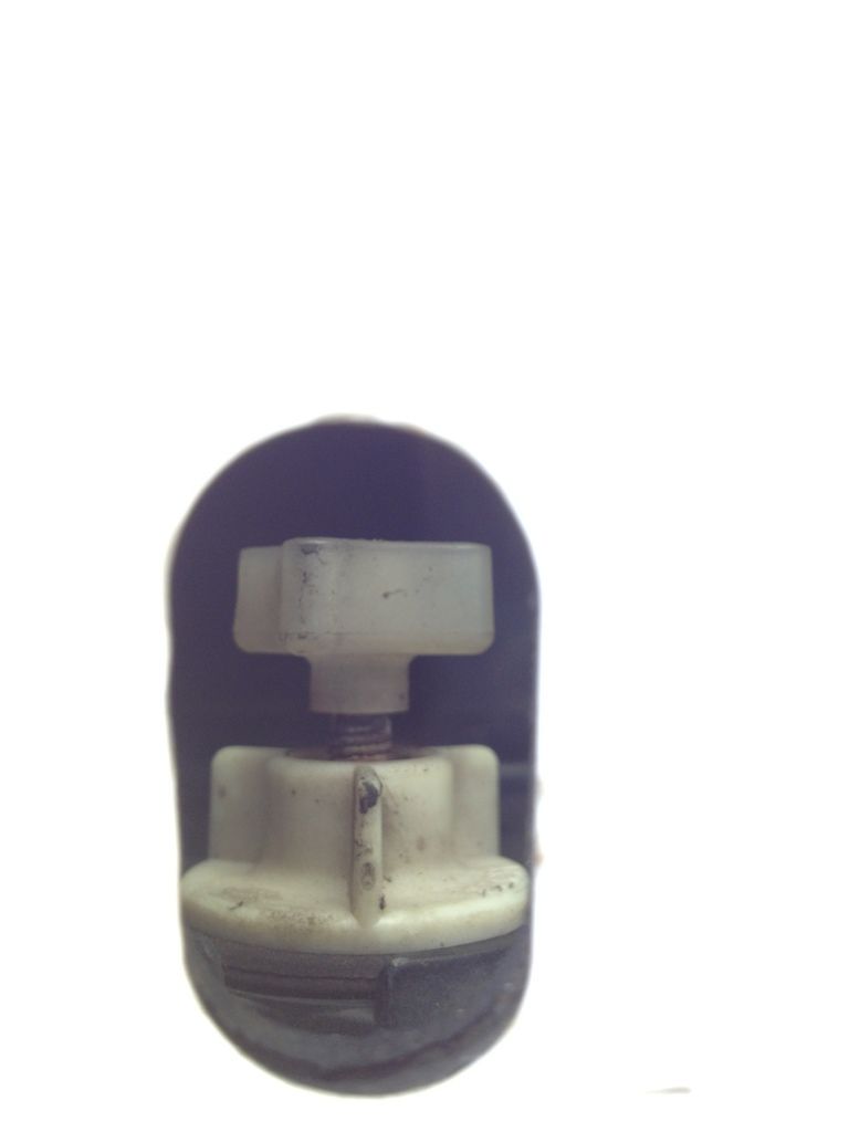

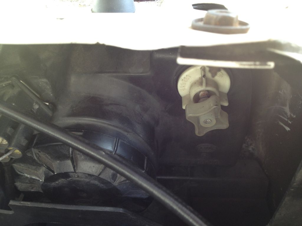

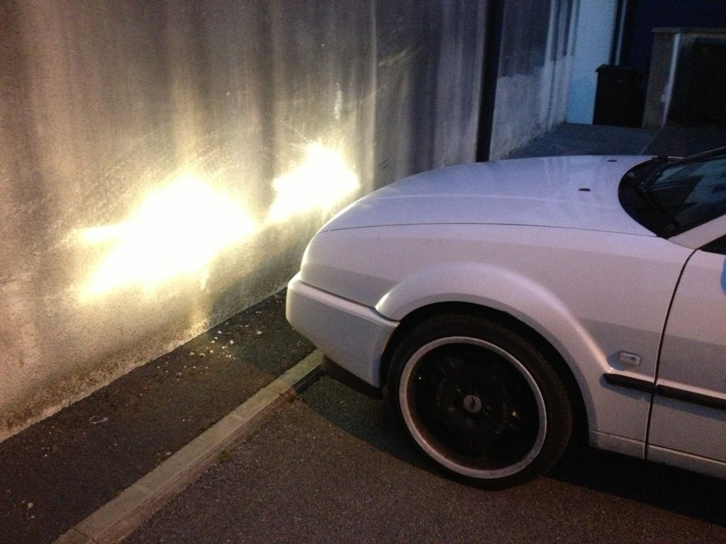

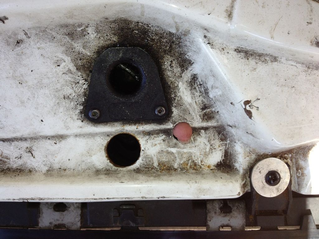

For headlight alignment...
Ok

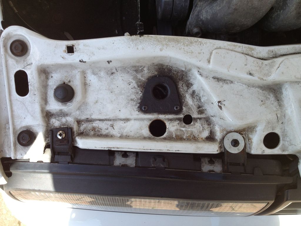

I can find A (height adjustment)
But
For B (side adjustment)
There is NOTHING in the B-hole (where my finger is)?!!! :eek: :shocked!: :(

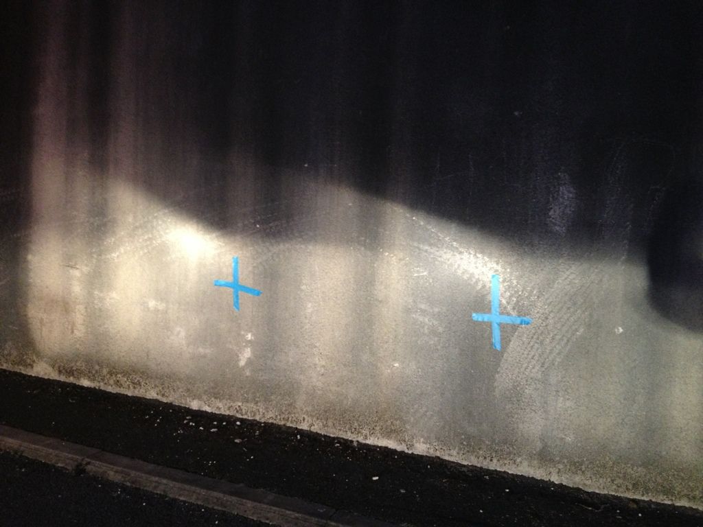

Well

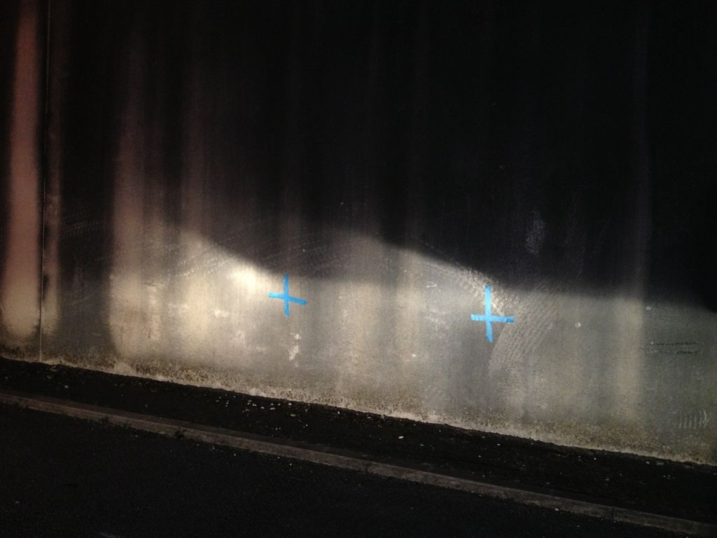

Think my lights aiming too high since i changed the bulbs :cool:

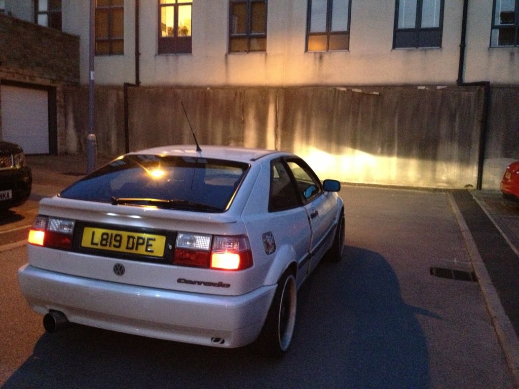

Bit of research and DIY headlight alignment (i probably done it wrong - but hey its lowered :thumbleft:) :lol:

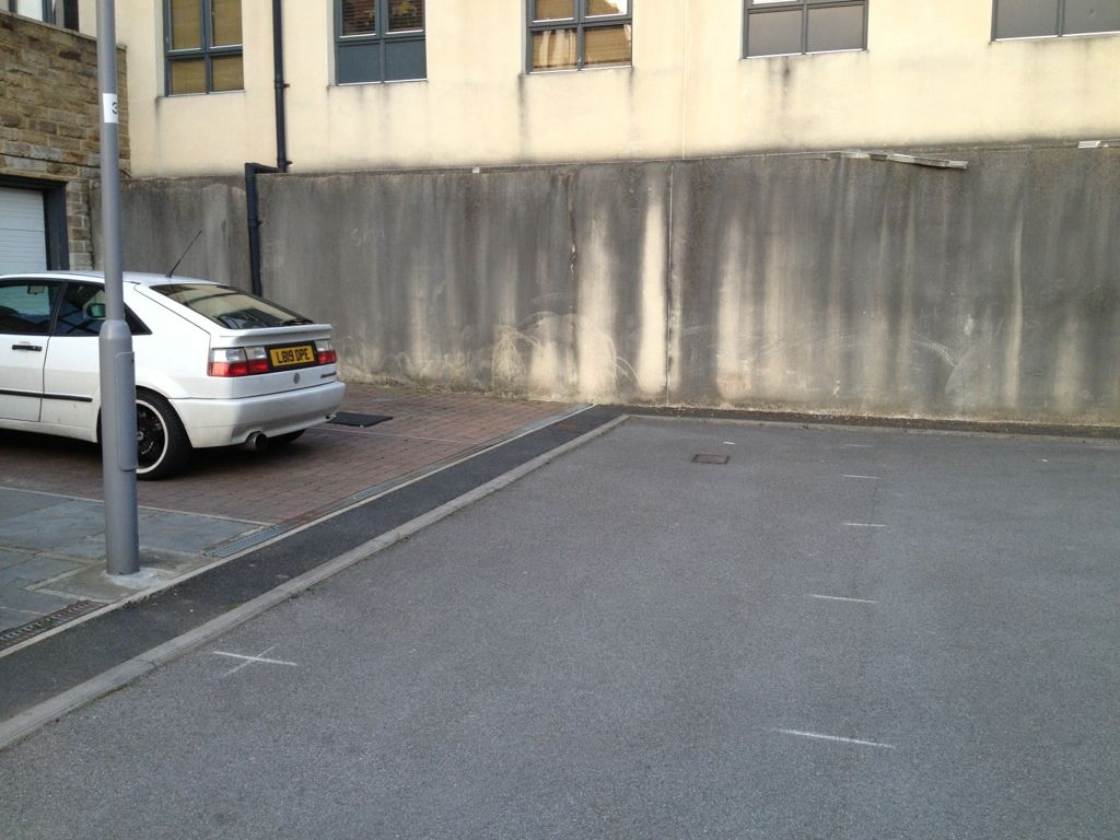

Mark 25ft from wall on flat road
Mark centre of each light when car is right close to wall (BLUE TAPE)
Reverse to 25ft line
BEFORE
AFTER (turn WHITE knob behind headlight to adjust height)
I have NO IDEA where horizontal adjustment is?!!! :shrug: :bonk:
I think u meant to:
1. BLUE tape TOP of light at middle on wall
2. Then reverse and adjust height until light is STILL below the BLUE tape
3. And adjust horizontal until slant of light also meets BLUE tape

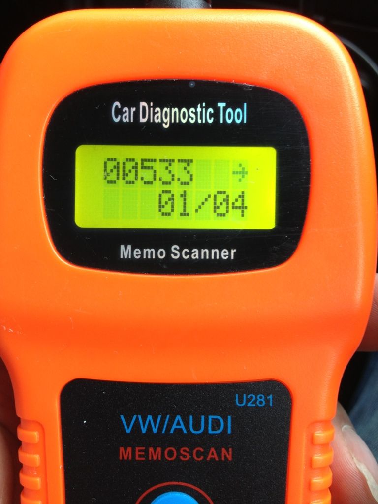

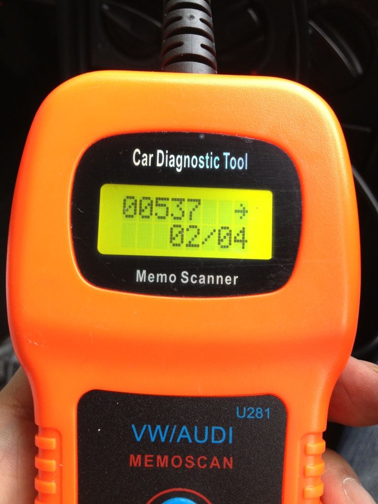

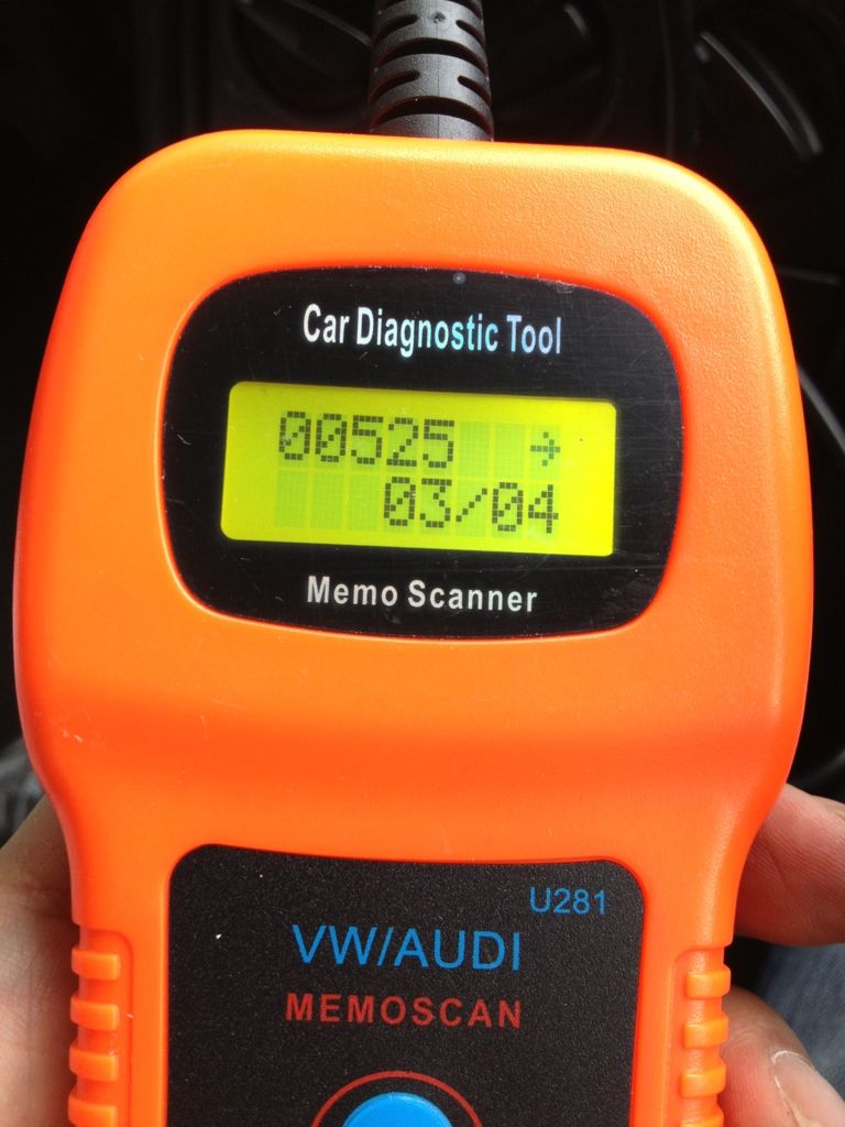

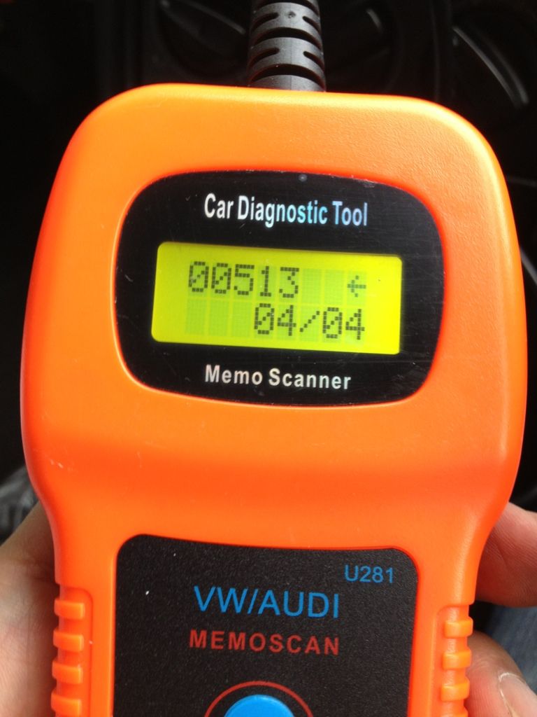

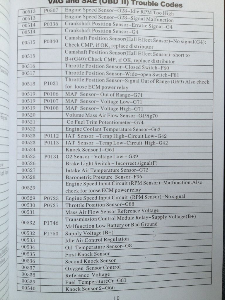

Car s starting to stall again :eek: :shocked!:
So did a scan (with engine off)
533: idle air control reg
537: oxygen sensor control
525: O2 sensor - voltage low
513: engine speed sensor - signal malfunction
Engine back on and...
No faults :thumbleft: :)
But thats becaused its not stall yet :shocked!:
Checking a few things ...

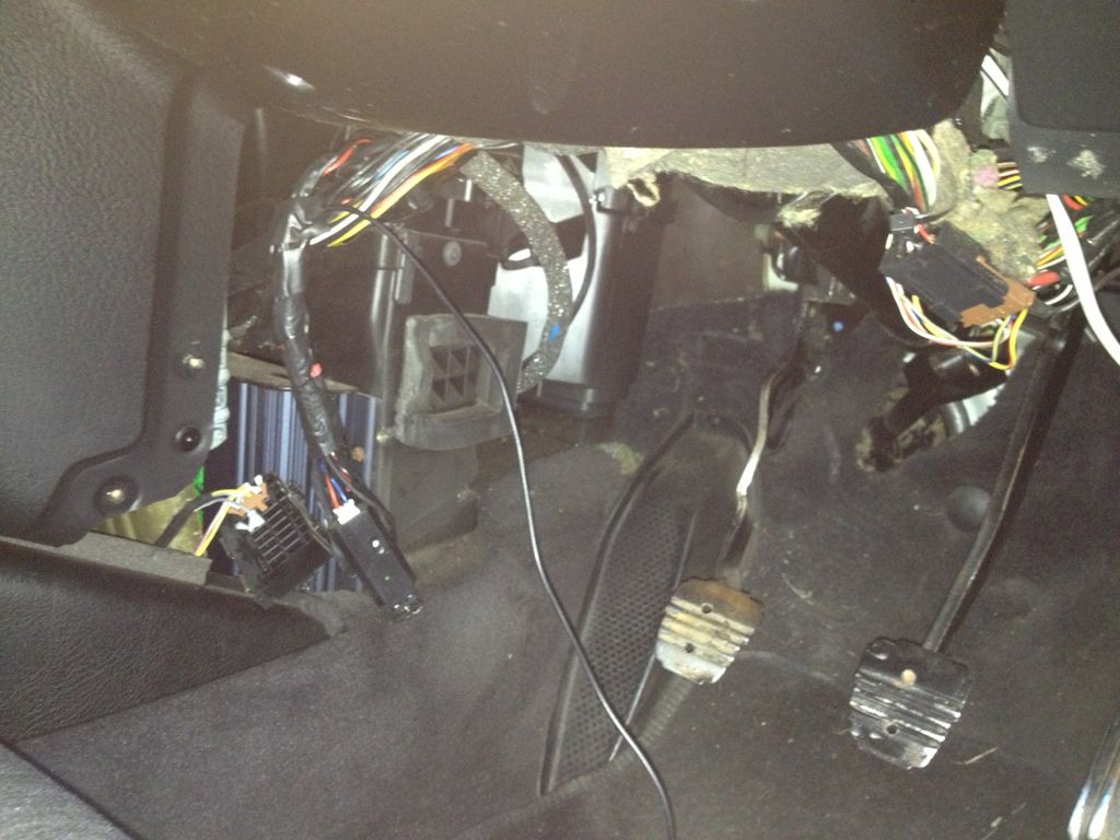

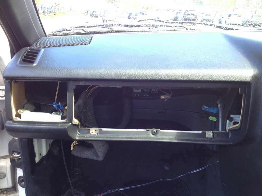

Wires everywhere :eek:

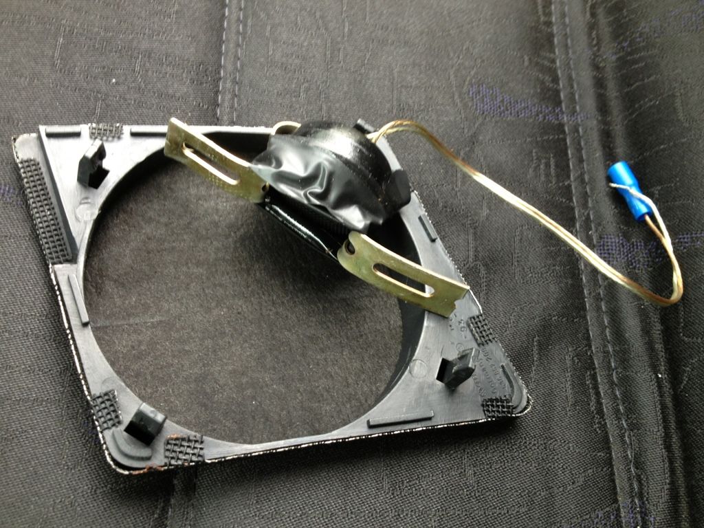

Dash speaker not connected :eek:

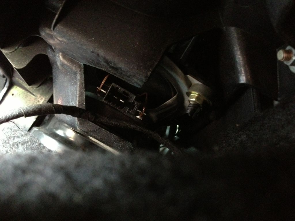

Rear speakers - what sockets are these?
If no spade connectors - how do u connect speaker wires??? :shrug:

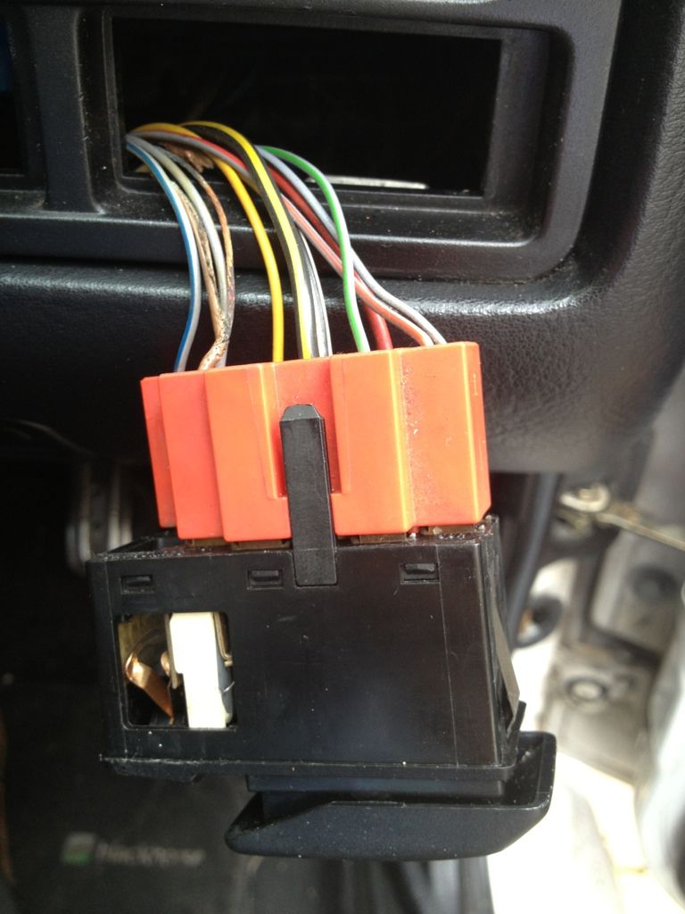

Dangerous melted wires??? :eek: :shrug:

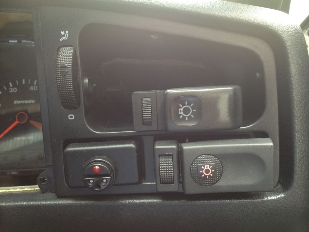

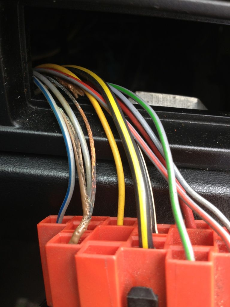

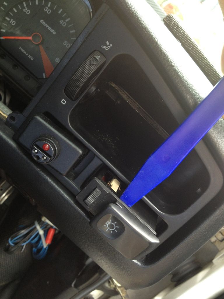

Replaced with new switch for now ...
That's because the current for the lights runs from the battery, through the switch and then onto new lights, resulting in possible internal failures in the switch with age and dim lights. Get the headlight loom upgrade fitted. So much better!
You had a mk2 headlight switch before incase you didn't know.
That brown wire looks like it has melted away leaving bare wire remaining. Get it repaired or at the very least cover the wire in insulation tape, you run the risk of bad things happening if you leave that bare!

Insulation tape for now!
Golf.
Really?!!!
Bloody previous owner(s)! :2gunfire::2gunfire::snipersmile:
Completely melted all the way thru!
Taping up...

And the more i delve into my car ...
Wiring is one of those things you really don't want to look into but really should. How my car never caught fire before I owned it is a miracle!
You can get a single loom that runs between the fuse box and the switch. Easy enough to replace if a little daunting!
Ideally replace with a new loom... eBay should be your friend. From memory it's a short loom with plugs both ends, which you plug in. But bear in mind secondhand looms could be iffy too...
Wayne... If you choose to change the loom... And can't find one at the moment I may have a spare secondhand one, which I bought just In case this ever happened to mine... I don't guarantee the conditions of the wires as it's out of an unknown car to me. But quite happy to let you have it subject to a replacment at some point this summer...
Single loom?
Is that just the brown wire or the whole thing (all wires) ?
I quess he's talking about the whole thing complete orange block and wire, and from memory it runs in to to electrical blokes the other end.

Can i just replace the brown wire?
But i cant trace the other end of the wire from switch :eek:
What else trim/panel do i need to remove that i havent already to trace to fusebox (driver floor fusebox or engine bay)???
If replace brown wire - wouldnt it melt again??? :eek:

hmmmm, looking at that, looks like I have a mk2 golf switch in mine too :scratch:
Same switch, different front just as susceptible to catching fire when the internals break down with age if you have the standard wiring circuit.
I have an uprated loom so no worries there luckily. I can see why people replace them with the golf version, cheap as chips compared to the corrado version.
It runs straight from the switch down over the top of the fusebox iirc Wayne. It's not too difficult if your careful to replace the whole loom. JusJust trace the loom to the block on the fusebox (top right iirc). Slide the fuse block retaining bar across, pull out block and remove. Refitting is reverse of removal mate. Well worth doing judging by the state of that cable!
