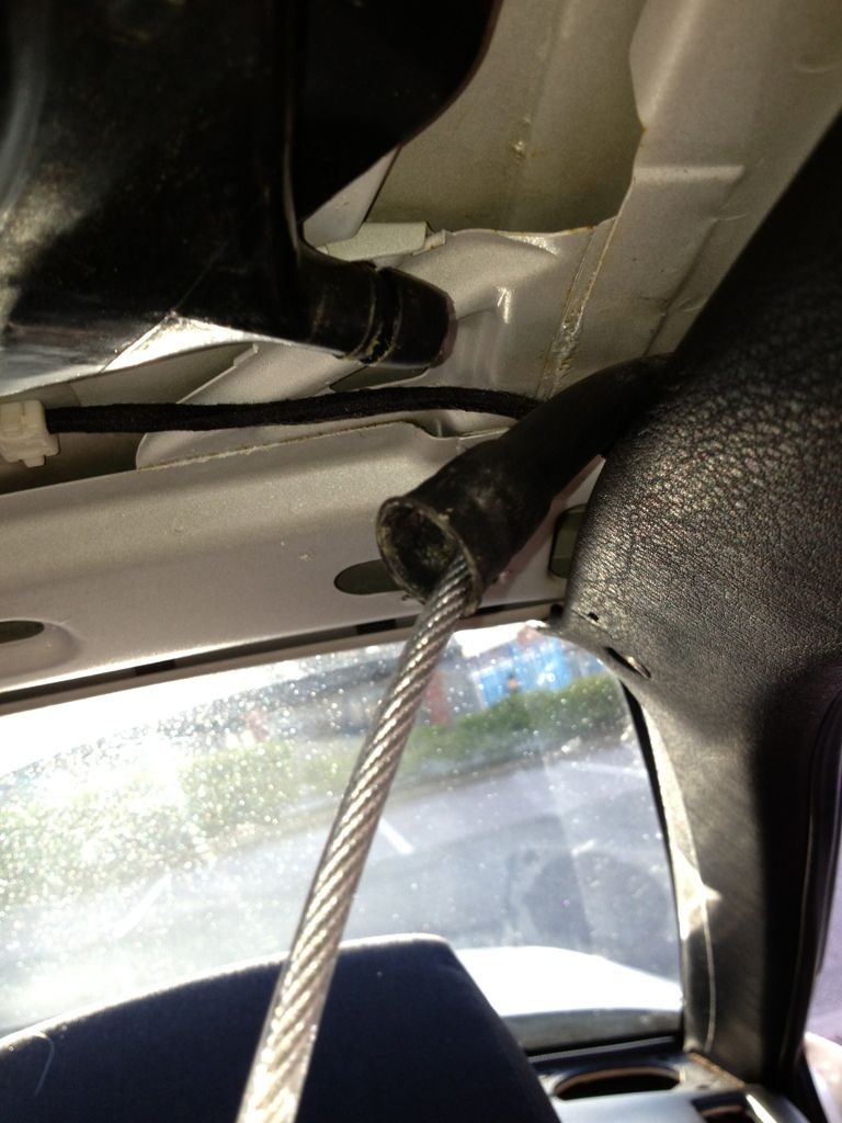

How did you tell the tube are clear all the way down, blow down them?
I will have to, if that steel cable not go all the way! Grrrr
Happy guys?

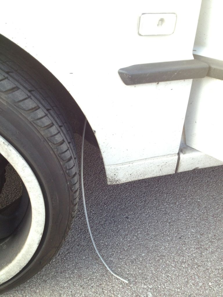

About 2m pushed thru the front:
1.5metres for rear

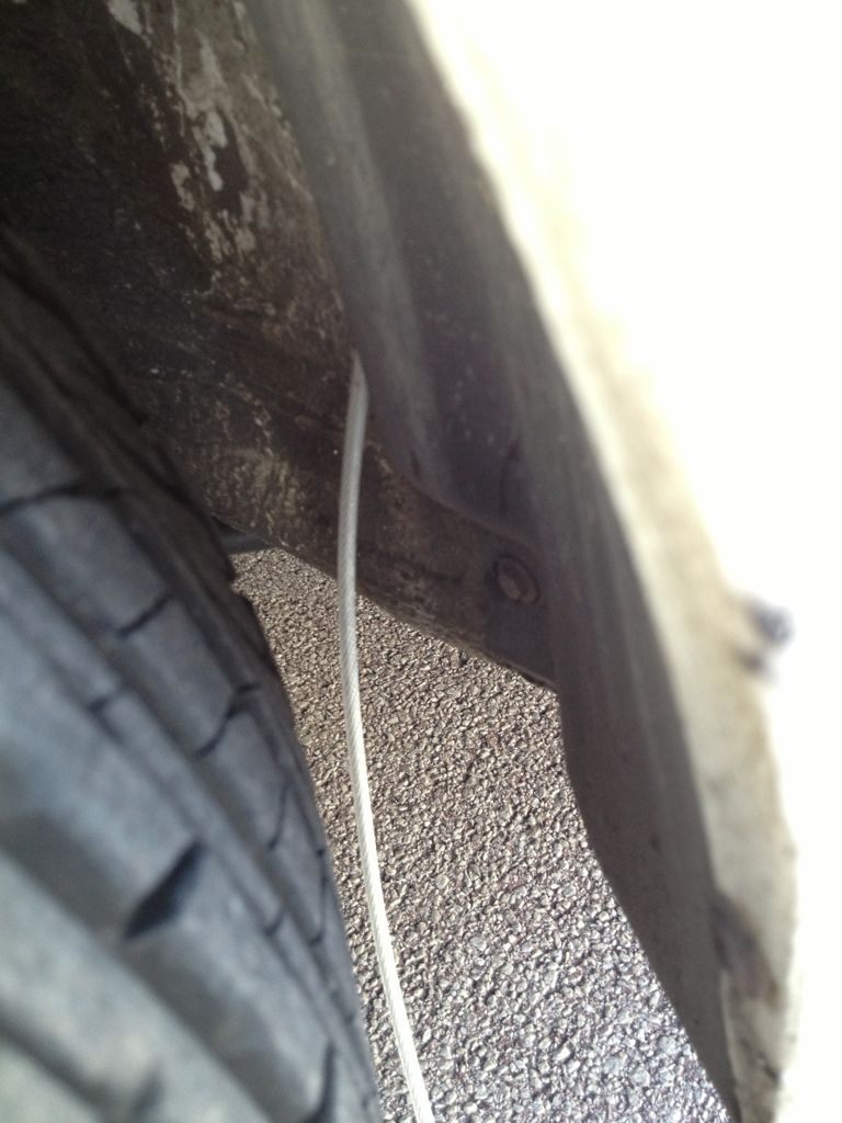

But only passenget front cable pushed thru
The other 3 couldnt find its way out past the wheel arches :(
Thouh they all came out with a CLEAN cable
