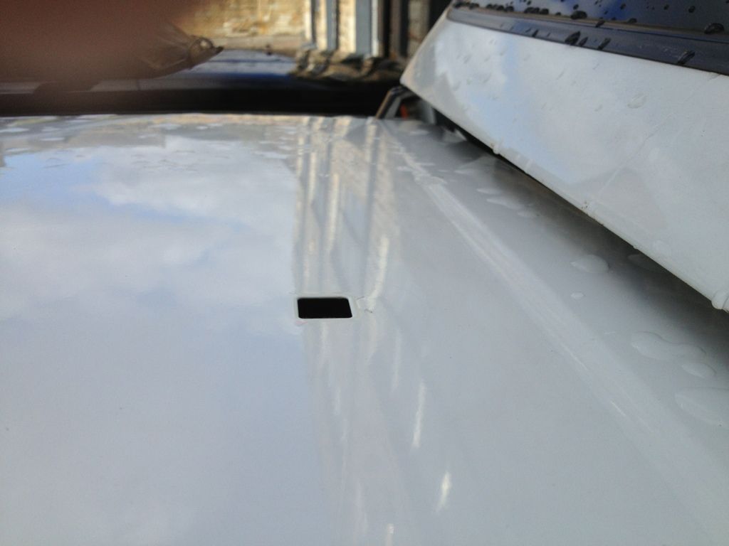

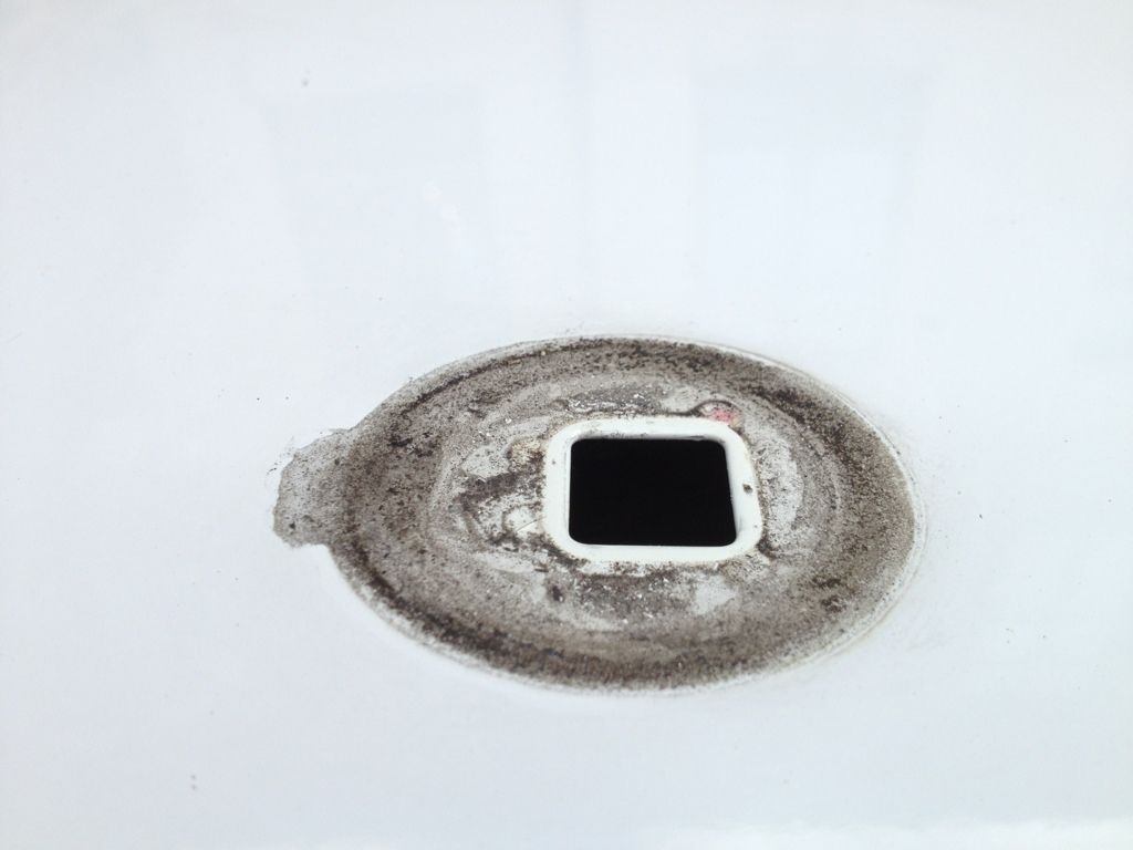

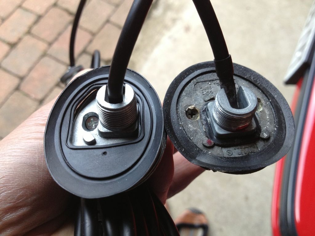

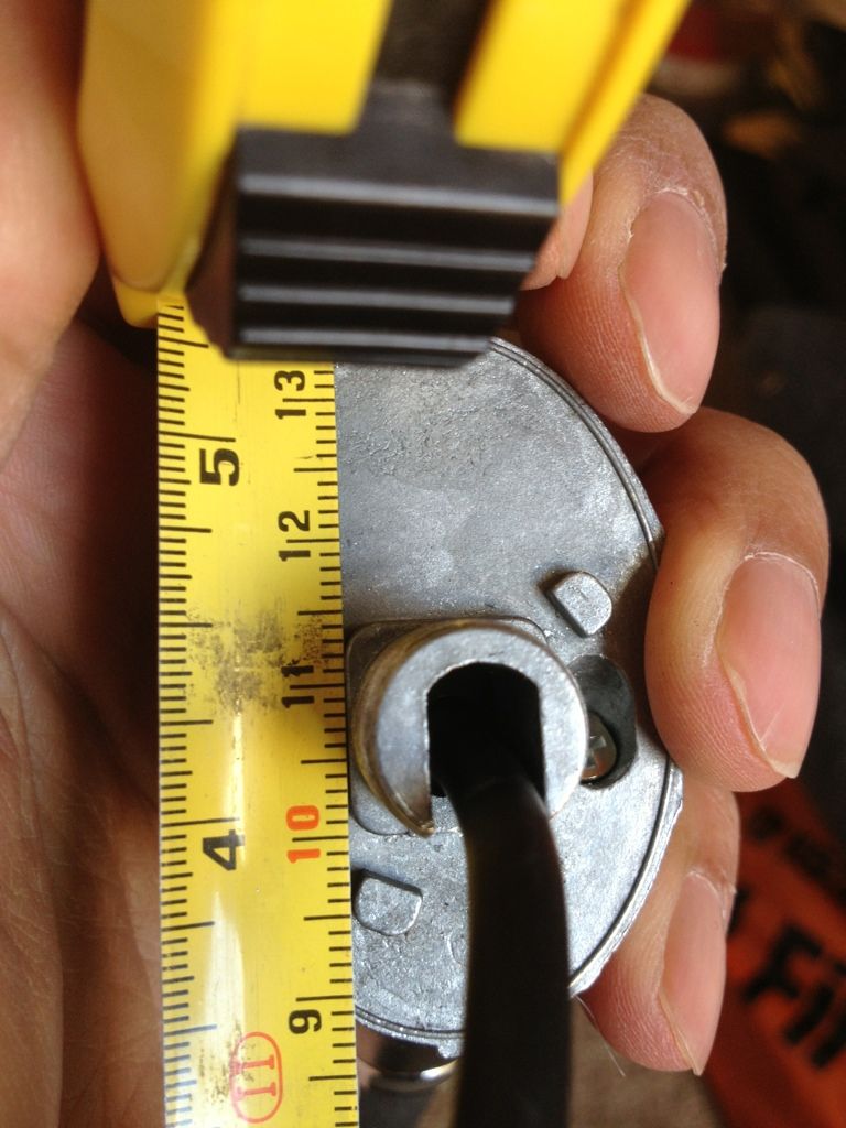

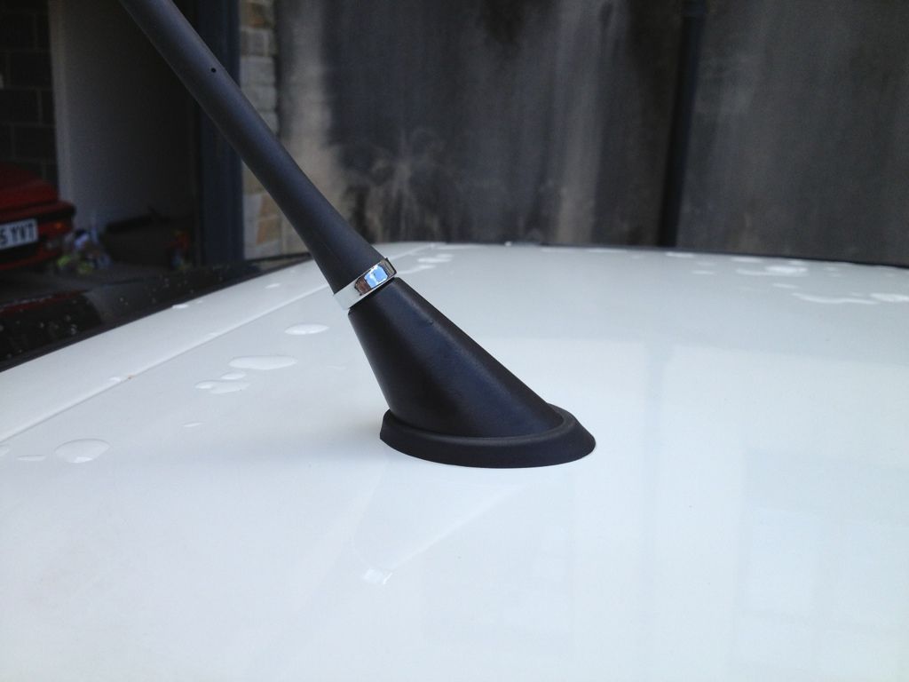

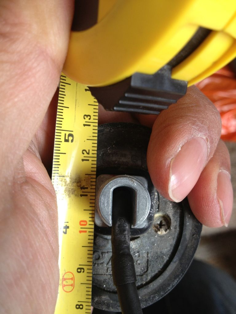

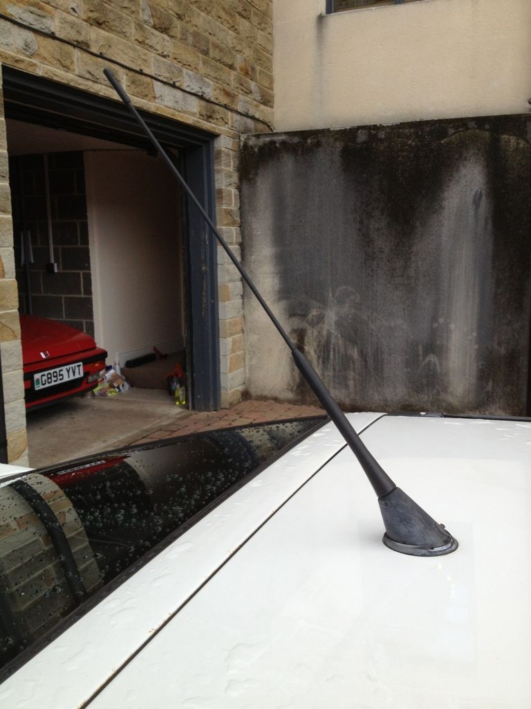

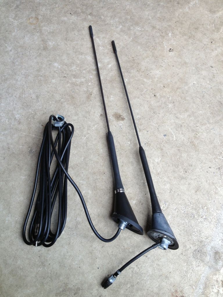

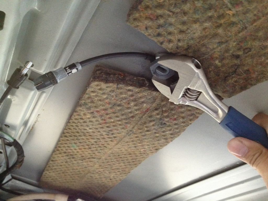

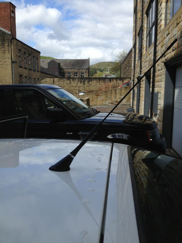

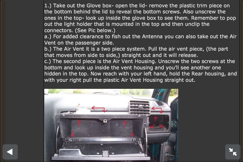

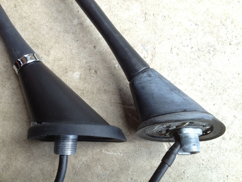

Wayne2015 10 Posted May 4, 2015 Another excellent write-up from our friends across the Atlantic again :thumbleft: http://www.corrado-club.ca/forum/viewtopic.php?t=9452 Might give it a go! :D DONE! Before After Complete aerial from VeeDubMachine £15+pp (Short aerial alone optional) OLD aerial (not sure OEM? :shrug: ) Is shorter than NEW aerial Slightly different shape And base SQUARE connection is 1mm bigger than NEW aerial OLD 15mm NEW 14mm Quote Share this post Link to post Share on other sites

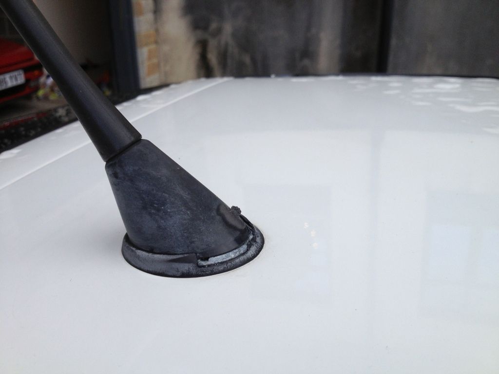

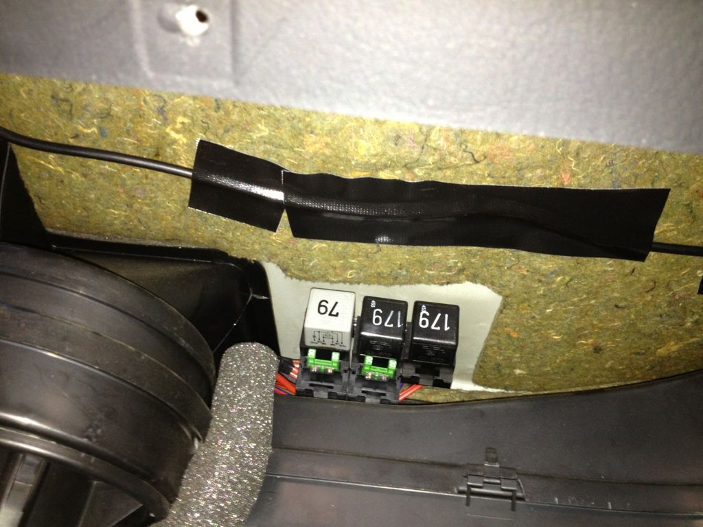

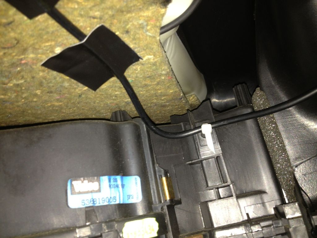

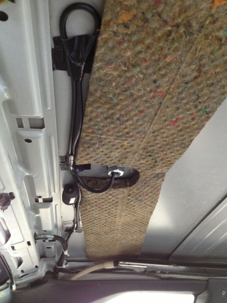

Wayne2015 10 Posted May 4, 2015 (edited) Duct tape Cable ties And LOTS and LOTS of sealant under base of aerial! :lol: I am leaving OLD aerial cable behind as a: 1. Backup 2. If future want to re-instate (as got in-line amplifier - NEW aerial no amplifier) NEW cable follows OLD cable route ... NEW plug on left (no amplifier) OLD plug on right with in-line amplifier (and WHITE cable to amplifier is POWER cable - i assume) All works fine :thumbleft: :dance: :lol: Edited May 4, 2015 by Wayne2015 Quote Share this post Link to post Share on other sites

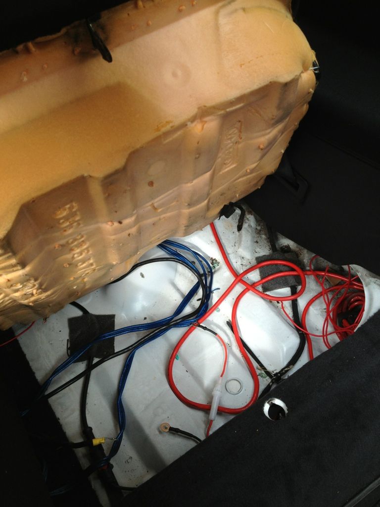

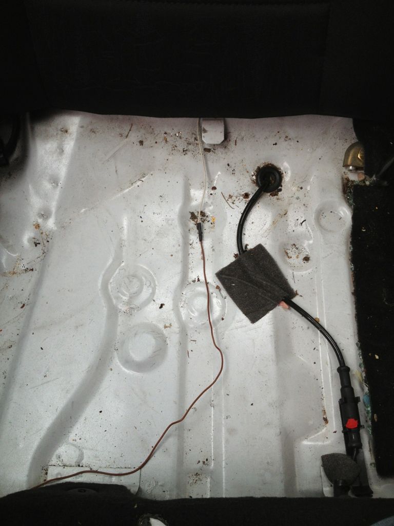

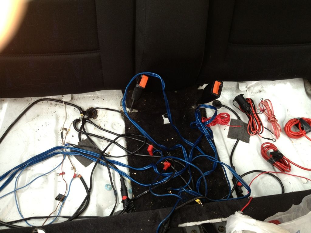

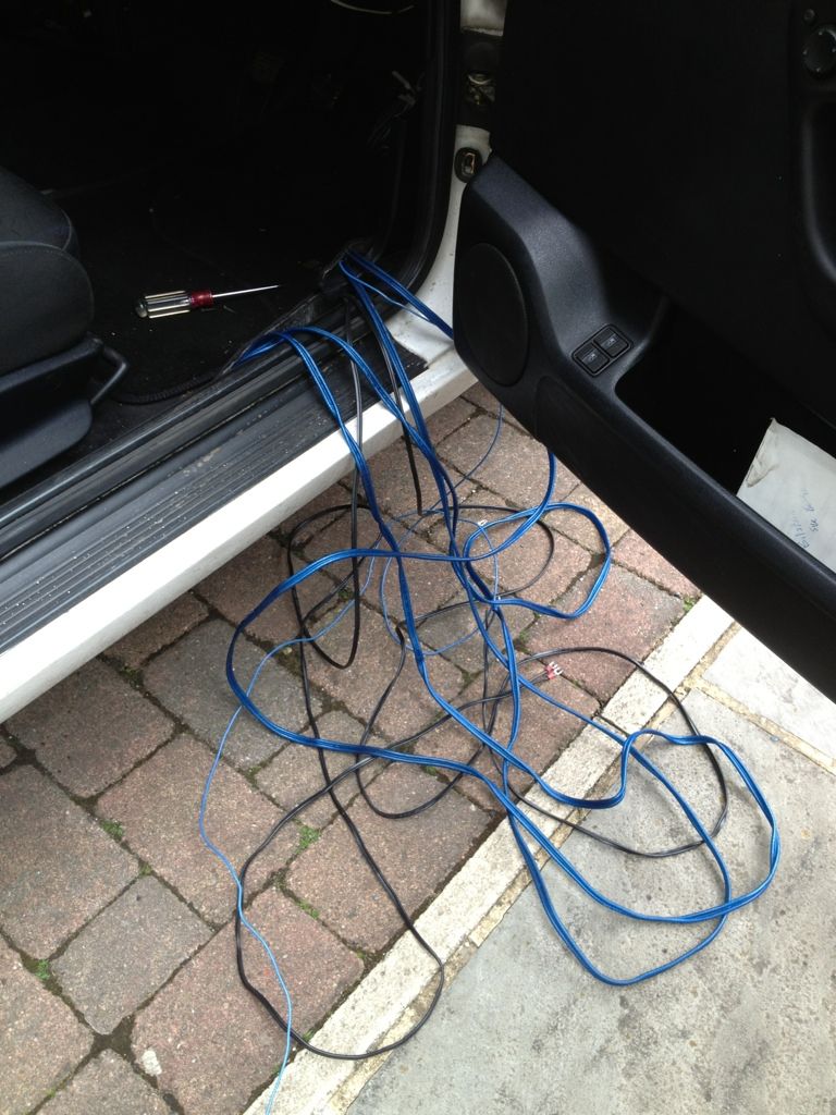

Wayne2015 10 Posted May 4, 2015 Well Couldnt wait any longer Was a good dry sunny Bank Hols ... Sod it, If I gona get electrocuted - so be it! :eek: :shocked!: Its NOT that bad! Oh YES IT IS! :shocked!: :shocked!: :shocked!: 1st remove aftermarket rear speakers cables (not working) Cables after cables (behind driver) Remove from front Rear now BETTER *** but what are the 2 BLACK IN LINE FUSE HOLDERS(?) with red dots???*** And the BROWN wire??? Quote Share this post Link to post Share on other sites
ChrisL 20 Posted May 4, 2015 Not inline fuses Wayne, they are the connections for the rear abs sensors! Quote Share this post Link to post Share on other sites
Sean_Jaymo 0 Posted May 4, 2015 The red dot items are the plugs for the rear abs sensors and I'd hazard a guess that the brown wire is for the alarm. Quote Share this post Link to post Share on other sites

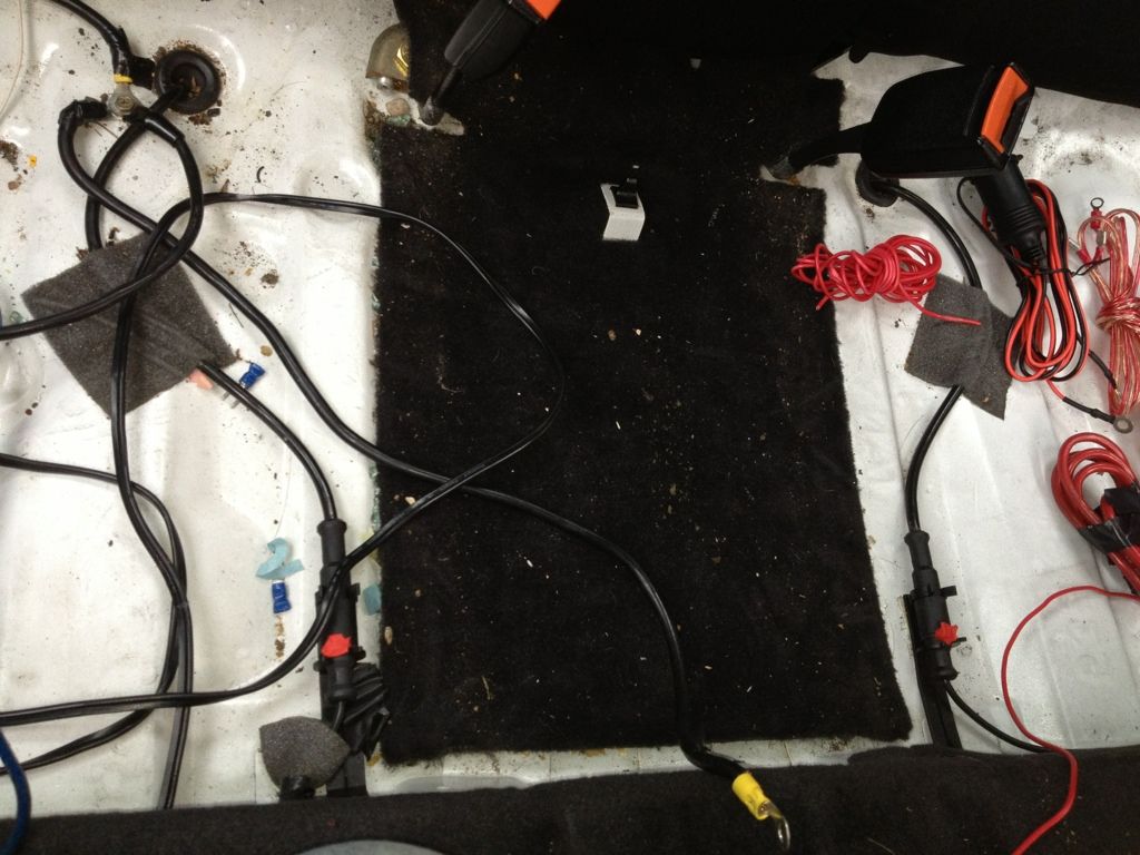

Wayne2015 10 Posted May 4, 2015 Question Questions QUESTIONS!!! :shrug: Under rear seats with speaker cables Found the MISSING bolt for rear seat (bum) On other side this is where bolt is So How in earth do i put this side bolt in (allen key head too)! :bonk: Quote Share this post Link to post Share on other sites
Wayne2015 10 Posted May 4, 2015 Not inline fuses Wayne, they are the connections for the rear abs sensors! :eek: Thanks Chris (I will NOT touch em then!) :thumbleft: Quote Share this post Link to post Share on other sites
Wayne2015 10 Posted May 4, 2015 The red dot items are the plugs for the rear abs sensors and I'd hazard a guess that the brown wire is for the alarm. Cheers Sean! Not managed to trace either end of the BROWN wire - so will leave ... Quote Share this post Link to post Share on other sites
Sean_Jaymo 0 Posted May 4, 2015 If it were the alarm wire, I'd say it's going to the boot light. Aftermarket alarms normally use an internal light as a trigger that a door is open. Quote Share this post Link to post Share on other sites
Wayne2015 10 Posted May 4, 2015 If it were the alarm wire, I'd say it's going to the boot light. Aftermarket alarms normally use an internal light as a trigger that a door is open. Cheers Sean! I ll trace those wires below at some point then! Quote Share this post Link to post Share on other sites
MZpog 10 Posted May 5, 2015 Question Questions QUESTIONS!!! :shrug: Under rear seats with speaker cables 12v power socket for mobile, sat nav or as in rear probably Nintendo's. Quote Share this post Link to post Share on other sites
Wayne2015 10 Posted May 5, 2015 12v power socket for mobile, sat nav or as in rear probably Nintendo's. :thumbleft: Quote Share this post Link to post Share on other sites

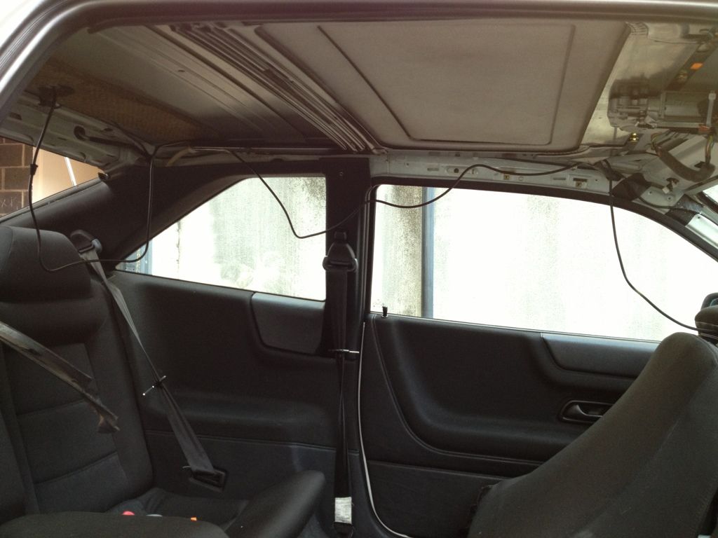

Wayne2015 10 Posted May 5, 2015 Rained overnight ... The sunroof leaks this morning :( :( :( From driver drain tube... From driver rear drain tube... Is it safe to disconnect the drain tubes (attached to sunroof), Pull it off and poke a coat hanger in??? Will anything break by taking it off? Or it s supposed to leak? Lots of rain - but i wouldnt say its heavy ...:shrug: Well Remember my only leak was when i wash car And the back of sunroof leak? I think its there thats leaking in during heavy rain. TAPED back of sunroof and no leak for 2 HEAVY rain days! Quote Share this post Link to post Share on other sites

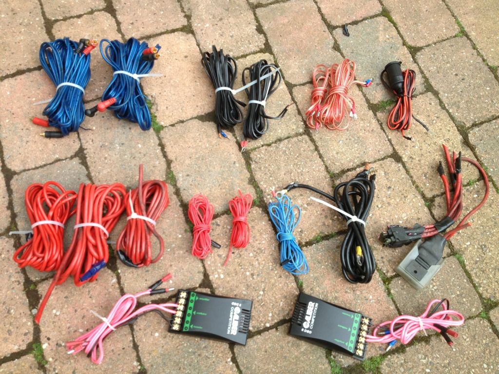

Wayne2015 10 Posted May 5, 2015 BEFORE AFTER *** just one BLUE/WHITE wire unsure *** Quote Share this post Link to post Share on other sites
MZpog 10 Posted May 5, 2015 BEFORE AFTER *** just one BLUE/WHITE wire unsure *** Blue/white is for the speed sensing radio that would up the volume when going faster. Connecting this to anything is likely to stop your spoiler working. Quote Share this post Link to post Share on other sites
Wayne2015 10 Posted May 5, 2015 (edited) BEFORE A mess! And that WHITE twin wire (from stereo IGNITION to behind dash to fuse box) Also same WHITE twin wire attached to RED thin wire to rear seats THICK RED cables for rear speakers... WHITE twin wire goes to RED wire to STEREO IGNITION :shocked!: One WHITE wire cut here :eek: Other WHITE wire cut here : WHITE twin wires removed and wires behind stereo tidied up :clap: :dance: :lol: Edited May 5, 2015 by Wayne2015 Quote Share this post Link to post Share on other sites
Wayne2015 10 Posted May 5, 2015 Blue/white is for the speed sensing radio that would up the volume when going faster. Connecting this to anything is likely to stop your spoiler working. Thanks for the heads-up, Stuart! :clap: Quote Share this post Link to post Share on other sites
