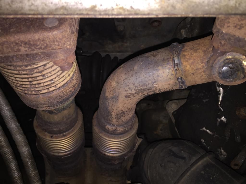

I have heard this as well, don't know of anyone doing off the shelf manifolds but I've been quoted £225 from a place near grimsby for a custom one. I've bodged one together myself for the time being just to get it through MOT then I'll be heading there to get a nice shiny one made. I'll have a word to see if he fancies making a jig for others but won't be for a while (April time)
You can use the old vr6 down pipe with an bit of pipe welded mind the extra flexi as mine is temporary too

I used mk5 r32 manifold, bit of pipe I had kicking about and vr downpipe. Picture in my build thread. Mk4/tt manifolds point downwards, mk5/a3 are more like the vr. United motorsport one doesn't fit mk5 type
