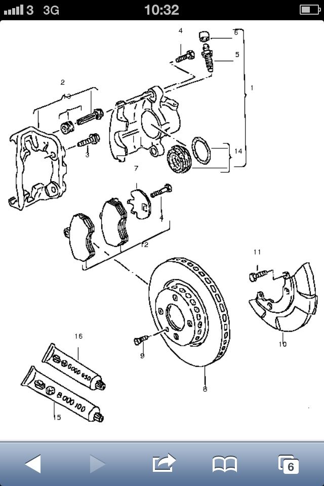

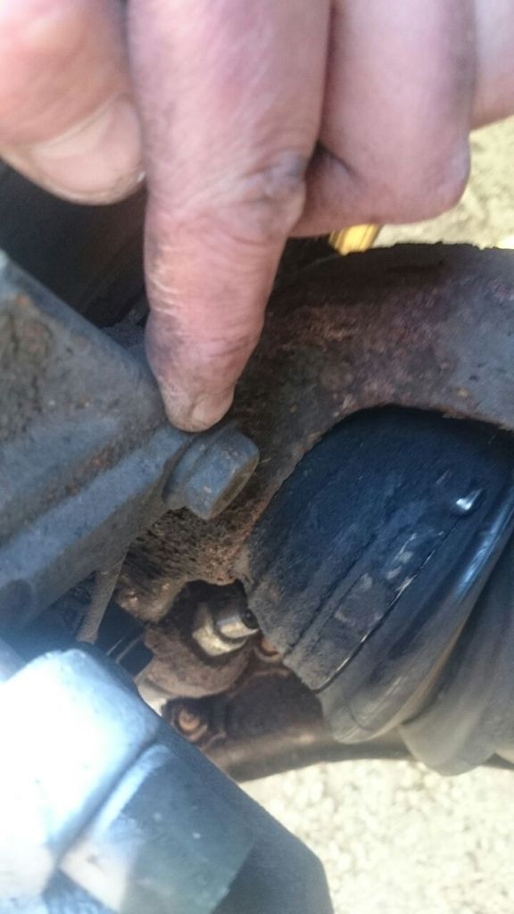

Wayne2015 10 Posted March 10, 2015 No car :( U need me to go to garage and measure? Thanks to Seanl82 :) This is the front caliper carrier bolts: There s no way i can get them delivered in time now :( I ll have a quick check with VW this lunch (as i picking up the GREEN stuff from them anyway ;) Else CHRIS - can u get em by Sunday (need 4)??? Quote Share this post Link to post Share on other sites

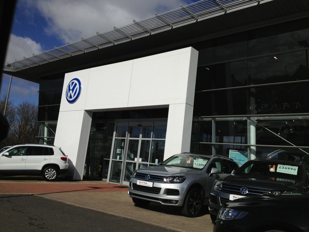

Wayne2015 10 Posted March 10, 2015 Will also check with VW if they do shelf straps. Is it Lupo shelf straps that fit? If not will order from VeeDubMachine ... Quote Share this post Link to post Share on other sites

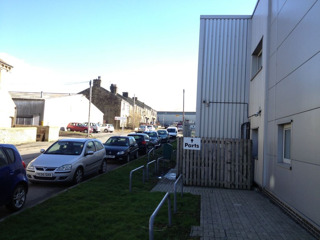

Wayne2015 10 Posted March 10, 2015 No luck with bolts nor parcel shelf straps at VW :( Look at the GRAND entrance for car customers ... And the not-so back street/alley entrance for parts - eeek! Quote Share this post Link to post Share on other sites

Wayne2015 10 Posted March 10, 2015 No luck with bolts nor parcel shelf straps at VW :( Look at the GRAND entrance for car customers ... And the not-so back street/alley entrance for parts - eeek! have a search on here, think people buy parcel shelf straps from ebay and they are from a seat which are exactly the same only about £3 each. edit.... done your search for you http://the-corrado.net/showthread.php?t=89630&highlight=seat+parcel+shelf+straps Damn! I read that thread - but kept thinking it was a Polo (not Seat)! Thanks - will compare ebay prices with VeeDub :) Quote Share this post Link to post Share on other sites
Hairyarse 10 Posted March 10, 2015 (edited) That's a dodgy back entrance Wayne!! LOL veedubmachine do parcel shelf straps Edited March 10, 2015 by Hairyarse Quote Share this post Link to post Share on other sites

Chuggs1 10 Posted March 10, 2015 That's similar to the VW stealer in Swindon - big posh entrance for new cars and side entrance down the side for parts that's a bit dingy! Obviously like banks don't care much about you once they have you lol! Quote Share this post Link to post Share on other sites

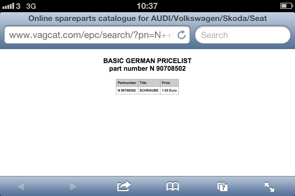

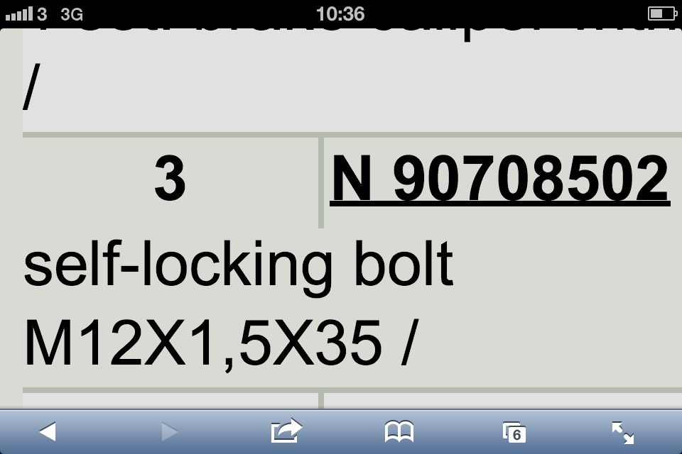

Wayne2015 10 Posted March 10, 2015 Thanks to Seanl82 :) This is the front caliper carrier bolts: There s no way i can get them delivered in time now :( I ll have a quick check with VW this lunch (as i picking up the GREEN stuff from them anyway ;) Else CHRIS - can u get em by Sunday (need 4)??? Sean! Definite N90708502 (no 3 in diagram)? Need 4 of them? Thanks!!! Quote Share this post Link to post Share on other sites
seanl82 23 Posted March 10, 2015 Yes, and yes mate. :thumbleft: Quote Share this post Link to post Share on other sites
Wayne2015 10 Posted March 10, 2015 Yes, and yes mate. :thumbleft: Thanks Sean! Ordered! x4 just under £15. Pickup Thursday :) PS: Part number N90708502 - now replaced with N90708504 (due to new supplier) Quote Share this post Link to post Share on other sites
VAG-hag 0 Posted March 10, 2015 those exploded diagrams are on vagcat... the link I sent you mate :D Quote Share this post Link to post Share on other sites
