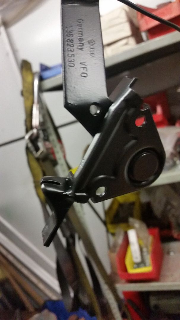

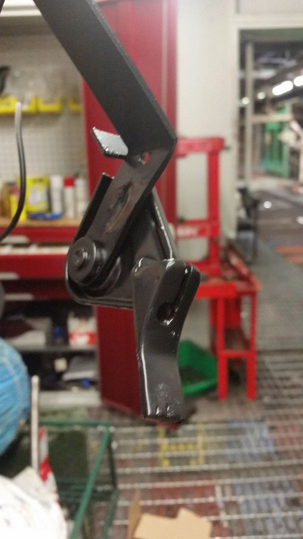

KeVR 10 Posted April 3, 2015 I bought a second hand set up but looked at it and opted to modify the original and do away with the poxy spring steel clip: Here it is, knocked it up quickly on my dinner at graft, fitted it yesterday and it works spot on. Might not look OEM but who the hell sees it anyway, fully functional and not likely to break any time soon. Quote Share this post Link to post Share on other sites
