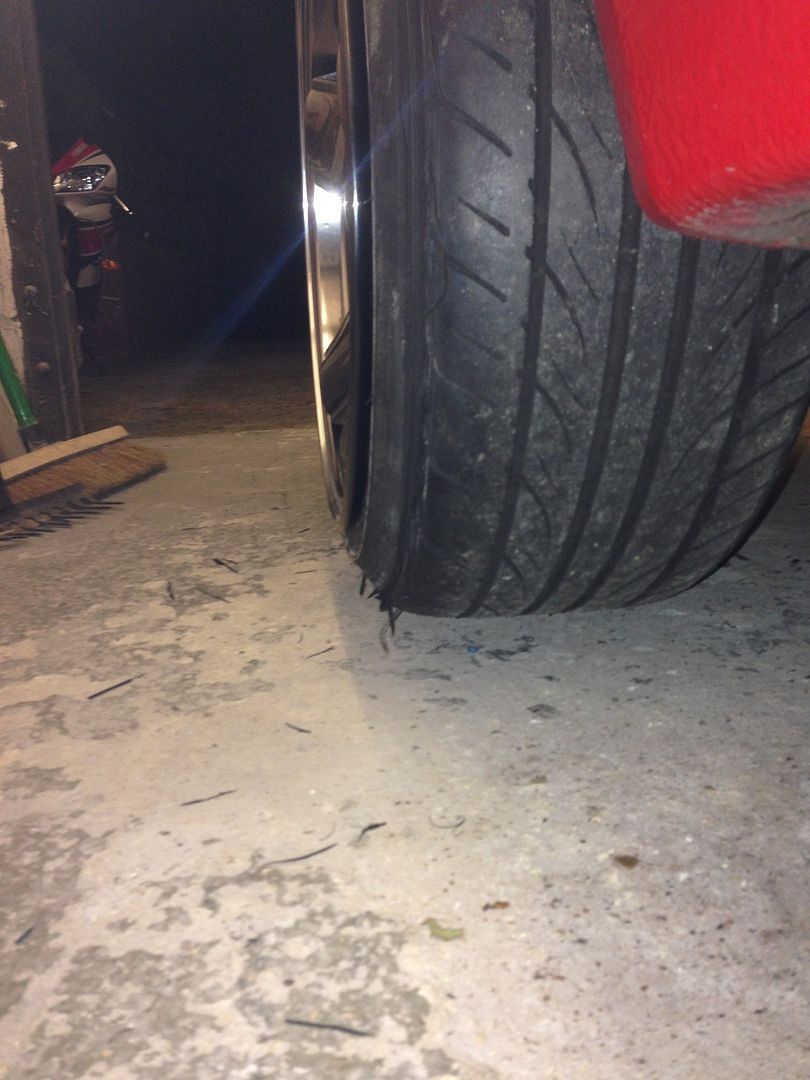

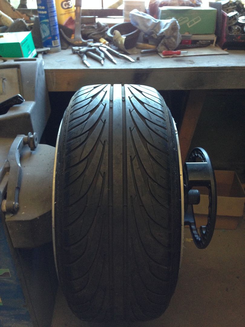

I had to get these on ASAP as there was a show coming up so I order some coilovers and fitted them as quick as possible, the first test with the wheels and suspension did not go to plan!!!!! I pretty much destroyed my rear tyres within a mile.
luckly they were part worns, so I raised her up slightly and we were away. there was still a bit of rubbing after realising the arches were the most solid thing ive ever layed my eyes on I decided to fit some camber shims to temporarily get over this problem. it did the job and gave her a nice stance.

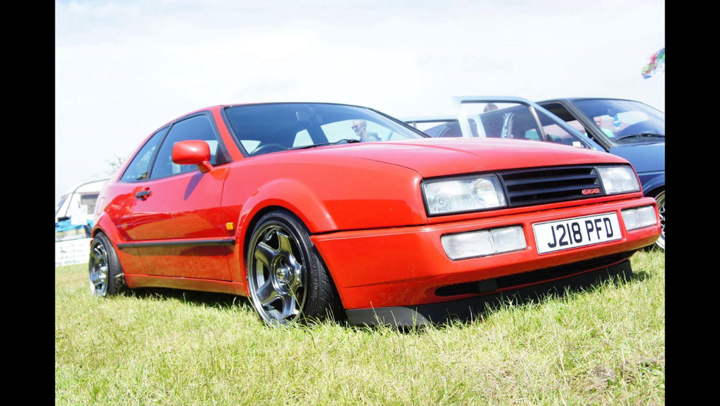

so these are a few pics from the summer shows I attended.

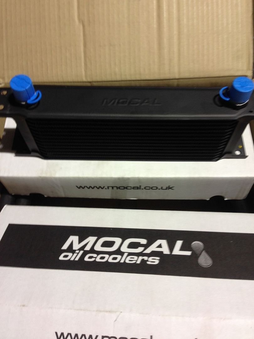

oil cooler

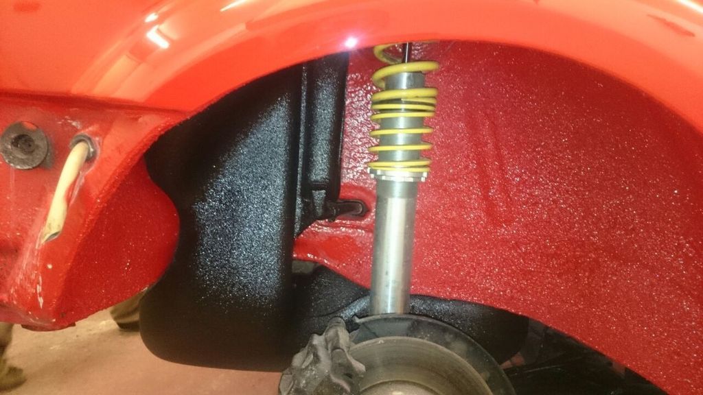

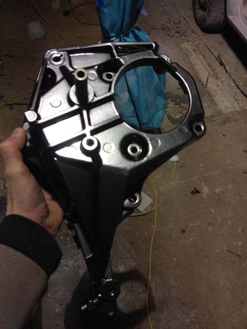

powder coat various components

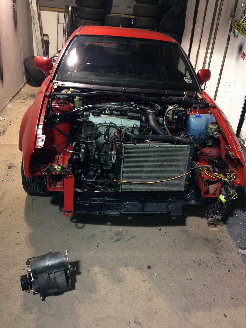

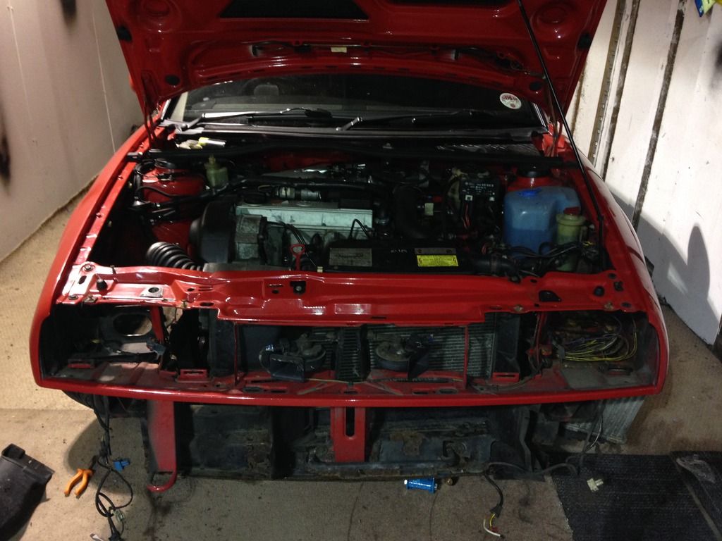

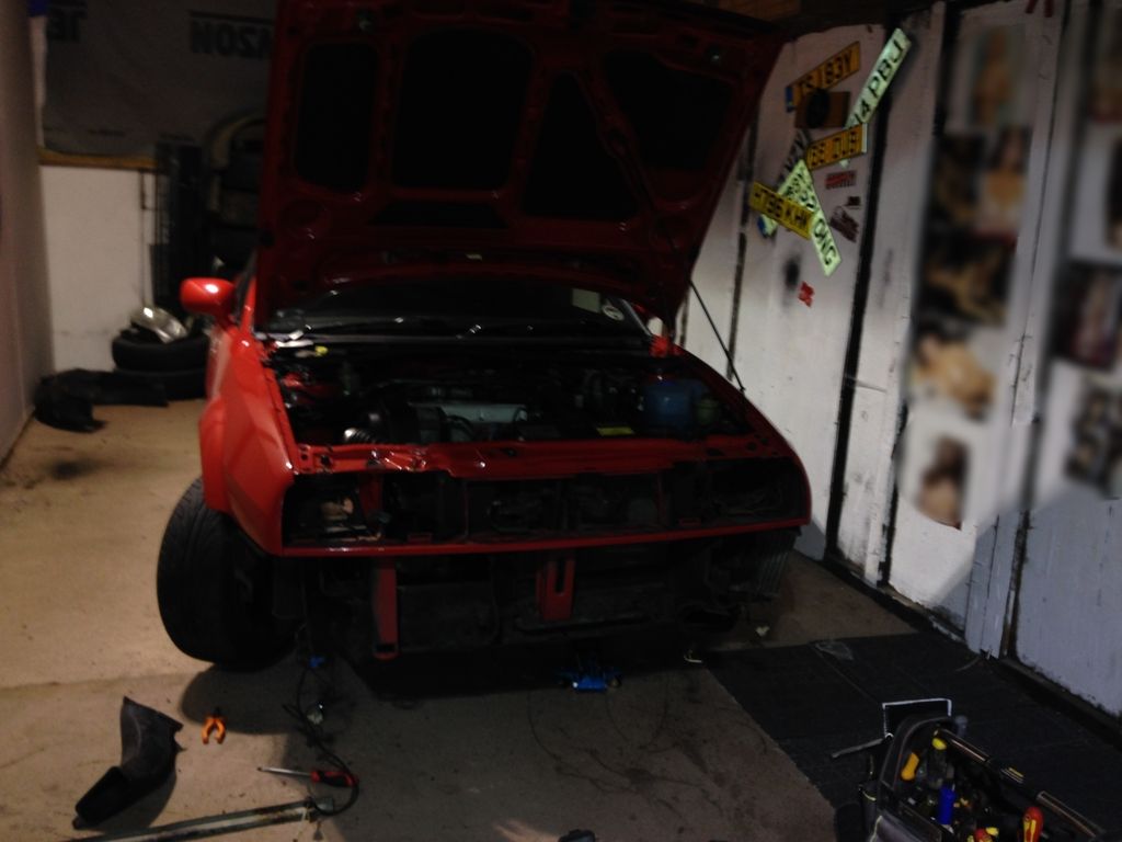

various pics of her being stripped down

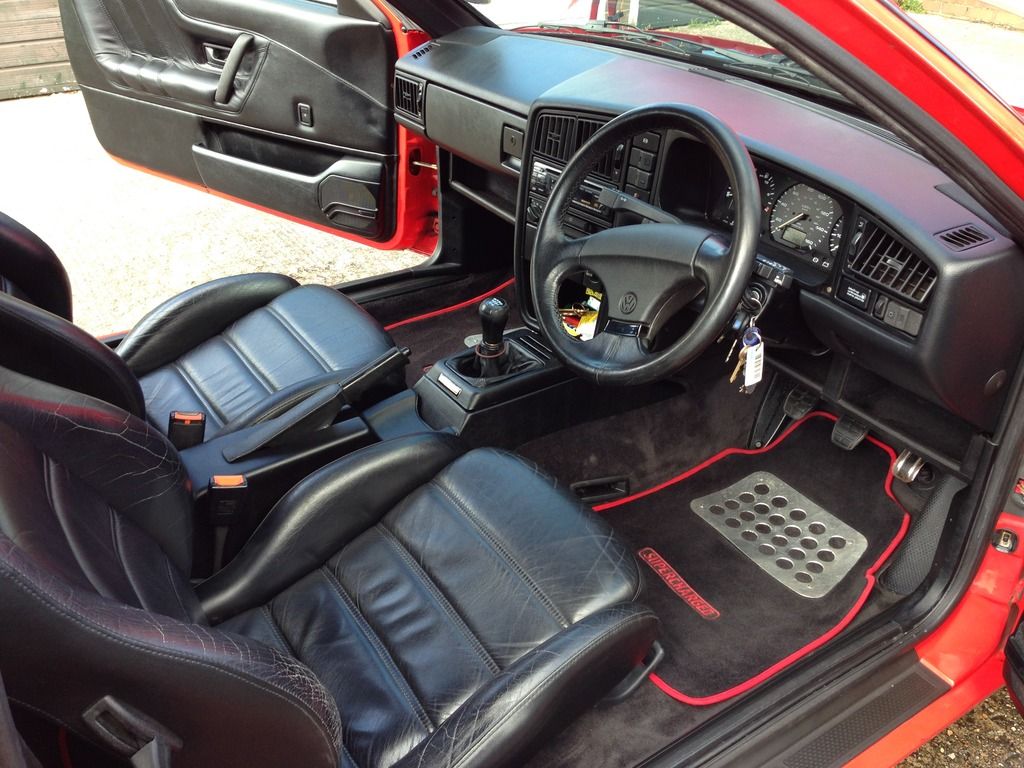

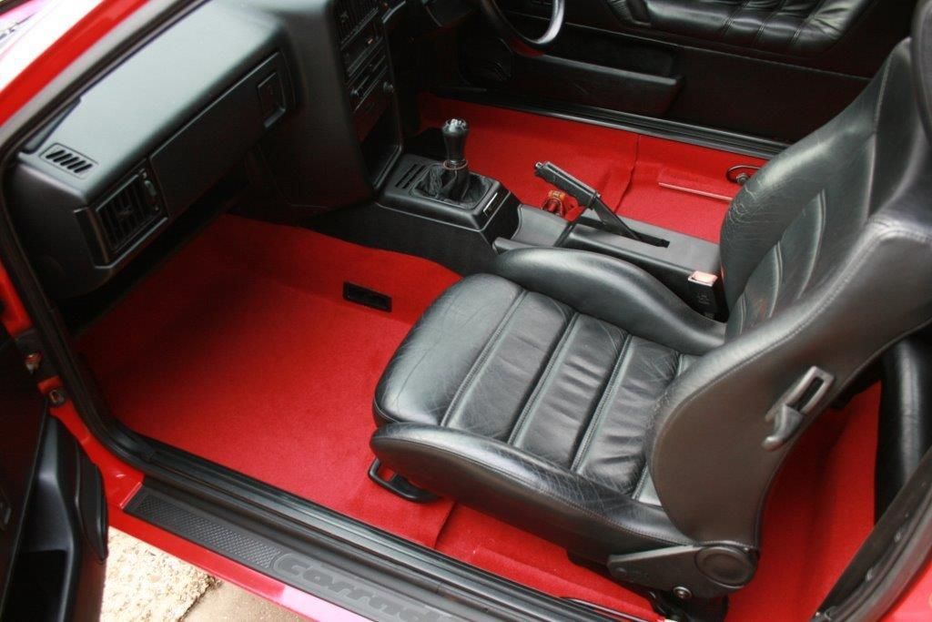

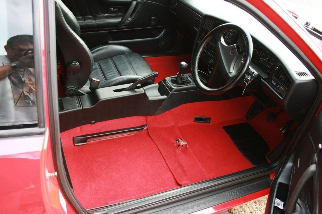

in the prosses I started talking to anna from heritage about a new carpet she was making so I decided to go for it and sent it away for the work to be done. they did a cracking job (I didn't have red that was just them trying it out)
The mats have been binned too ;)

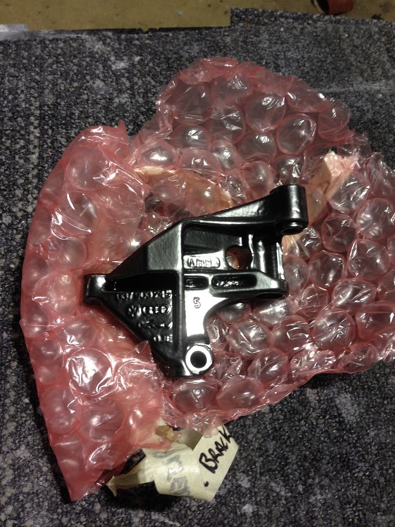

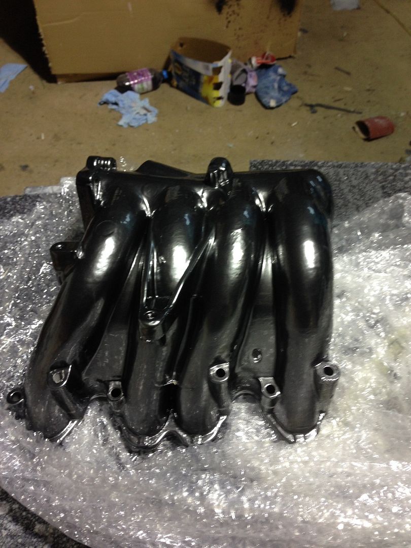

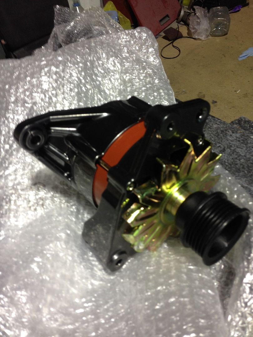

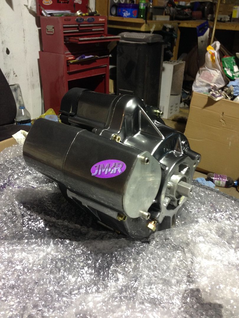

next it was time to concerntrate on the engine so I got in contact with John at JMR, I sent all my parts away to him to be worked on and the end result he pulled out was amazing. it was better than Christmas opening up the return delivery!! :)
That's some serious work there. Craciking example. Makes mine look like it's just been dragged out a river.
It's been a lot of hard work, it's nice to start seeing the end. There was times when I never thought it would be back together. Can't wait to get it back on the road :-)

Amazing C you have, looks fantastic sitting on those rims... Loving the red carpet.
Cheers, yeah the red carpet did look good. Just wasn't my style, the carpet they put in does look spot on though!

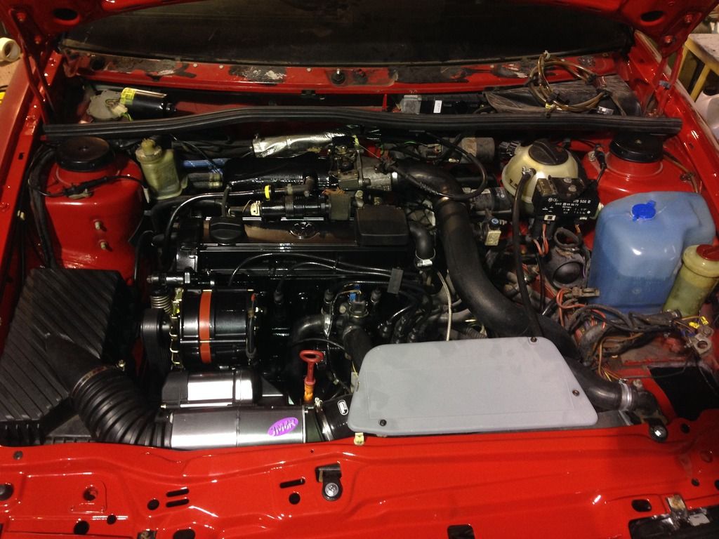

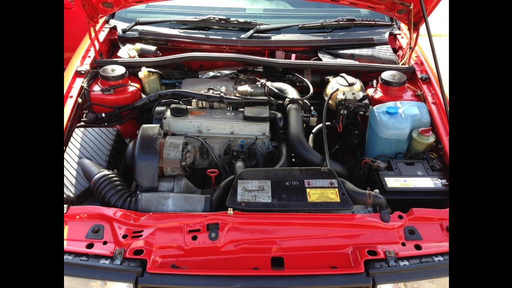

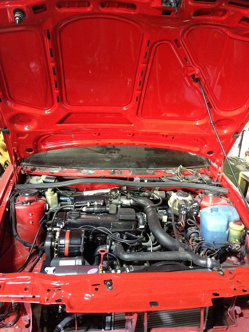

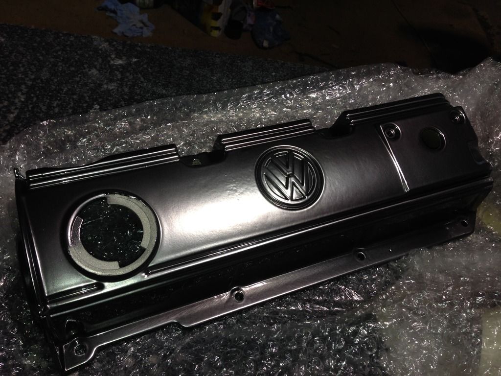

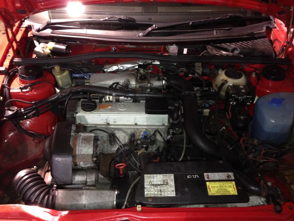

Thought I would put up a quick before and after as the engine is pretty much there now!
Before
After (the cover is going back to black)

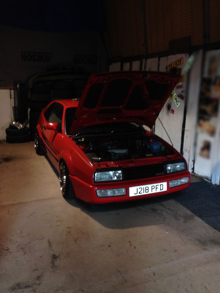

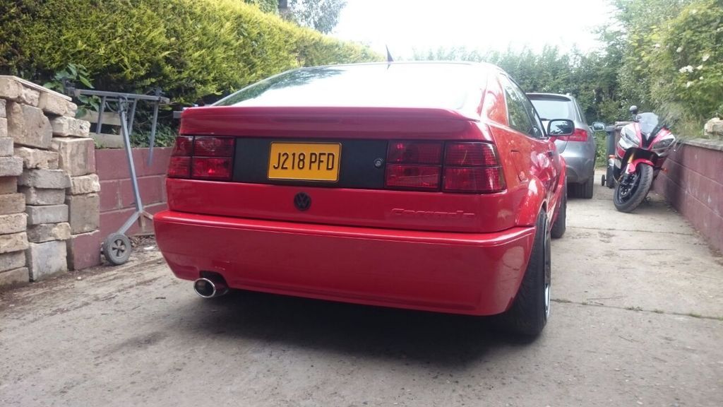

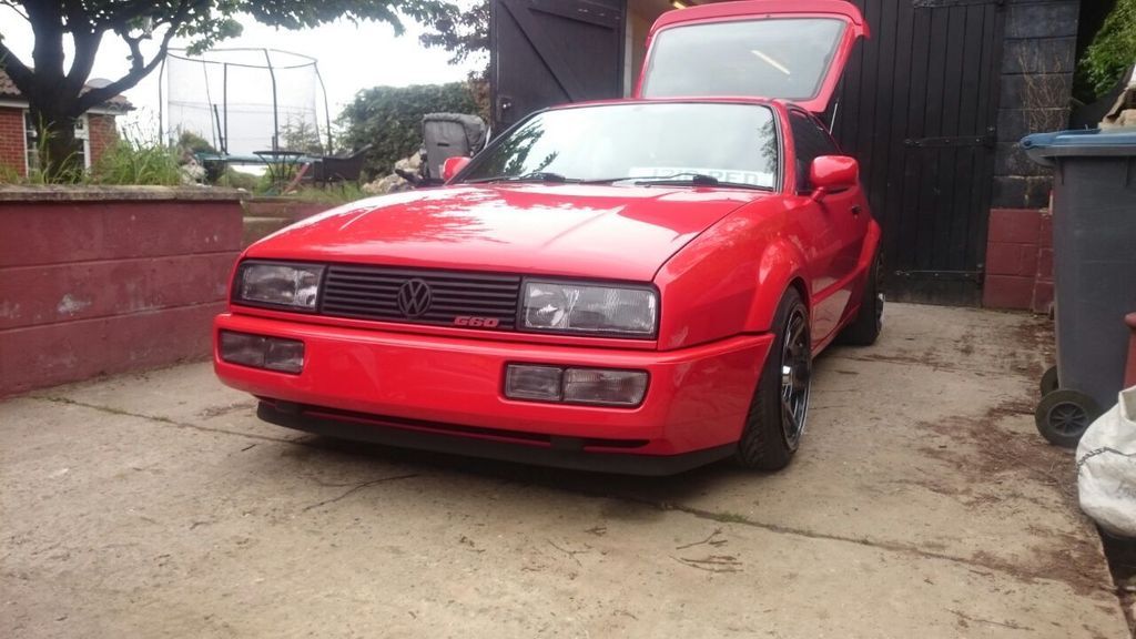

Thought it was time for an update as ive finally got her finished and back on the road after a lot of late nights and hard work.
Heres some pics

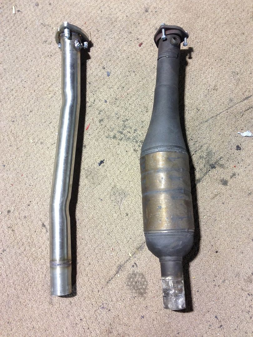

custom de-cat

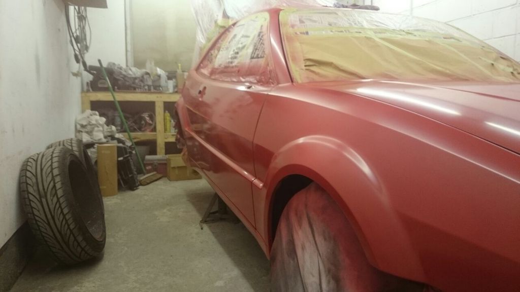

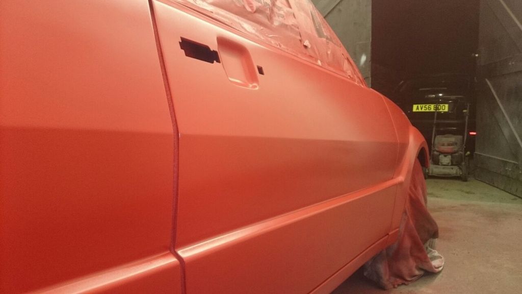

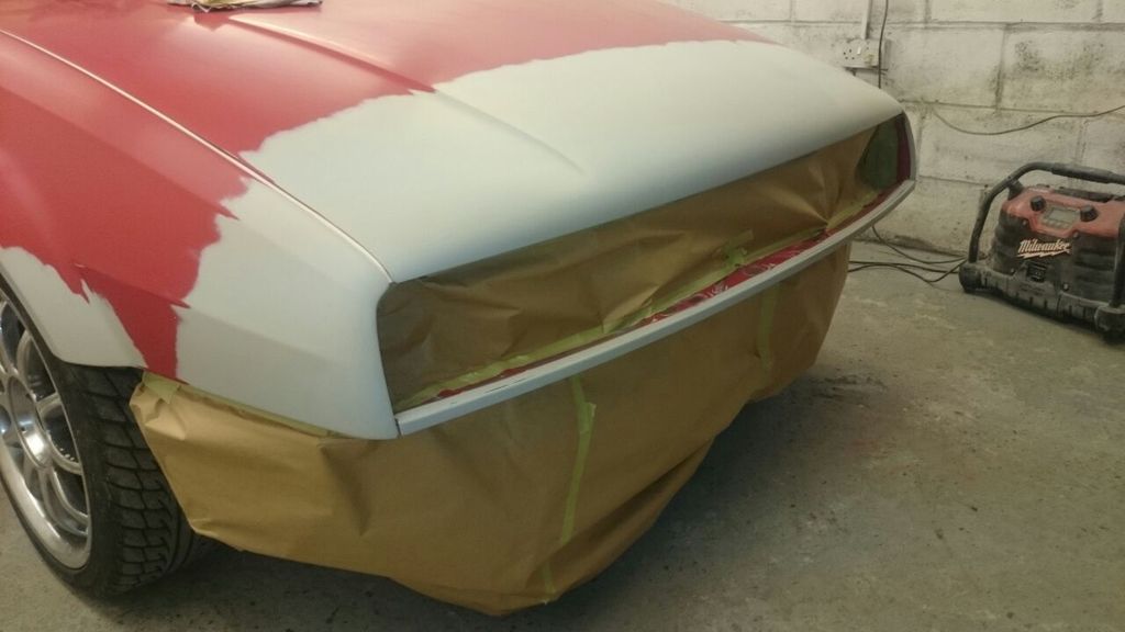

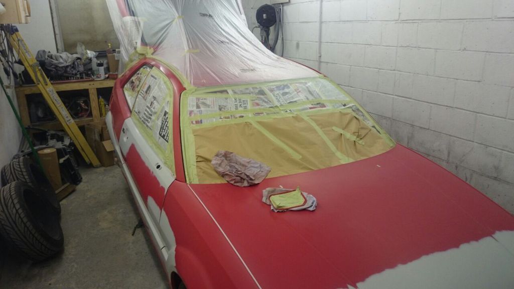

Prepped for paint

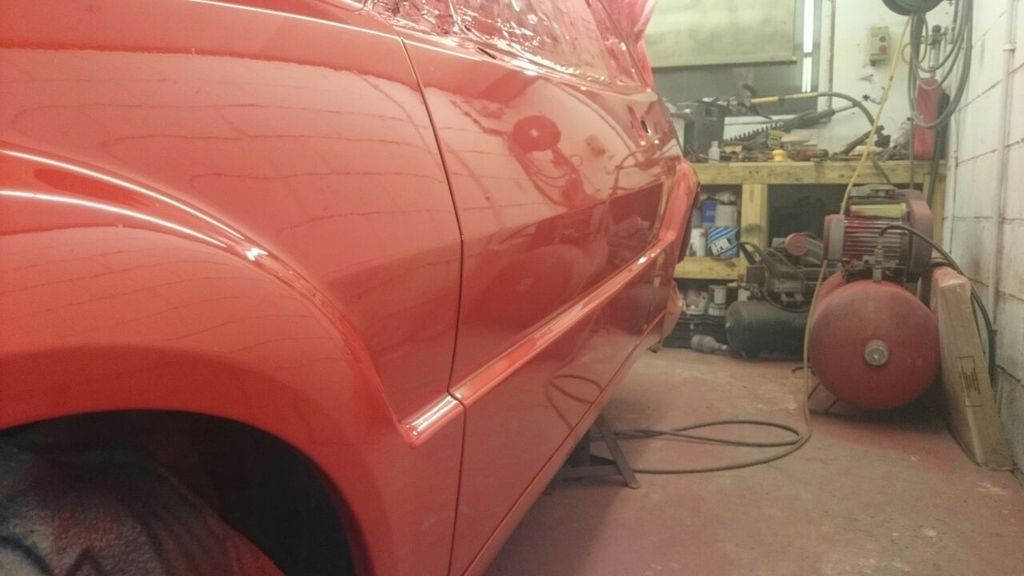

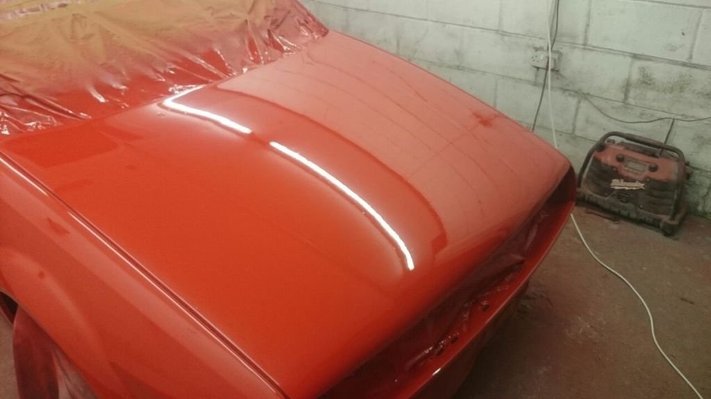

base coat

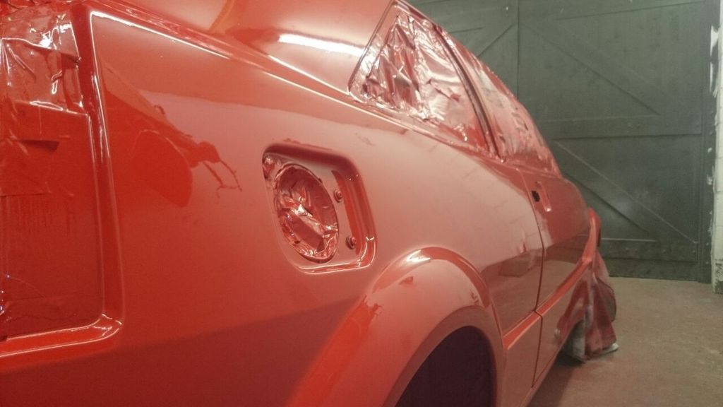

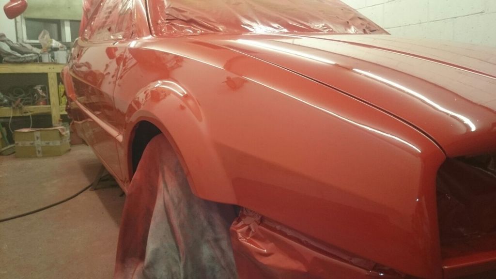

lacquered

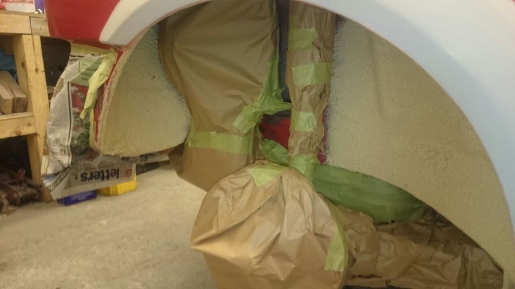

rear arches painted and crackle blacked

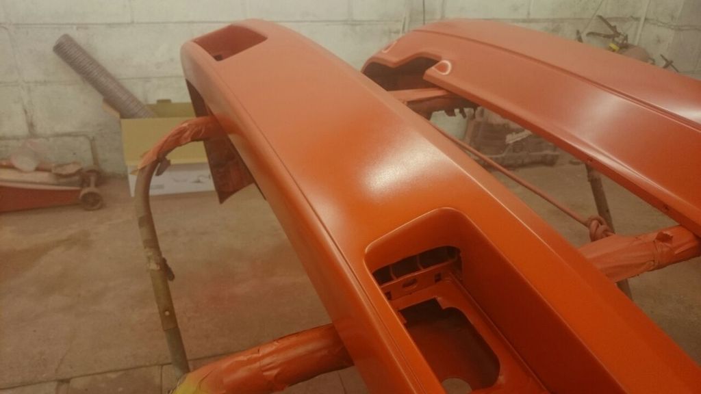

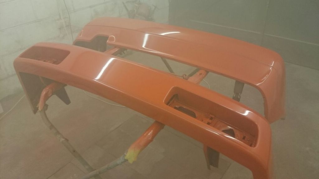

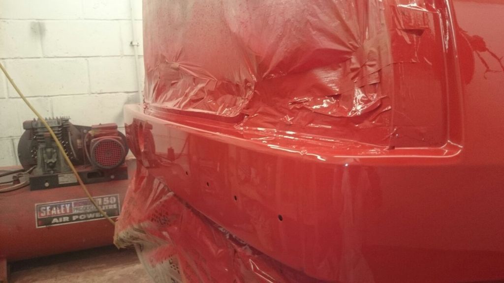

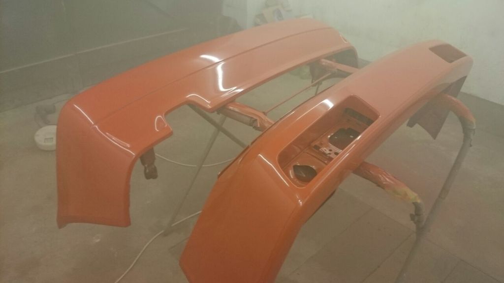

bumpers smoothed and painted
bumpers back on

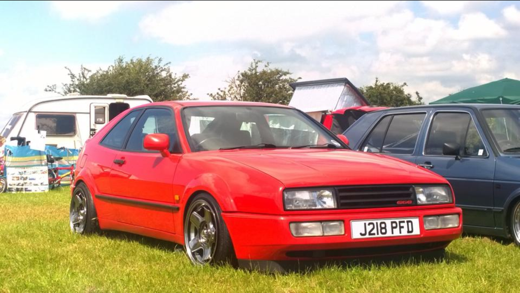

show time
Cheers, yeah they came out really well. Just need to repaint the calipers and that! I was a bit pushed for time!
get some of the flat centre caps for the wheels, i preferred them so much over the domes and they fit in well with the dark wheels ;)
Cheers dude, was you up there in yours? I spotted two other rados but didn't have time to have a look around as I was busy sorting stuff out! Where can u find these centre caps and they do them for the schmidts yeah?
Yes yes yes! Looks very very well mate, would love to see this in the flesh.
