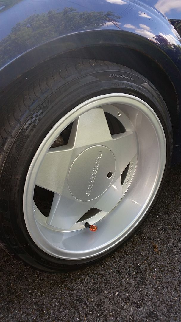

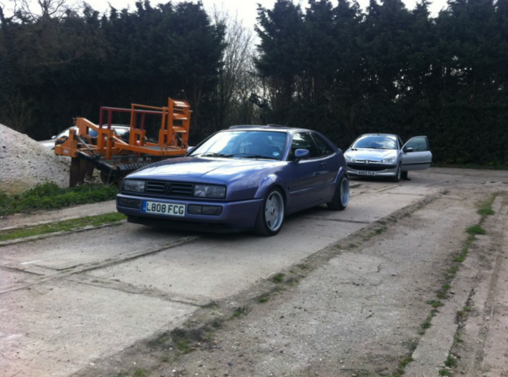

My C came like this when I bought her,
Lowered a little now,
And a little stretched (maybe an inch max?),
But on 17"

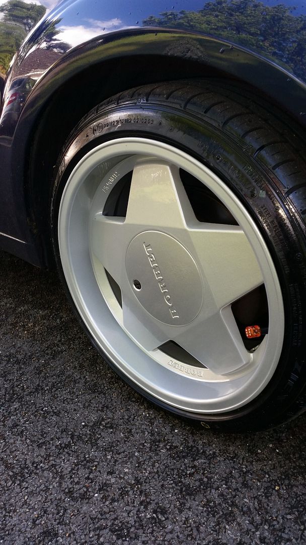

my C came with borbets and had this tyre configuration, felt fine, nice look on the back but that size on the front is too big, looked awful and made the steering heavy. I have just swapped to a 195/40 on the front. Matches the stretch on the back perfectly and is perfectly comfortable.
I used to run 195/45 on a 8" all round with no issues, what i have now is less stretch.
