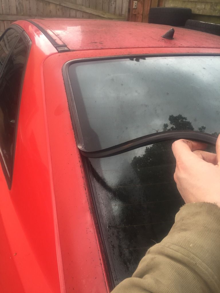

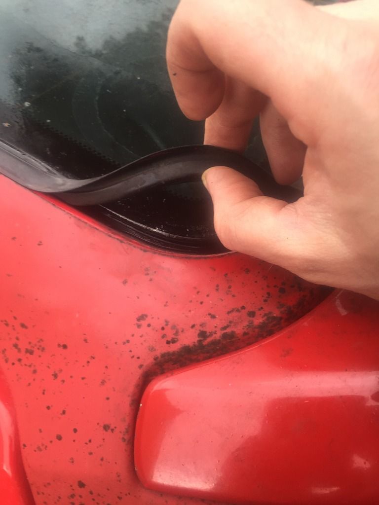

easypops 8 Posted July 23, 2016 So, tried the seal on the breaker, it's very well stuck, no real movement, I will try again, so I opted to try the one on the red car......I'll be swapping that one anyway.......it came out quite easily, it's not exactly perfect but it's better than nothing Quote Share this post Link to post Share on other sites
