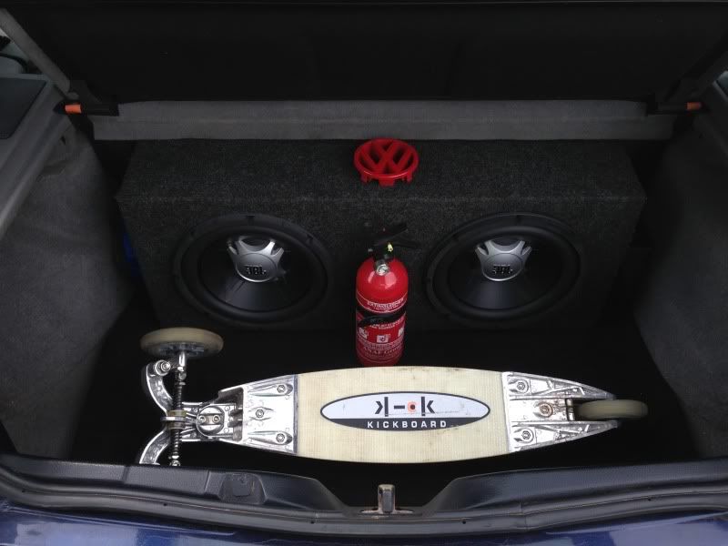

Obligatory boot build:

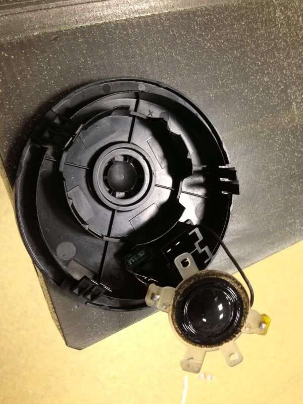

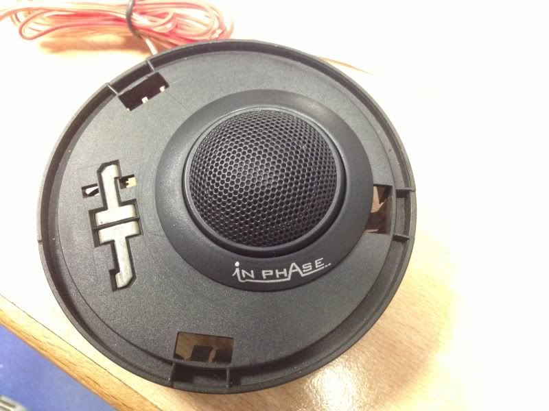

along with comps up front, used the standard tweeter positions:

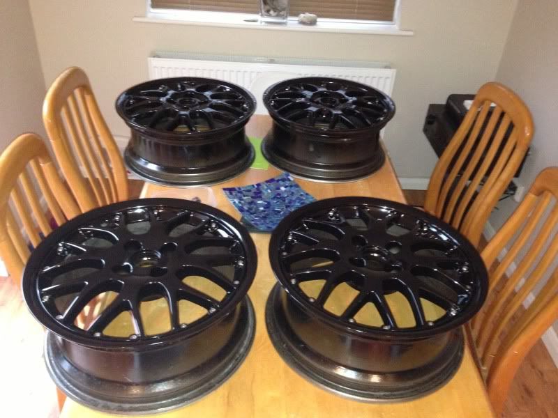

I also refurbed some BBS RX2, 16" 4 stud from the mk3.5 golf cabby I had, ended up selling these when i took the rado of the road

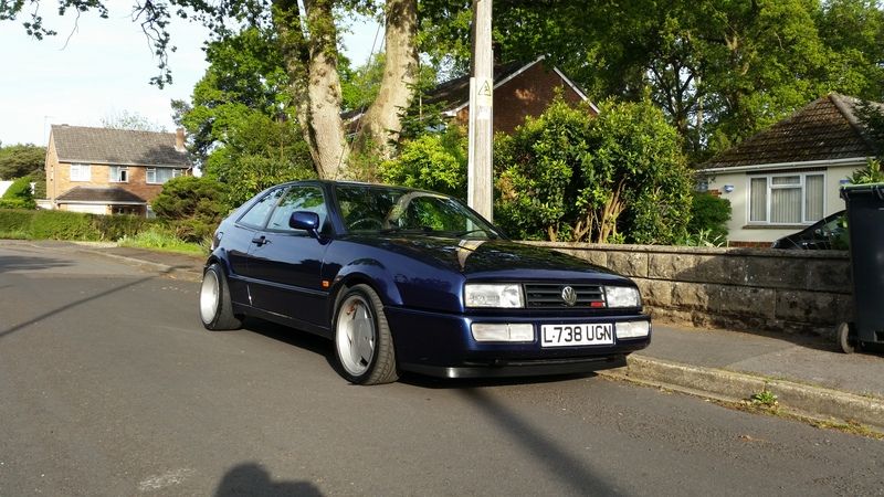

So last month the time came to come back to it after a year off, and this time I'm 'going for it'. Its now MOT's and back on the road. Had been covered but i did fear the worst when I uncovered it, but it wasnt too bad, just dust and full of cob webs and leaves. Also found a False Widow in the door shut!
All cleaned and standard grille setup

The wheels were in a terrible state, lots of rash and one of them very bent, plus they were a very nasty dirty flat grey colour. Last week all refurbed and the balloon tyres that were fitted were replaced by 195/40/16
much better!

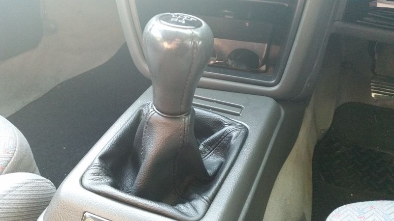

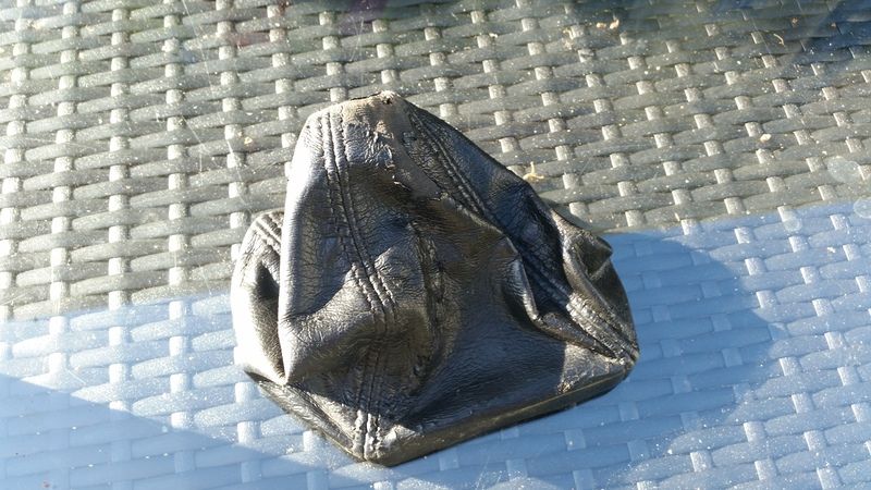

only a small update but progress nonetheless, old gear gaiter knackered, though these were leather but clearly not!
new one fitted and this time actual cow!

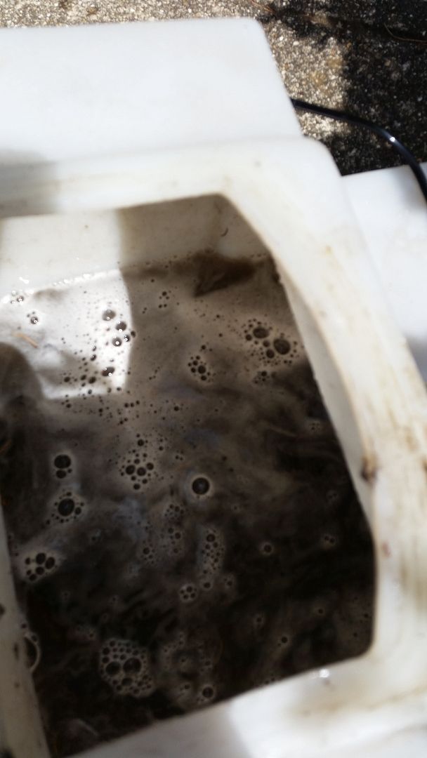

black carpet cleaned this weekend, got the old rug doctor on the case, came out well
three bucket fulls of this came out of it!

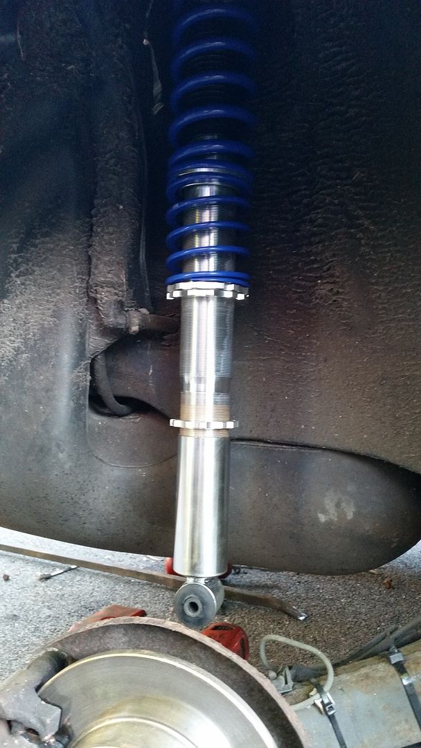

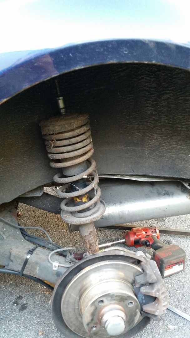

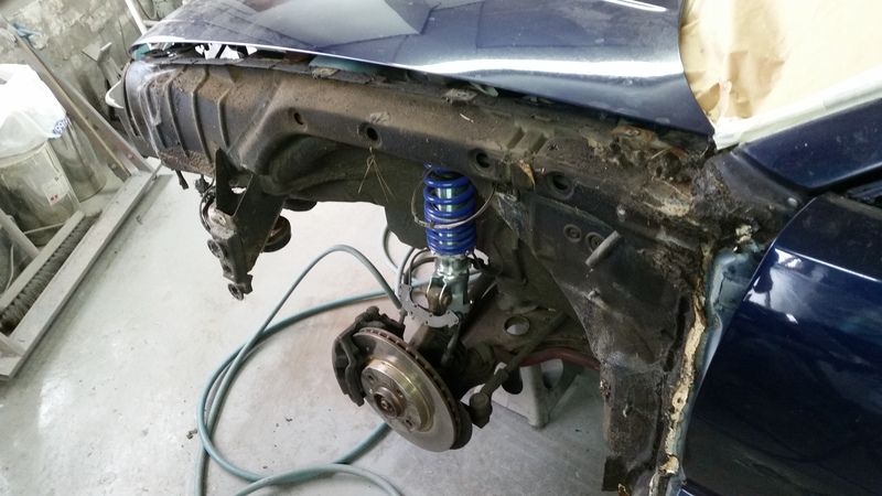

This week mostly prepping ready for the bodyshop on monday, this includes fitting coilovers and new top mounts front and rear so we can get the height right so arches can be pulled to accomodate the wheels and my desired lows.

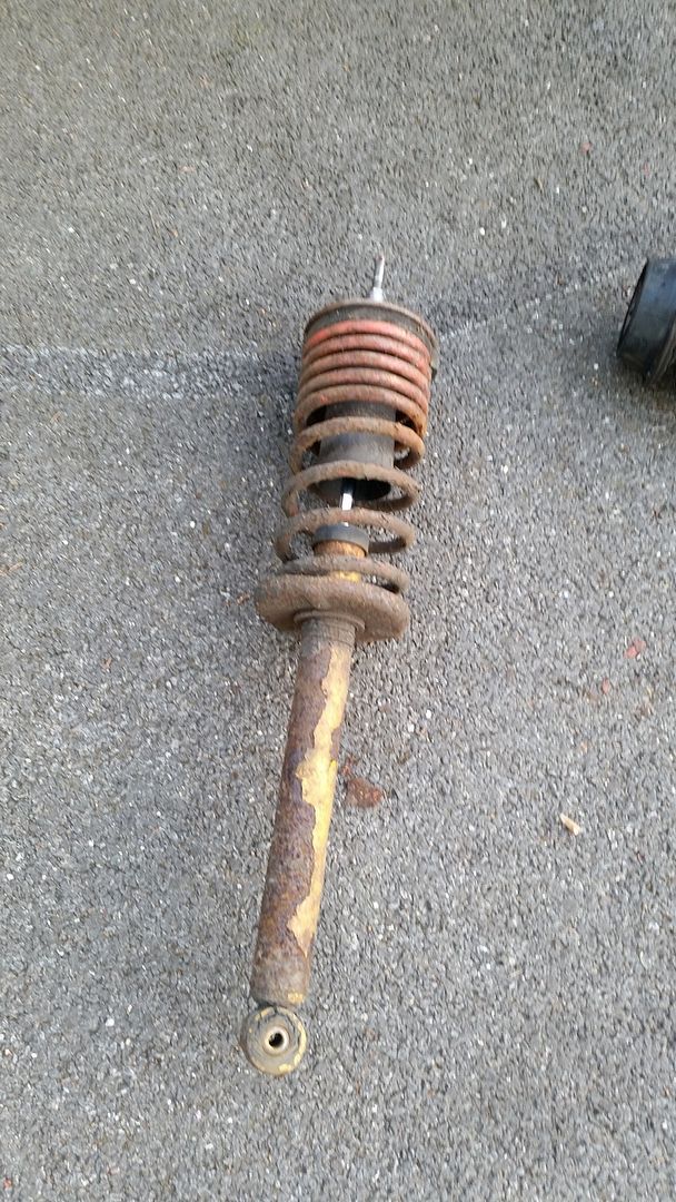

This weekend I took the old and very rusty springs and dampers of her and fitted with some nice new coilovers. Nothing fancy as I want to put it on bags next year. Ride is surprisingly good. Also replace the mounts front and rear while we there.
manky:
shiney:

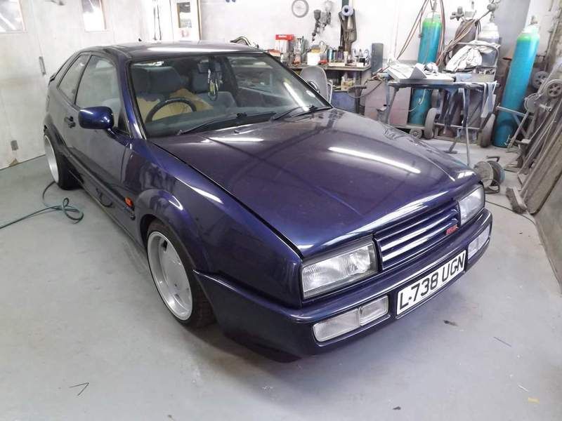

Dropped it to the bodyshop today, will be there for the next 3 weeks so will post updates when I have them!
side strips back on or leave off? loved them on my previous C, which was red, broke up the light colour. I'm thinking on this darker colour that maybe they don't have as much of a visual effect?
Its only been gone since monday morning but I really miss her :-(

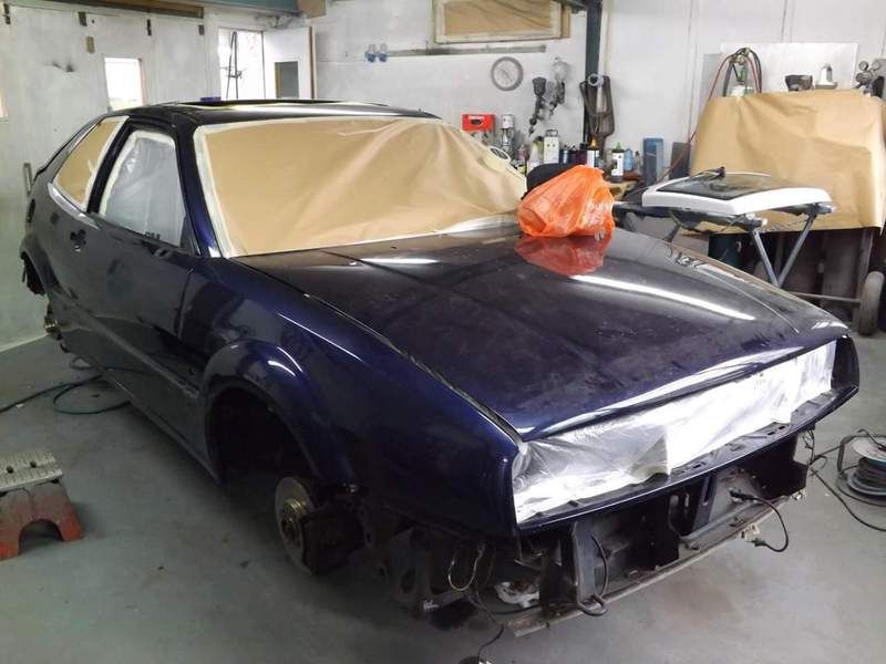

Now for the long wait. How long do they recon it will take? Any decisions on black plastics?
I'm going in tomorrow morning to have a look and talk about the mirrors being completely colour coded and rear plinth and handles being gloss black. Def going to leave the side strips off.

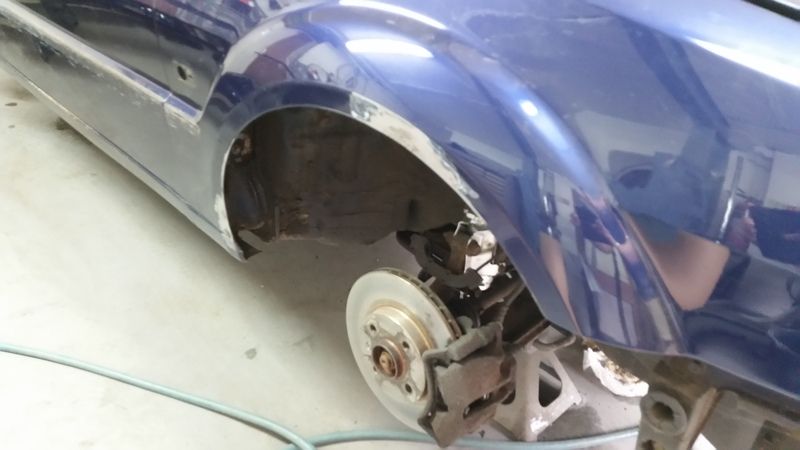

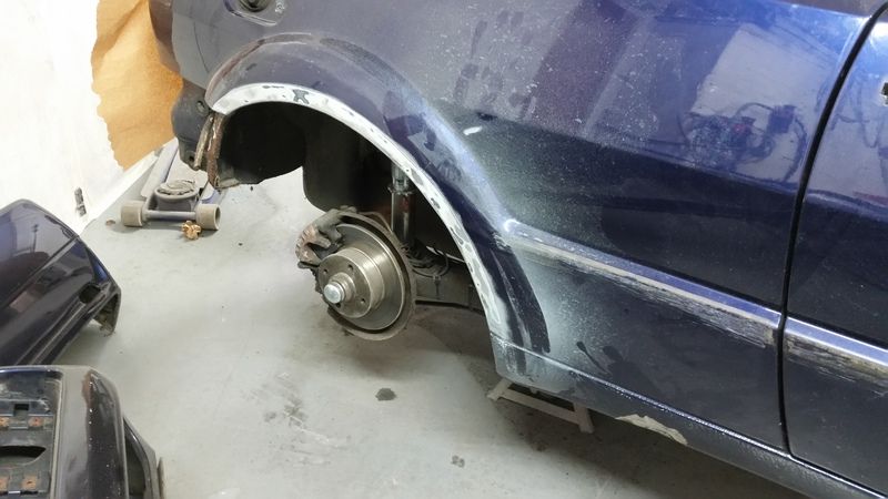

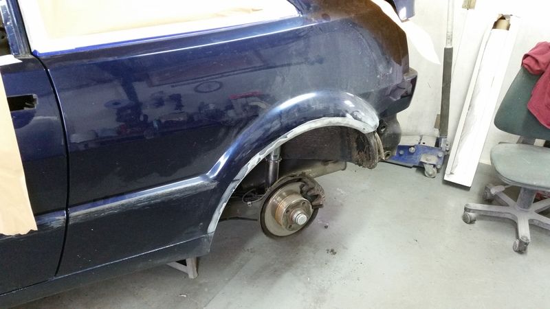

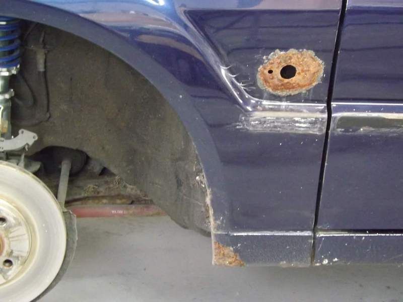

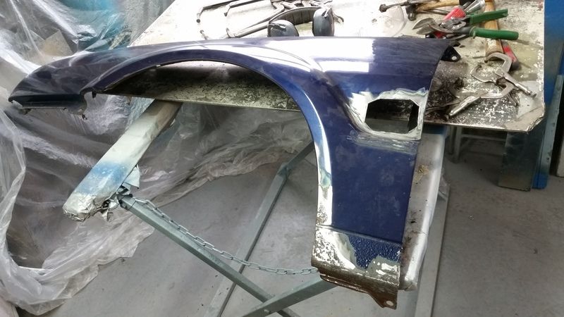

Went to see progress today, not as much done as he'd hoped as some little jobs needed clearing last week. Over the next couple / three weeks it will pretty much be sole focus so should come on well. Found a few holes that needed welding up, some pretty major rot around bottom of passenger wing and inner arch and sill. I'm going for gloss black rear plate holder and completely colour coded mirrors. Have new gloss black rear vw badge to go on so to continue the theme going for gloss black corrado script rather than colour coded. So now I'm thinking front grille gloss black as well?
Also I've decided only to reapply stoneguard stuff to the very bottom of the sills and have the rest smooth.
