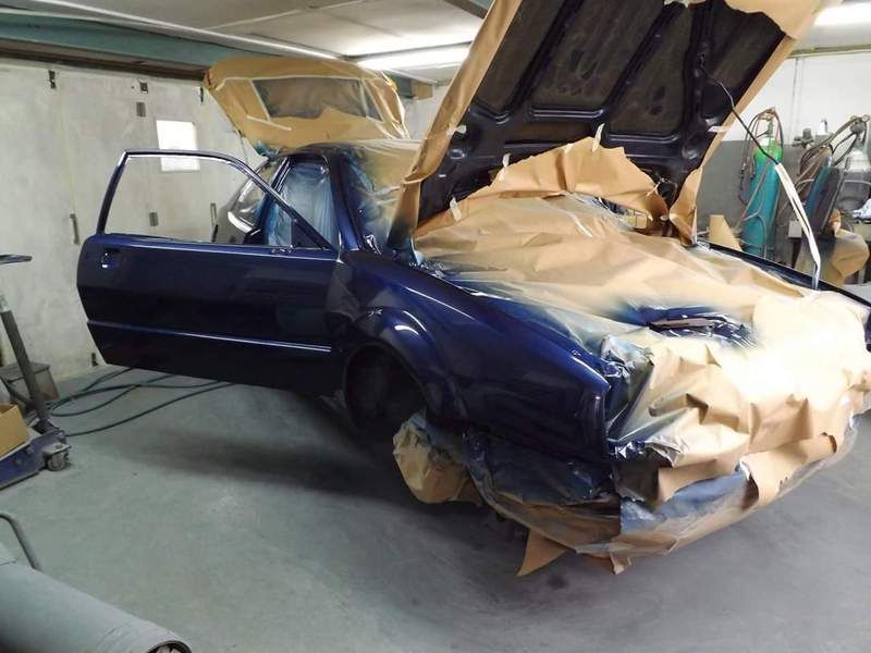

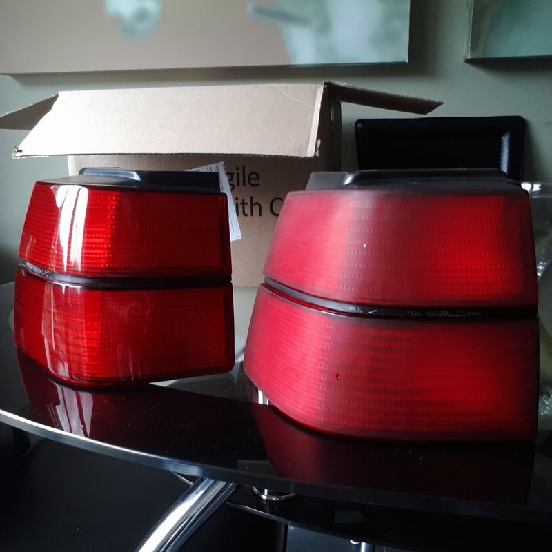

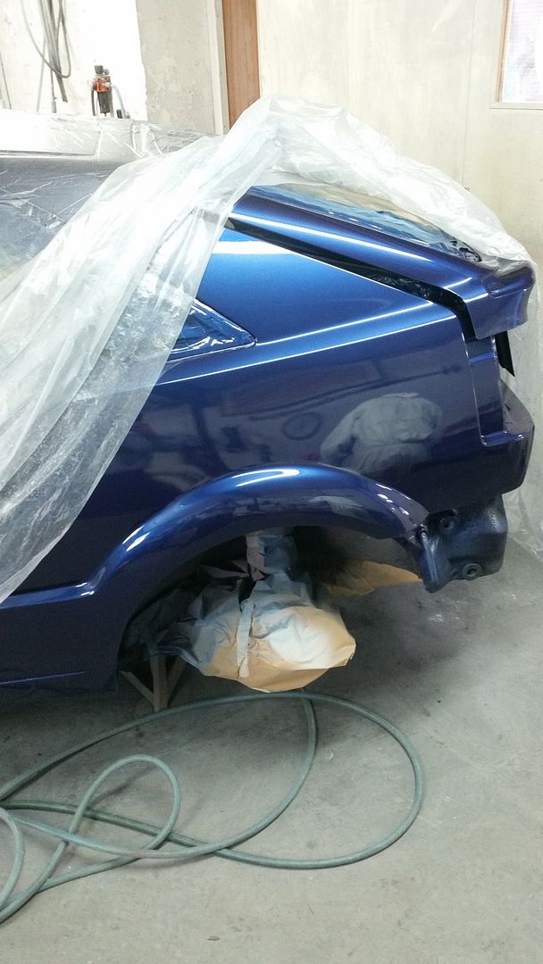

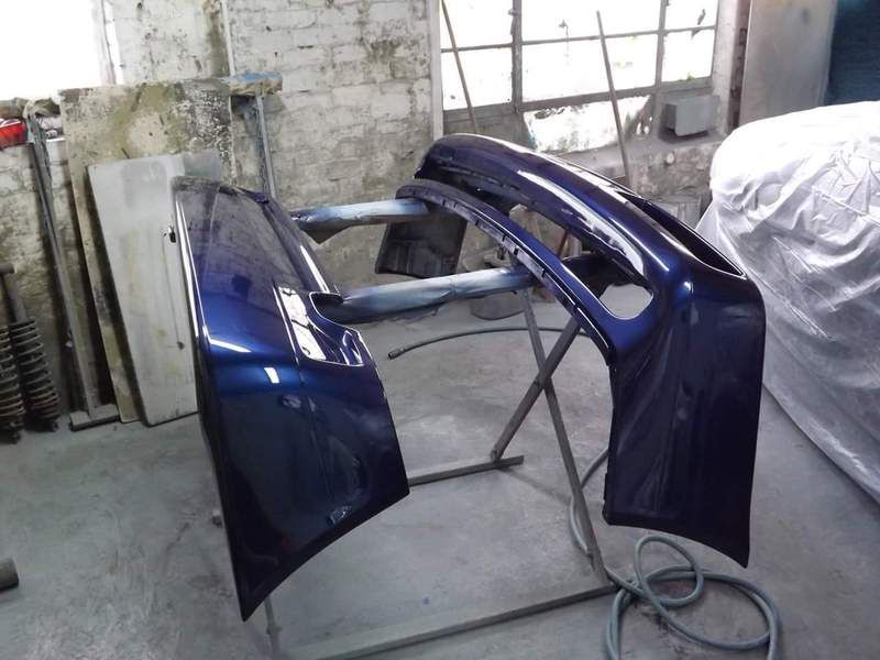

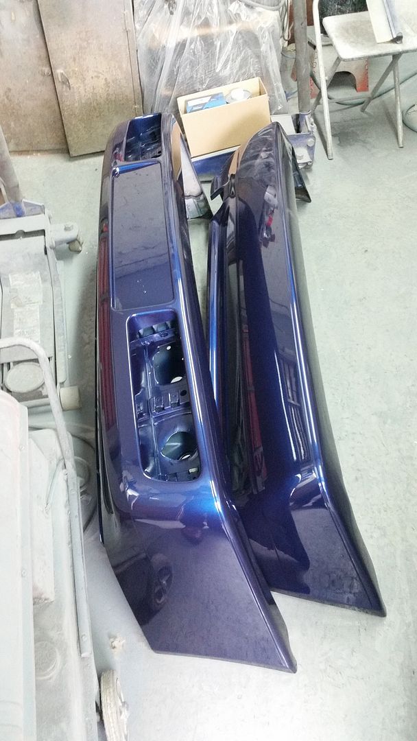

borarob 0 Posted July 14, 2015 a couple of pics from todays visit. everything has now been painted, 'just' needs flat and polish bumpers after f&p, looking sexy! also i finished my all red rears and dropped them off ready for the fit up later in the week after the lacquer had dried for a few days I flatted back with 1200 grit (right hand light), then used Megs Scratch X to polish up to a shine, love this stuff, leaves no micro scratches or swirls at all, the one on the left is the finished article now to order some amber LED bulbs.... Quote Share this post Link to post Share on other sites

Philuk 0 Posted July 19, 2015 Very nice mate, new paint is the best ain't it!really like the all reds! I think I'll have to redo mine :D Btw how did you remove he lettering from them? Quote Share this post Link to post Share on other sites
borarob 0 Posted July 19, 2015 Very nice mate, new paint is the best ain't it!really like the all reds! I think I'll have to redo mine :D Btw how did you remove he lettering from them? Elbow grease and firstly a craft knife then 400 grit wet and dry. If anyone is going to do their lights I can't stress enough how important it is to flat well. 400 then 800 then 1200, each time when you think you've finished, keep going for another 30 minutes! Quote Share this post Link to post Share on other sites

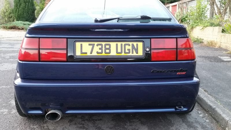

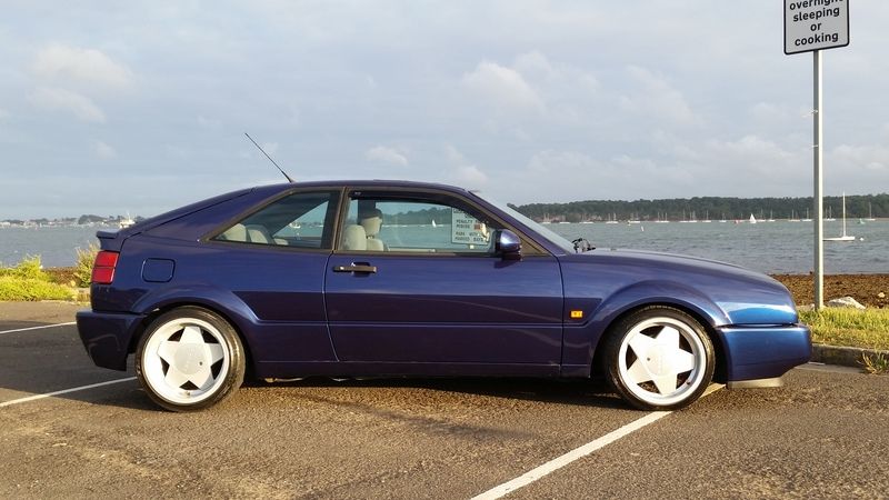

borarob 0 Posted July 22, 2015 ok so i got her back late yesterday afternoon. She needs a wash (very mild with all new kit that is softer than a baby's ass crossed with a peach covered in feathers), but even without that I'm very pleased! Took it out for some pics and within seconds someone wandered over to have a look and tell me how nice it looked!! I love the rear end, all reds turned out great, even if i do say so myself. I bought some very bright (and expensive) Cree based LED amber bulbs, they are amazing, shine through 100% amber, not even a dark amber, perfect. As you can see have gone for gloss black rear plinth along with gloss black corrado script and new black rear badge yummy! picked up the window deflectors at Inters, love the look, also fitted the new pressed plates I had made up/ front end, have continued the gloss black theme for the badgeless grille. I think at some point i'll do the headlamp surround gloss as well. you cant tell too well here but also gloss black for the inner piece of the wing mirrors, which are brand new ones, nice smooth action now hehe, new sticker I'm now after a lupo / TT wiper set up so if anyone has anything lying around, let me know Quote Share this post Link to post Share on other sites
