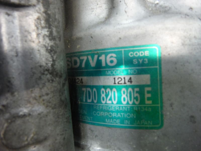

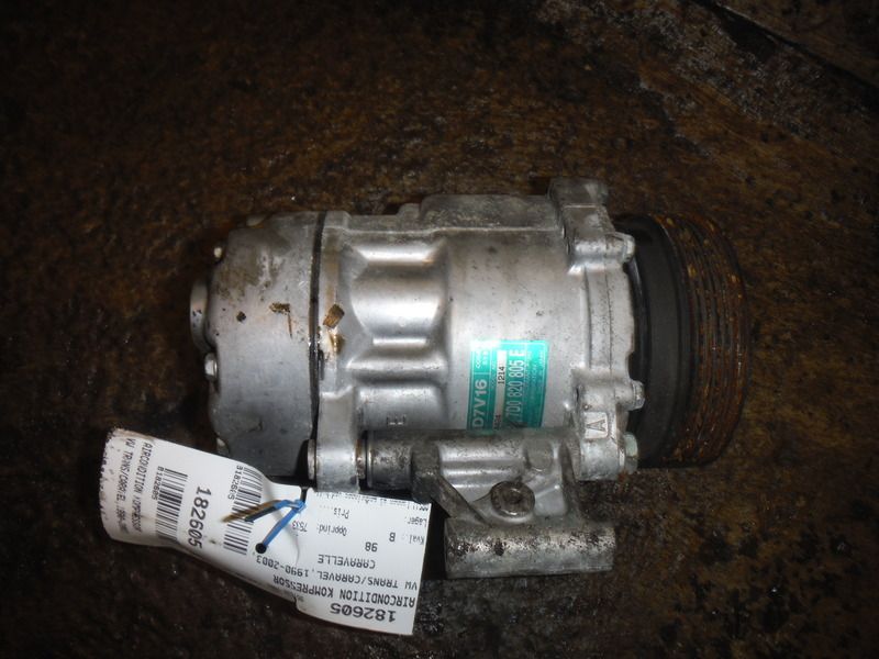

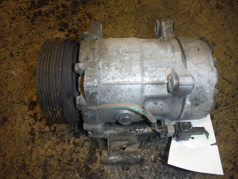

Anyone know if the refrigerant compressor from a 1998 Caravelle VR6 can be used on the Corrado VR6 ? (1995 model so it's R134 gas).
If not is there any other cars one can take a "Sanden" compressor from that will fit?.

That would be appreciated - the one pictured over comes from a Caravelle VR6, not sure if there is much difference on the VR6 bracket's used on the caravelle either?.
