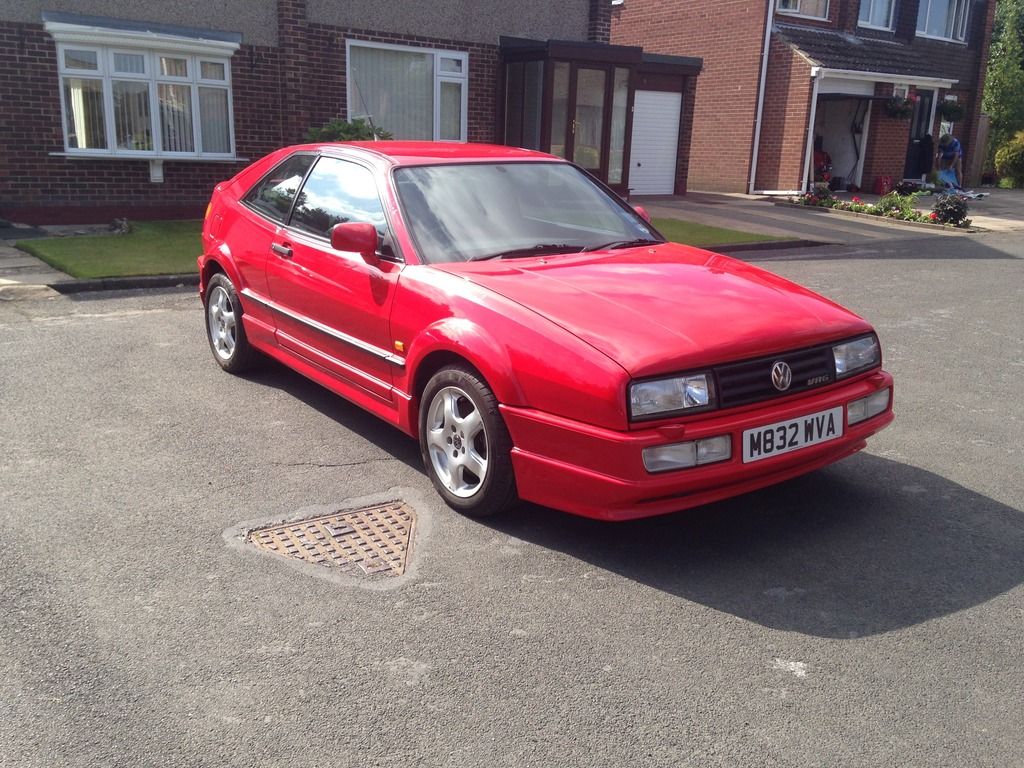

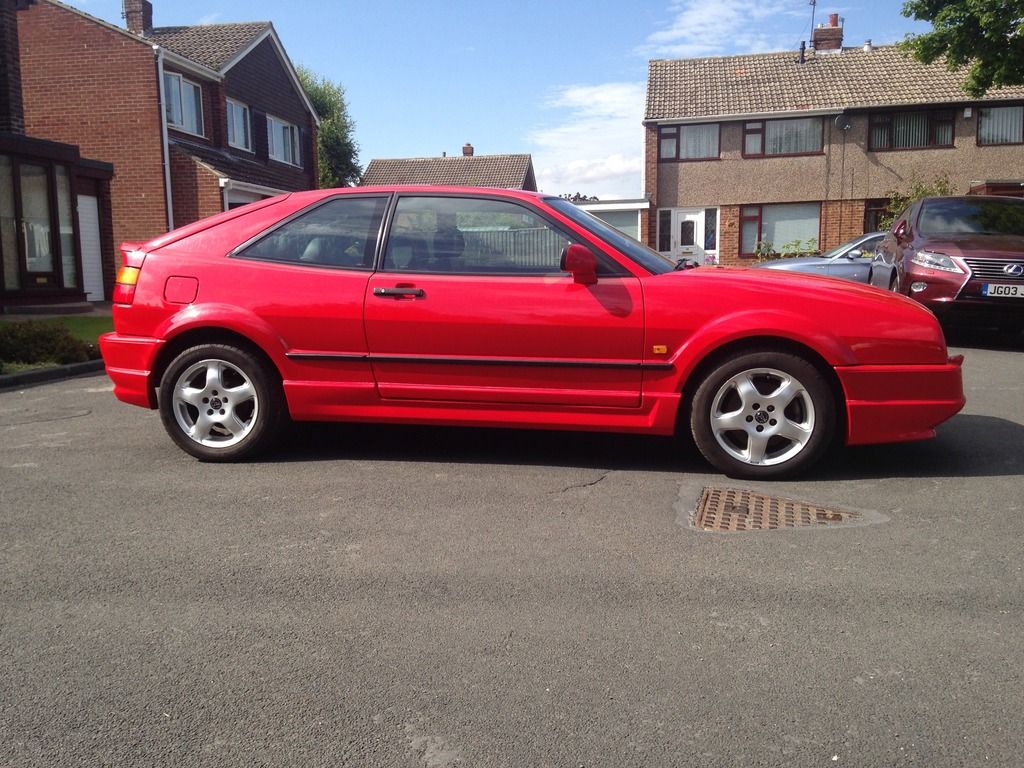

Goldie 2 Posted July 19, 2015 (edited) Im going to start a thread on this car to keep a track of the progress on the jobs I'm doing. The car is for sale but i can't update the advert so this seem the best way. I bought the car along with an 8v and mountain of parts last year. Anyway, the car its a 1994 VR6 with 62k on the clock. It has factory Recaro Leather and Headlight washers. It has also been fitted at the dealers with Diavia Aircon and a Zender bodykit. It has been dry stored most of its life hence the low mileage. In the last few years the suspension has been refurbished so rear beam powder coated with new bushes and bearings. Upfront the subframe and wishbones have has the same treatment. Ill post some mored details later on but here are a couple of pictures of it as it stands. Edited July 19, 2015 by Goldie Quote Share this post Link to post Share on other sites

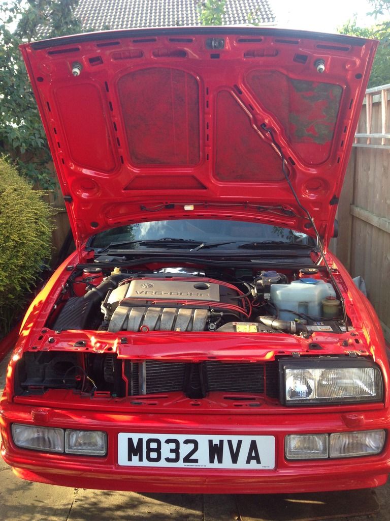

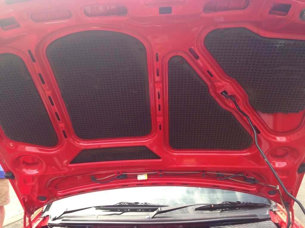

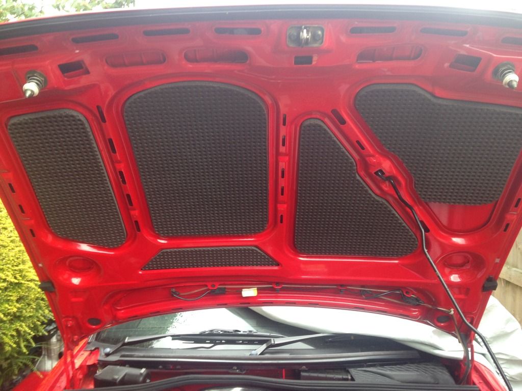

Goldie 2 Posted July 19, 2015 List of jobs that need doing: Oil leak from oil filter housing. Oil temperature does not read on MFA. Bonnet foam rotten. Door card top trims cracked. Mirrors do not move on the switch. Heater direction control temperamental. Ignition switch intermittent. I made a start on these over the weekend. The low pressure oil switch was passing oil up through the spade. This has been replaced with a new one. Oil temperature switch changed for a new one. Bonnet foam removed and one from the group buy fitted. Bonnet foam originally. Half way through the job. And finished. If the weather holds ill try and do a bit more on the car today.. Quote Share this post Link to post Share on other sites

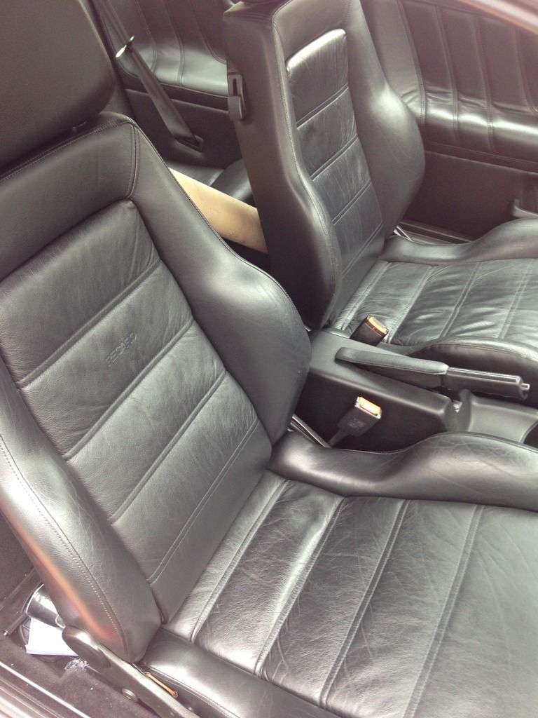

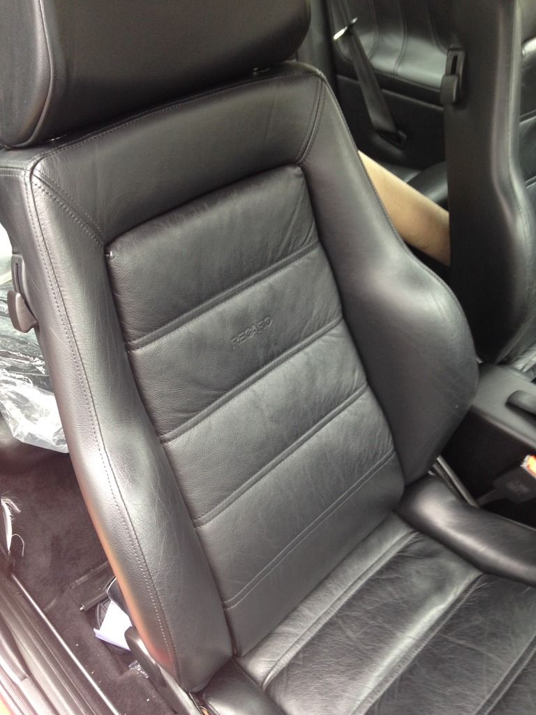

Goldie 2 Posted July 19, 2015 Ive heard a lot of stories about changing the ignition switch, not looking forward to it but I'm sure ill get there.. The passenger seat wiring needs sorting out but overall these are the best OE Recaros I've seen. Zero bolster wear or marks on the leather. They may end up coming out the car.. Quote Share this post Link to post Share on other sites

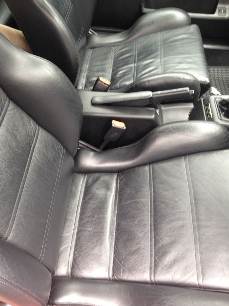

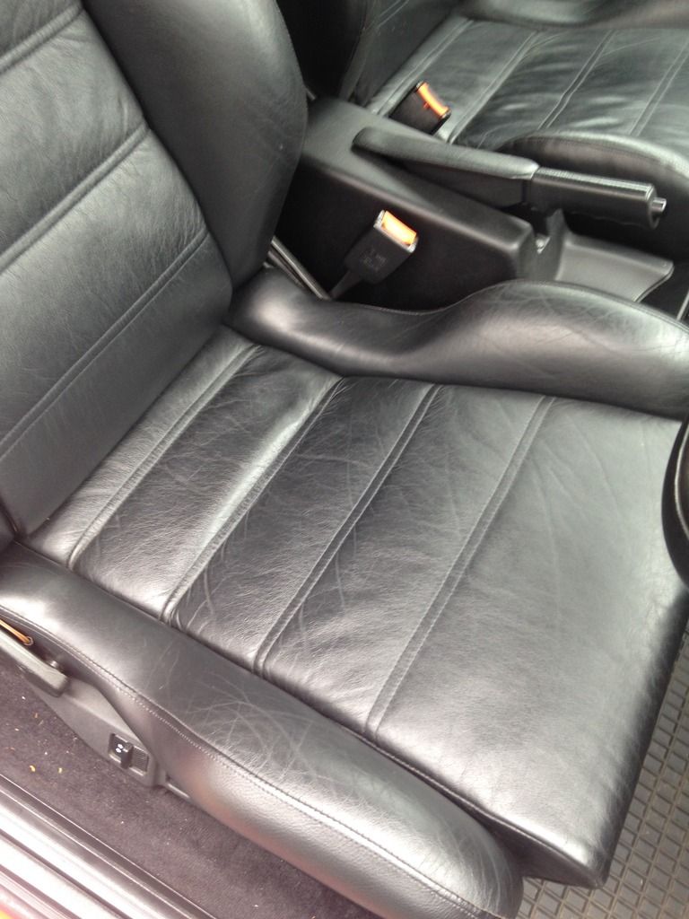

Goldie 2 Posted July 19, 2015 Door card top trims changed... Seats: Quote Share this post Link to post Share on other sites
Jim 2 Posted July 19, 2015 I ended up doing the ignition switch from underneath having taken the front seat out - not sure if it's a bit more involved removing recaro's though than the standard seats! As others have said, a long thin screwdriver with an appropriate little bend in it and it was not too bad a job then. I cable tied in the replacement though I have to say - there was no way that little screw was going back without a fight! Quote Share this post Link to post Share on other sites
easypops 8 Posted July 19, 2015 The seats do look spot on, very nice indeed 8) Quote Share this post Link to post Share on other sites
