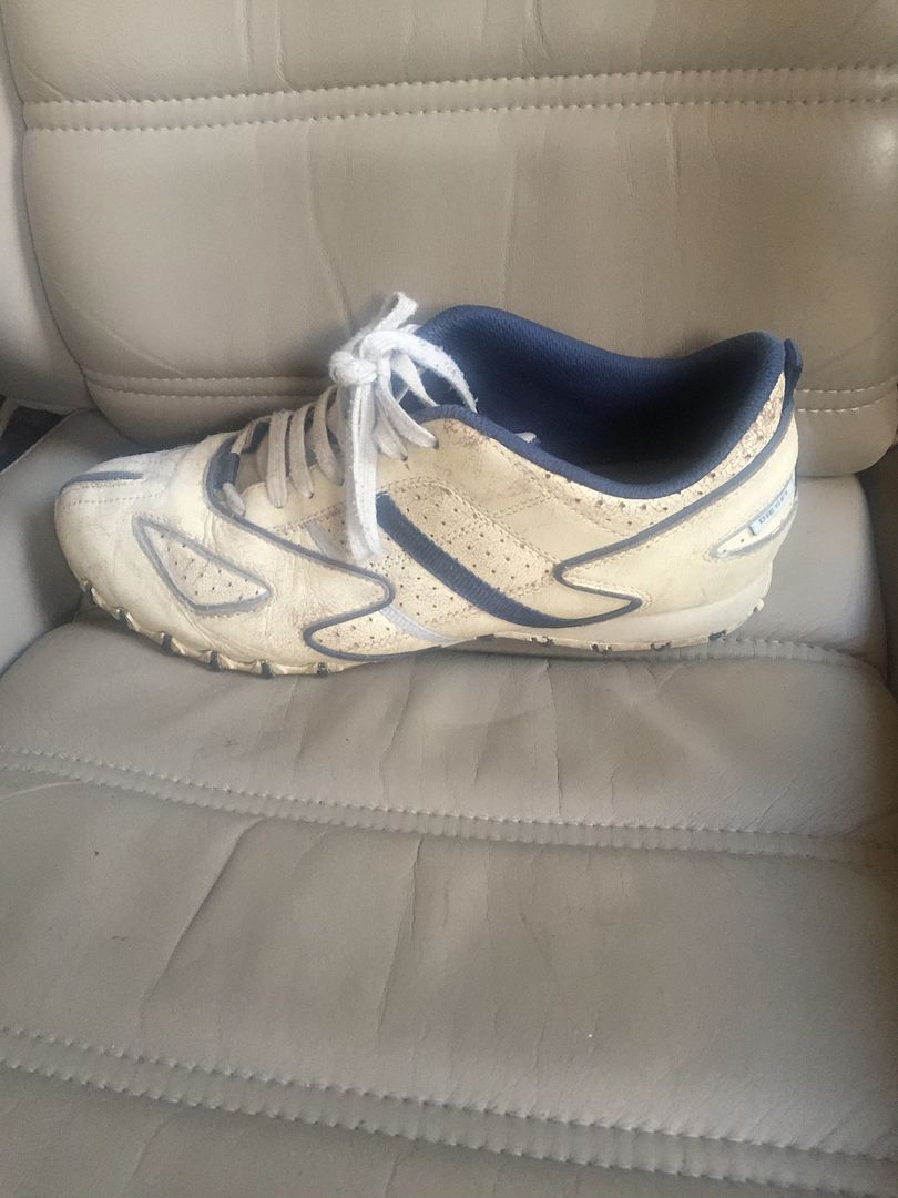

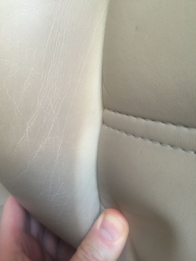

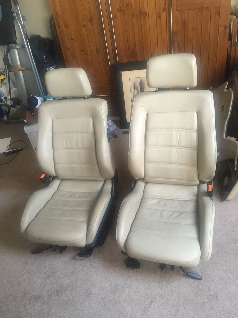

easypops 8 Posted August 23, 2015 Good day all, I recently purchased a green Storm with the cream leather interior. Thing is, it's not all that cream, almost a greeny tinge. I bought the small scuffmaster kit from gliptone to see if the colour was a match, or lighter as I was hoping. The match is perfect for the colour it is now, so they've obviously matched it before. My reason for the post, does anyone know of a lighter shade of cream I can order to re dye the leather. I don't want to order 1L of the stuff blind Couple of pictures including an old trainer in the colour I'd like :) Lighter bit hidden Trainer for comparison Quote Share this post Link to post Share on other sites

easypops 8 Posted August 25, 2015 Thank mate, I got the toner bottles with the small scuffmaster set I bought. Thing is, the colour out the jar is a perfect match. Problem is, in my eyes, it's just not creamy enough. What I want is a big bottle of something I can just open and go for it :) My hope is, that someone has used a product for something else, jaguar, bmw etc and could post a picture that it's more like I'd want, does that make sense? :lol: I'll wait to see what C5 OEM comes back with Quote Share this post Link to post Share on other sites

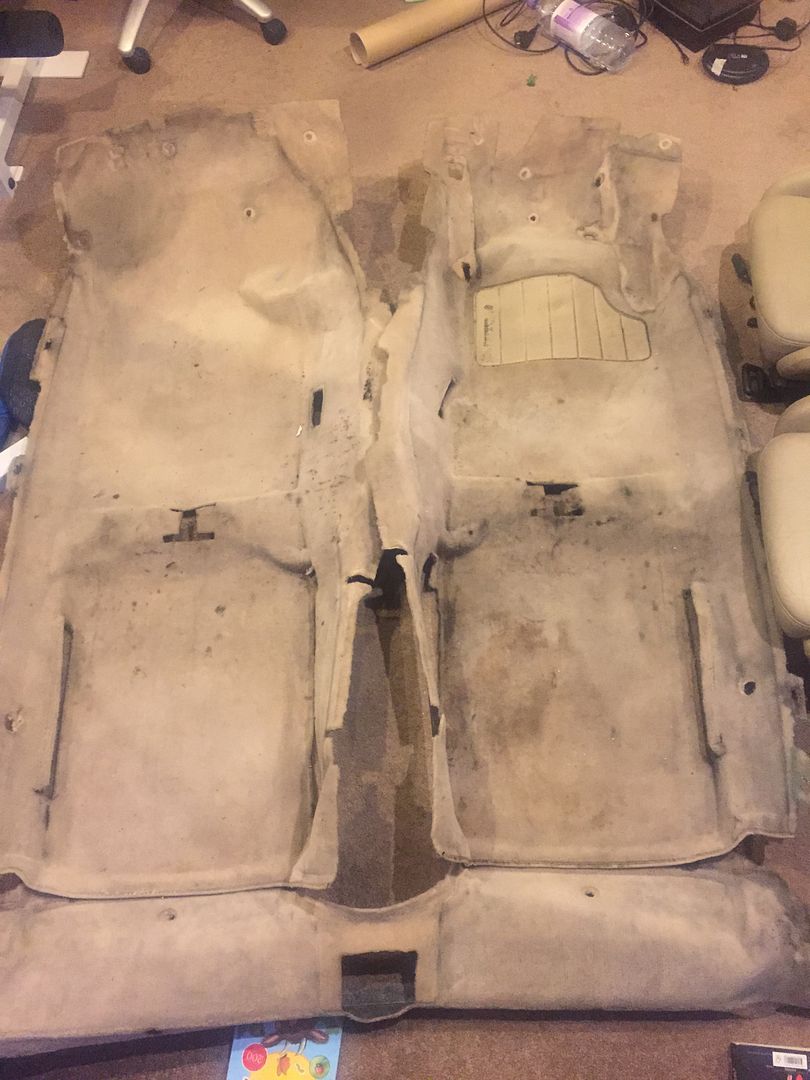

easypops 8 Posted August 25, 2015 Next issue will be trying to clean the dirtiest carpet ever Quote Share this post Link to post Share on other sites

Notorious 10 Posted August 25, 2015 Wow looks great. I had a MK 4 Cabrio with that colour interior in and the carpets were pretty bad when I got it. I had no idea you could actually ever get them that clean again, nice work. Quote Share this post Link to post Share on other sites

Declan Sedrick Lehane 10 Posted August 25, 2015 That looks amazing, I need to do that to mine! How easy is it to remove the carpet? Quote Share this post Link to post Share on other sites
easypops 8 Posted August 25, 2015 That looks amazing, I need to do that to mine! How easy is it to remove the carpet? Fairly easy(must be if I managed), remove all seats, remove plastics behind accelerator pedal and opposite side plastic at passenger side, plastics that run along sills at the doors, remove front seatbelt bars, quite a few of the flat plastic screw things dotted about, all centre plastics and it'll come out easy enough. Took me about 40mins after the seats were out Quote Share this post Link to post Share on other sites
MDMTechnik 10 Posted September 12, 2015 Bloody hell, carpets look awesome. What did you use to get them looking that good? Quote Share this post Link to post Share on other sites

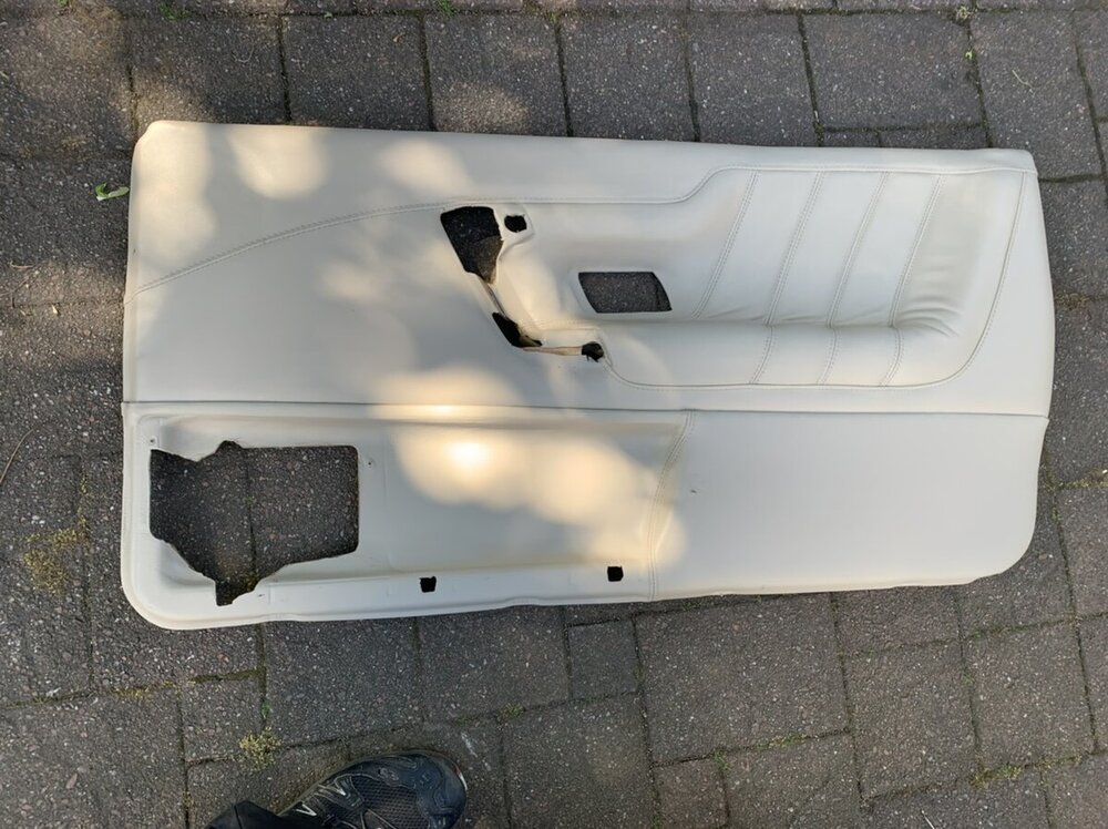

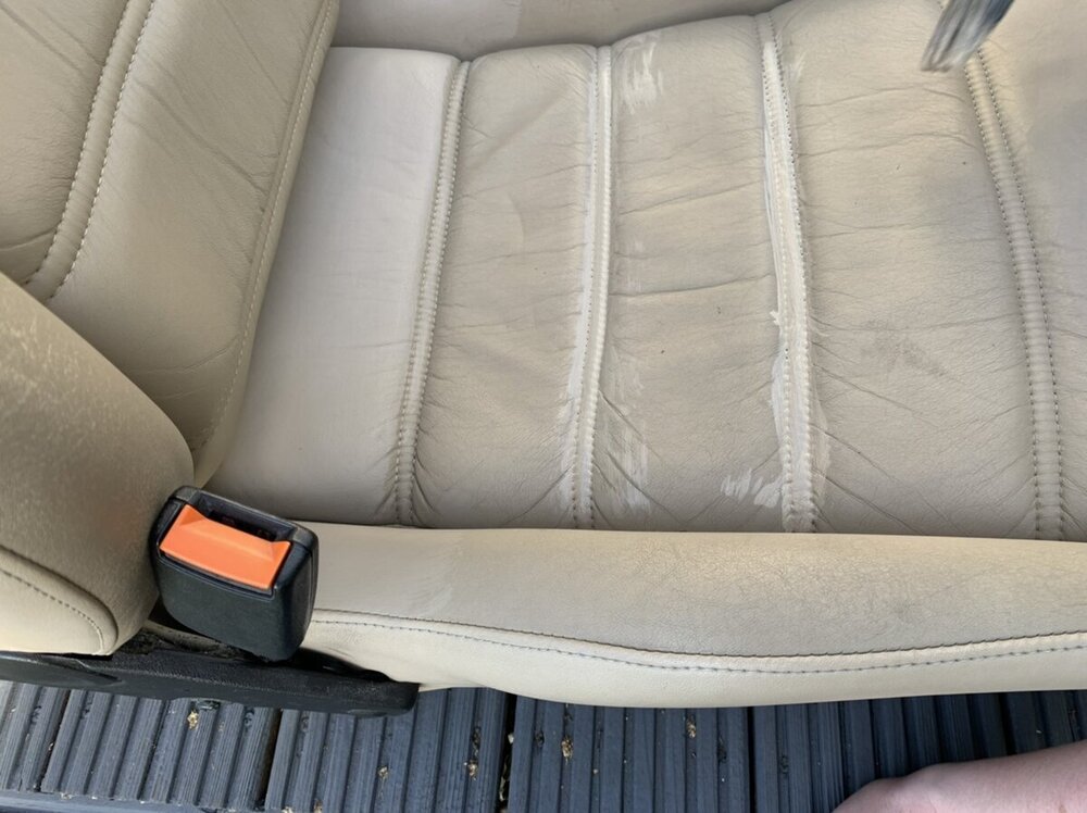

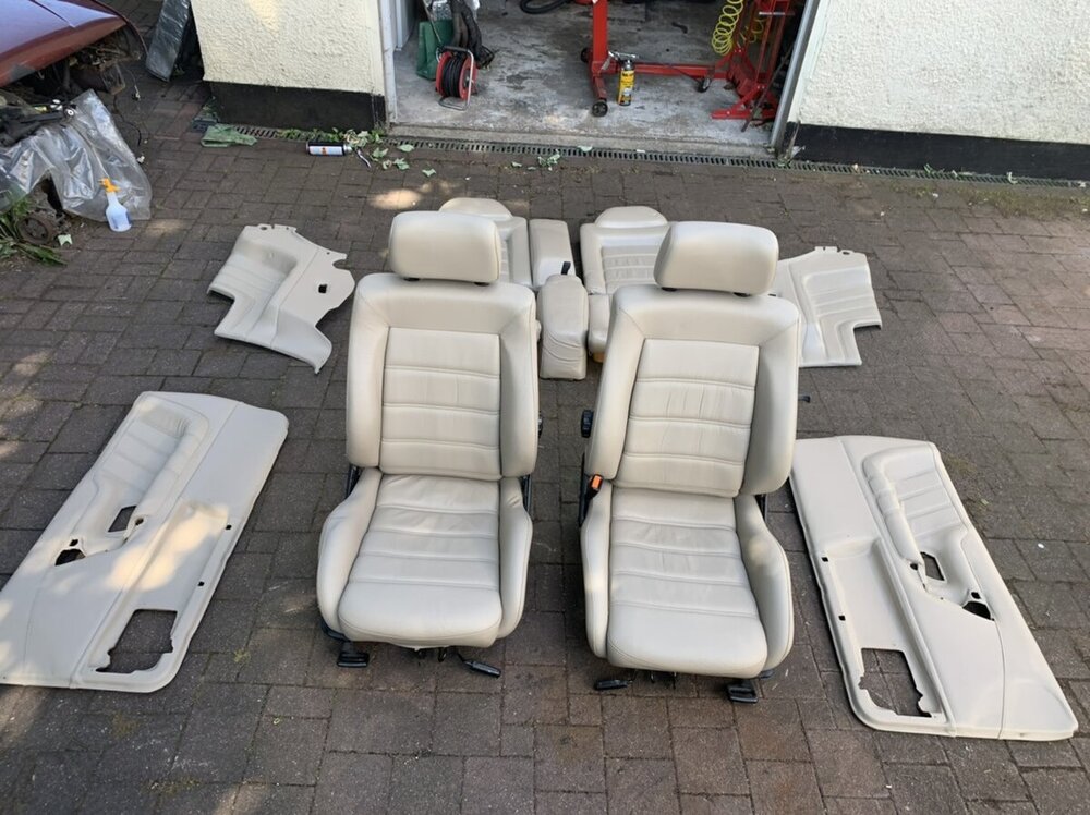

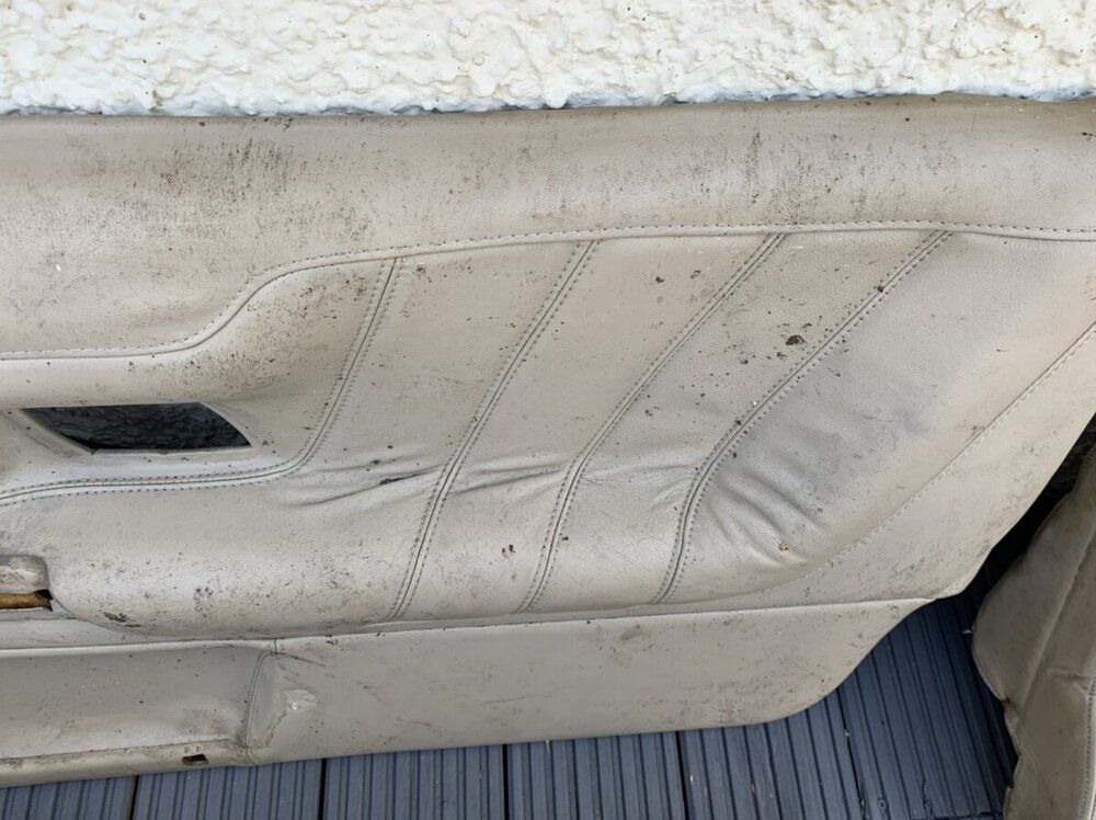

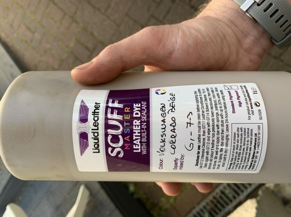

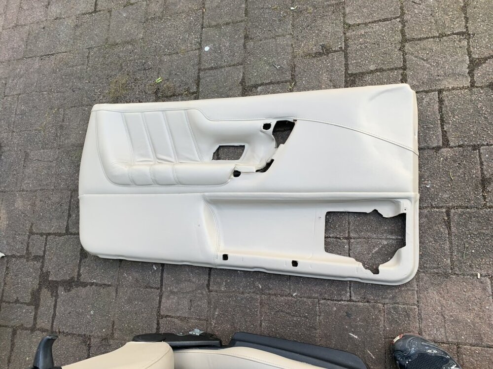

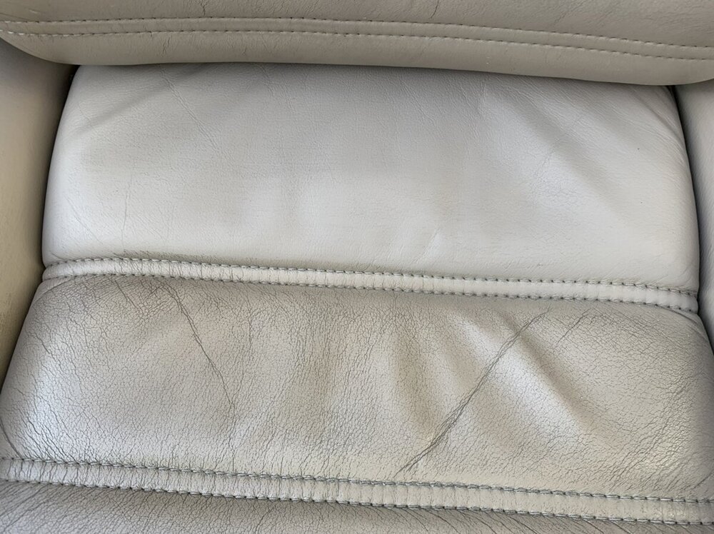

easypops 8 Posted June 29, 2022 I eventually got round to doing this after a few years 🤣 I used the Scuffmaster , I’ll attach a picture of the actual dye. Be aware though that I did the whole interior, not sure a repair wouldn’t stand out a bit as it’s very likely not going to match 100% a well worn set. I liked the results that much I’ve bought a 2nd bottle as I have another cream interior (Recaro’s) as I sold the standard one after I’d got it all dyed etc. Plus, I’ve got a bottle of the grey (sent a sample in to match) so I could do the other interior at some point Quote Share this post Link to post Share on other sites
fla 9 Posted June 30, 2022 19 hours ago, g0ldf1ng3r said: when i got my kit from them i just told them the year & model of vehicle & they had a list to match it up IIRC i had a guide of steps to follow when using their products but cant remember if they gave it me or i got it elsewhere just give them a call m8 - they were based down the road from me so i just popped in to see them & they were very helpful thank for that. That was Furniture Clinic was it? I'll definitely give them a call. 11 hours ago, easypops said: I eventually got round to doing this after a few years 🤣 I used the Scuffmaster , I’ll attach a picture of the actual dye. Be aware though that I did the whole interior, not sure a repair wouldn’t stand out a bit as it’s very likely not going to match 100% a well worn set. I liked the results that much I’ve bought a 2nd bottle as I have another cream interior (Recaro’s) as I sold the standard one after I’d got it all dyed etc. Plus, I’ve got a bottle of the grey (sent a sample in to match) so I could do the other interior at some point Now that is an impressive result! Funnily enough, i have the same diagonal crease on the second strip on the base panel on my car too. How long did that take, roughly? Hasan Quote Share this post Link to post Share on other sites
