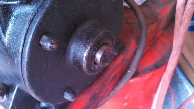

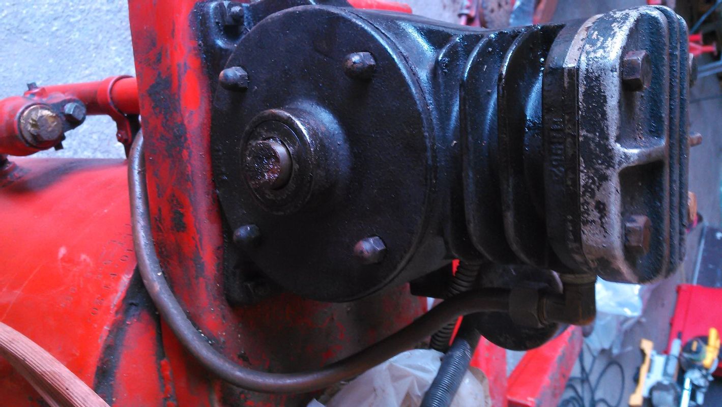

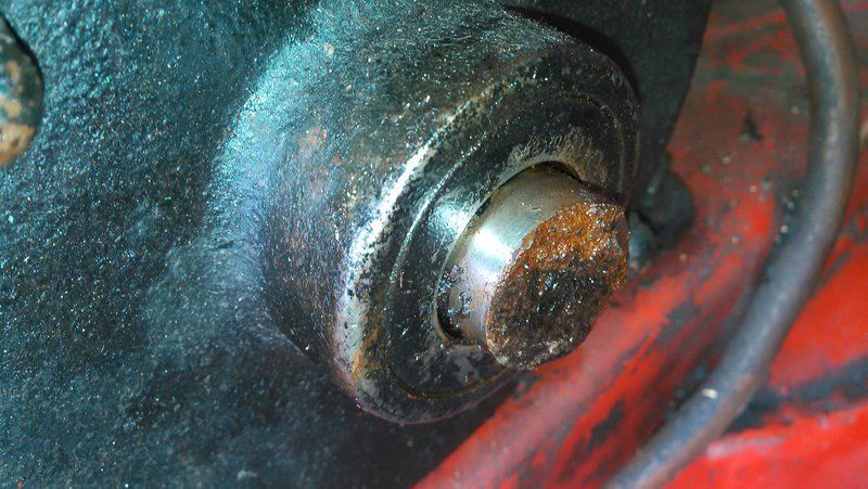

Just out of curiosity, would there be any chance of fixing a crank shaft on an old/vintage compressor?
Sitting like this (have both the "parts" of the shaft):
You could lathe drill and tap a thread into the end as a cheap fix. If you weld you would need deep penetration. It looks like high carbon steel? It will probably unbalance at high rpms a touch. Take it apart and have a new shaft made up. Won't cost too much.
Farndon Engineering would do it,when I had a tour of their workshop they were making up some vintage aircraft cranks !
