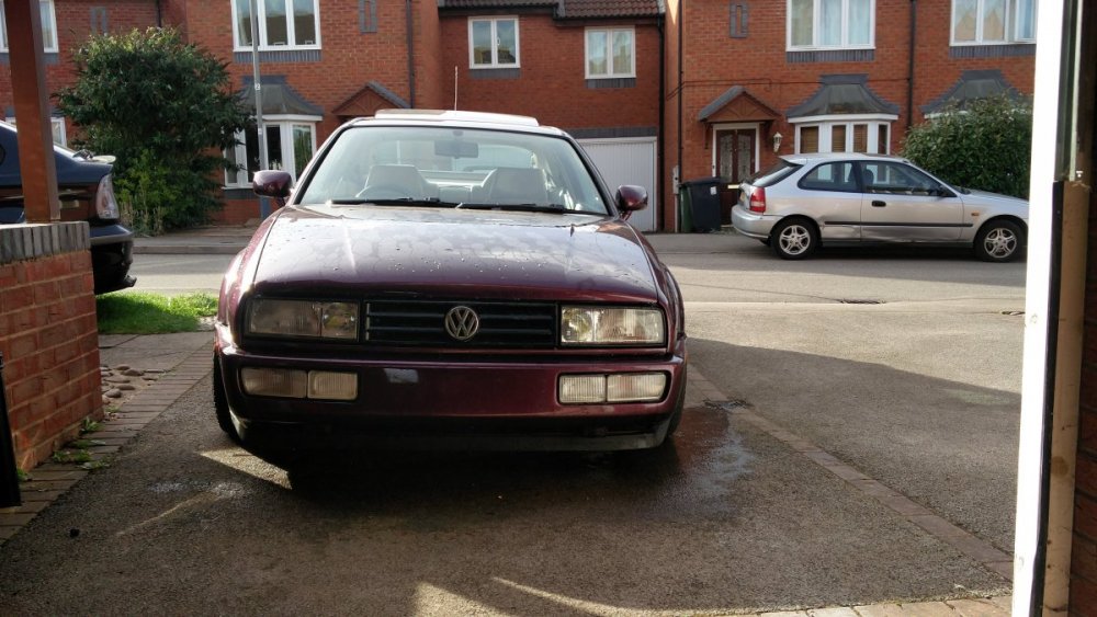

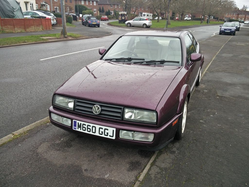

This picture was taken in inverness the same day as i bought the car to Murdo.
After 350 miles trip, i arrived to leamington spa with no issues apart of:

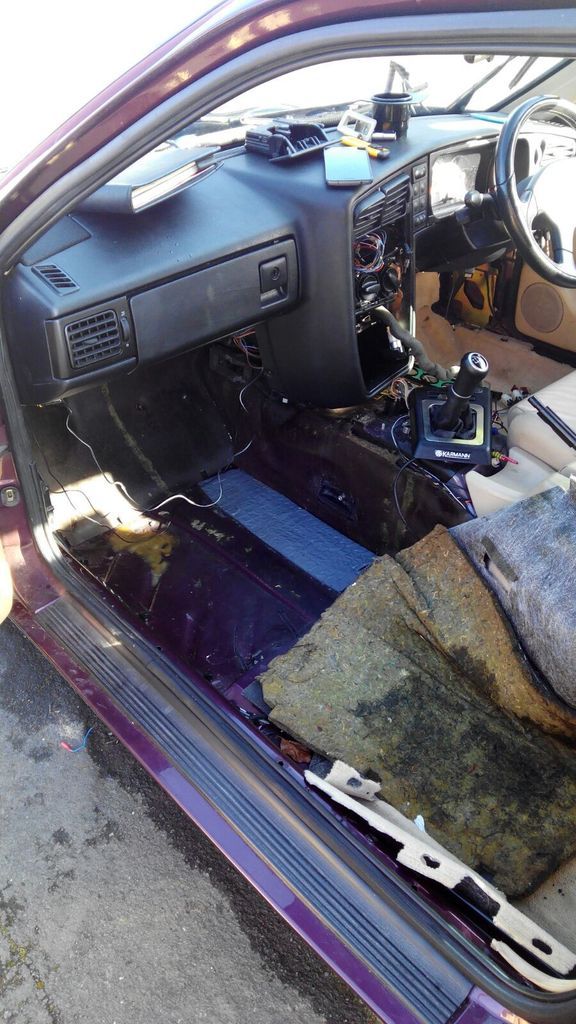

First weekend i decided to sort out the water leaking problem
I removed all parts from wipers area and carpets , seats, plasticas.. everything.
I found the water leaking throw a couple of holes and i changed the gasket of the heater fan

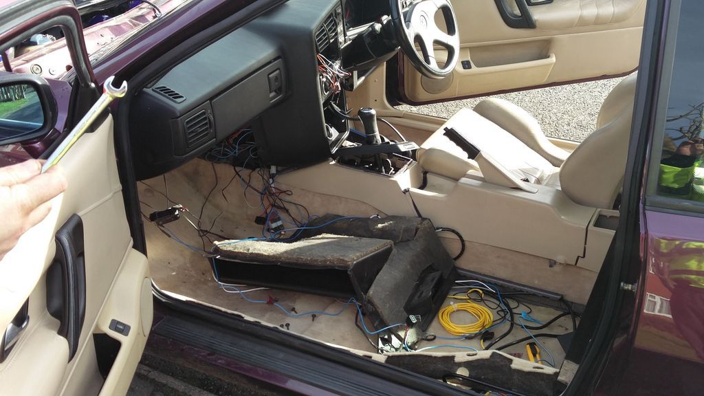

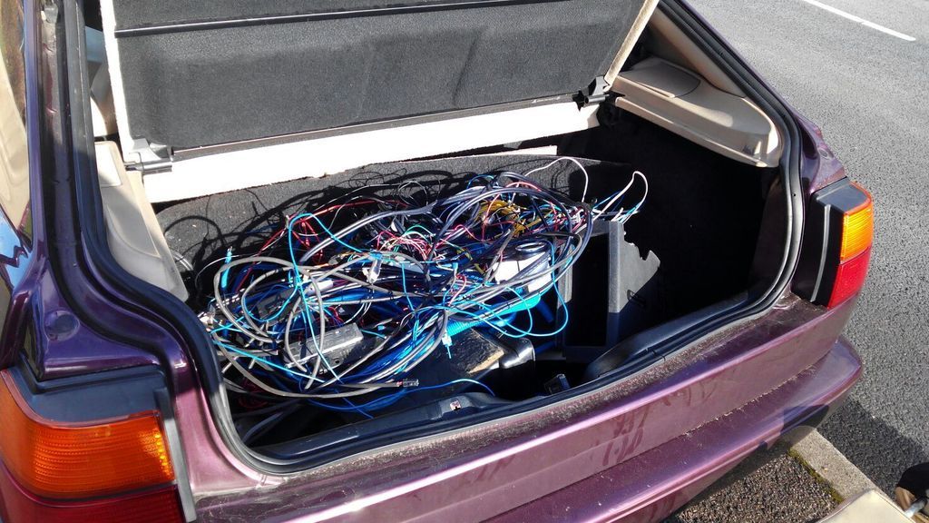

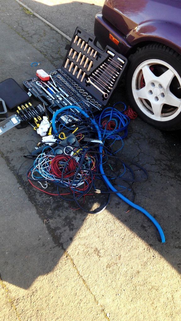

At that point i found a lot of wiring from old audio stuff and i decided to remove every thing, including the subwoofer.
I did the same with the aftermsrket oil temperature and pressure dials installed by the previous owner
This are the results

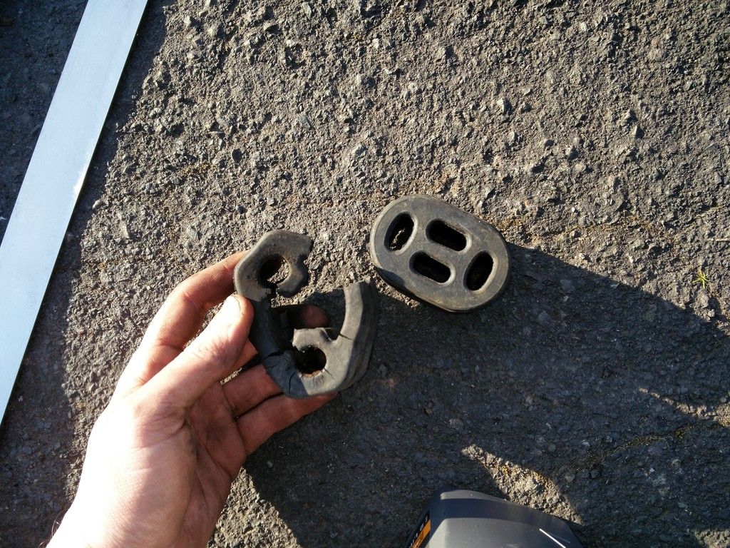

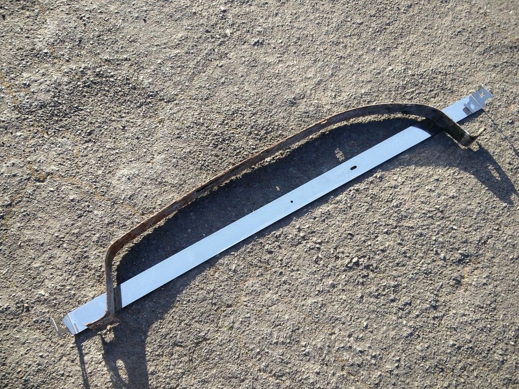

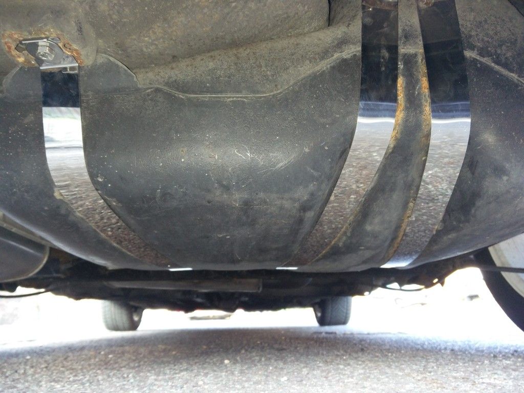

Fuel tank straps were too corroded, so i replaced them by an stainless steel ones
When i was doing it, i noticed that the rear rubber support for the exhaust was already broken, so i was changed as well.

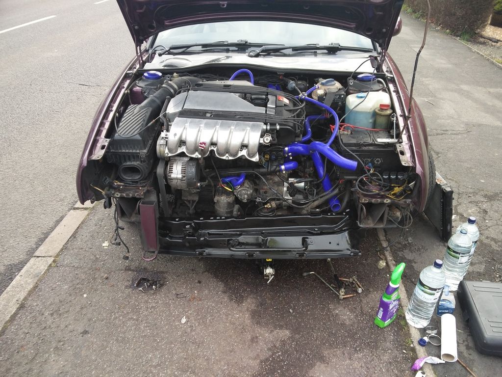

HI all,

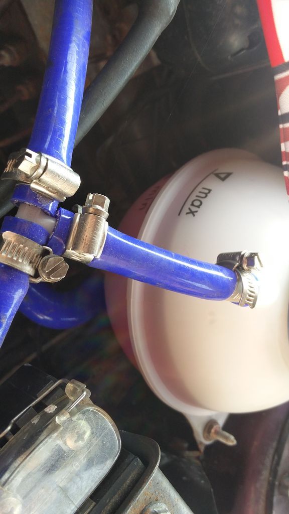

after this i decided to change the thermostat. During the first trip driving back to leamington spa, i noticed that temperature during cruising cool down too much, so i decided to change the thermostat.

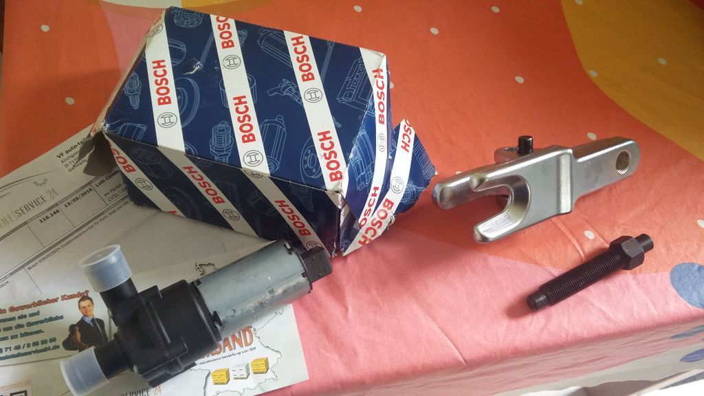

At the same time i changed thermostat and housing, crack pipe, secondary water pum ( it had a leaking) and the expanion bottle.
i washed the radiator several times and elimitate some superficial rusty .
finally i filled up with g12 coolant and now the car runs at 80~90 degrees with no problem
Edited by Luisete

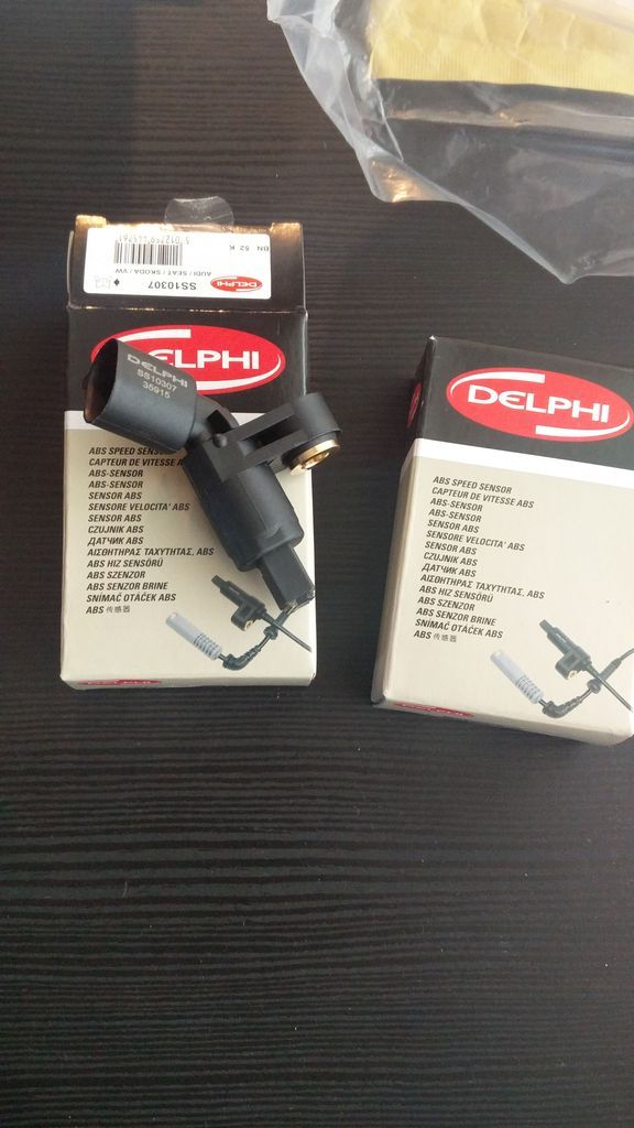

First thing to check... sensors. My suprise was when i saw them damaged. Left side was ok, but the ring was bended an the right one was literally smashed.
I swapped them for delphi ones... and the abs fault is gone!
Abs system is working as it should now for just 16 pounds every sensor.

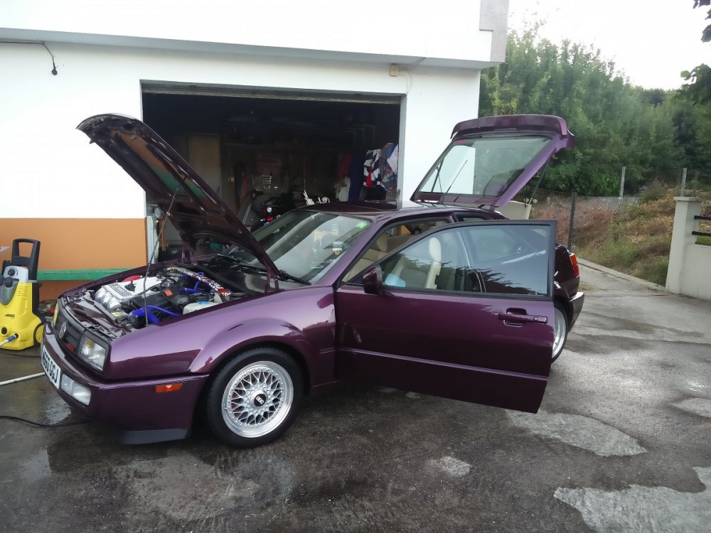

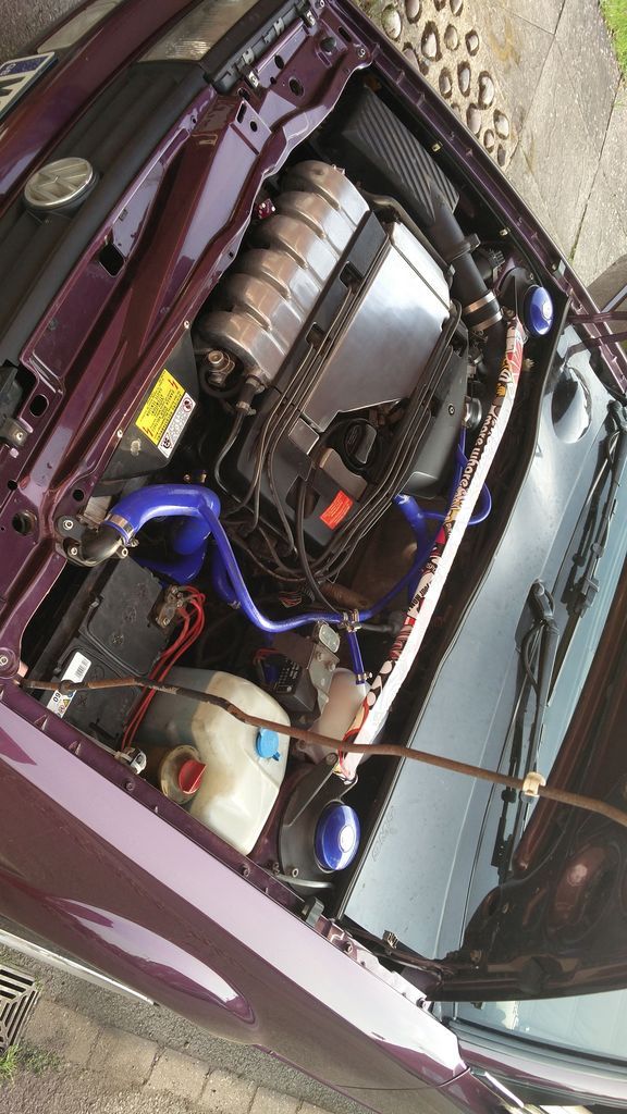

After this i started to clean and polish the engine bay
This picture is when the job was just half done... i'll update the results

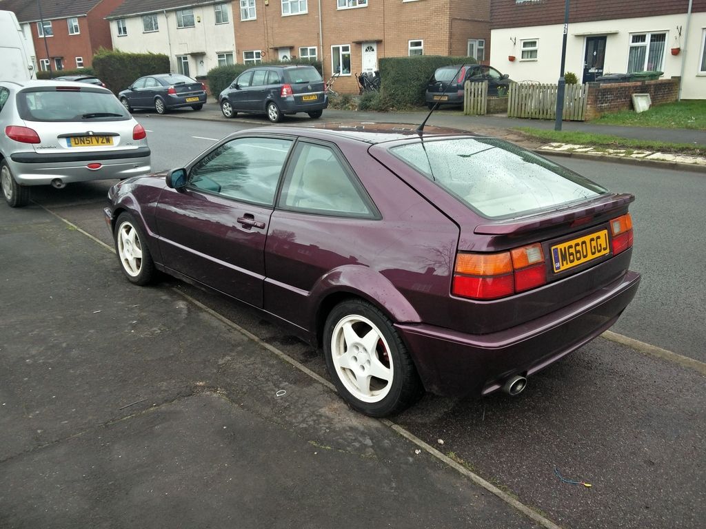

Original bbs rs in 15" where fitted to the car back in 2016.

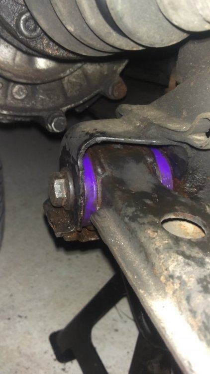

Then  to solve some handling problems the front wishbones were revised. Them where previously polybushed but they where in quite bad condition. Front ones of the wishbone had a lot of play between the bolt and the powerflex cylinder, New Oem bolt and brand new bushes where fitted. For the Wisbone rear ones, the polybushes where swapped by the Oem Lempforder from r32 MK4 ones..
After this mod and steering wheel aligment the handling problem was solved

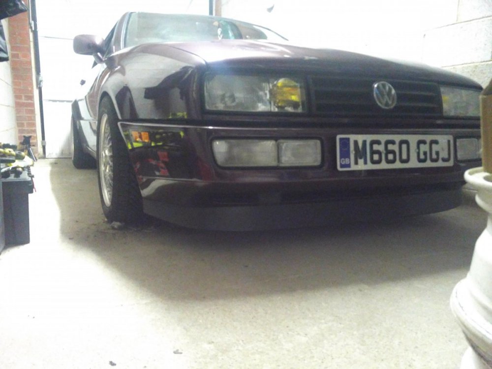

High beam Bulb yellow covers and 90mm Front lip. (I was quite lucky to be able to get this one brand new)

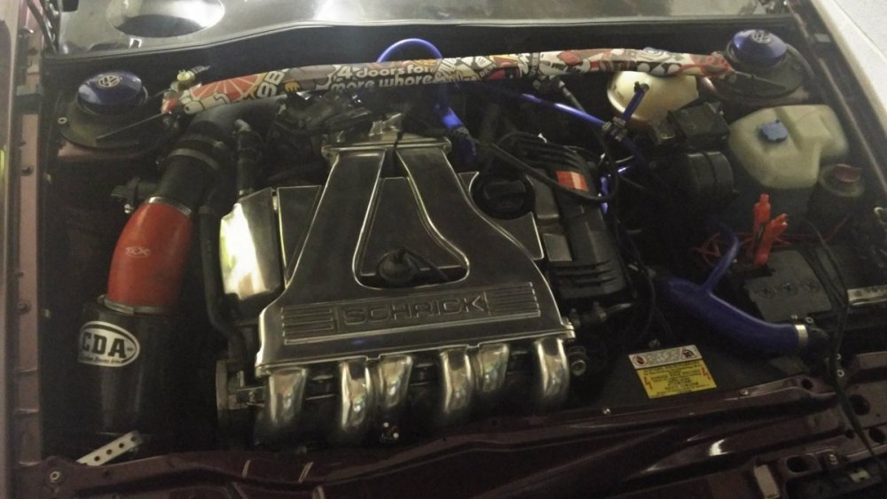

Schrick Manifold Fitted. Bought from a Forum member, ( Very nice guy)
A good friend of mine got rid of his MK5 r32 and gave me the BMC Filter with the silicon hose needed for fitting it to the VR6 MAF. I wasn´t sure if this was a performance inprovement as I fitted it together with the schrick Manifold , but definetely a sound inprovement!
And after a couple of weeks with the manifold I had to visit Vince for a remap to get the most out of the mods

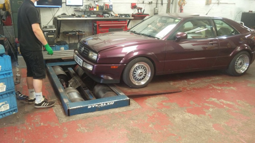

However doing the preflight checklist for remaping, Vince found out the lambda values of the car were wrong and the car was overfueling. That could explain why the car failed the MOT a few weeks before due to high emissions
New Lambda sensor was fitted in place and wiring had to be sorted out as somebody before messed out with the lambda connections.  Once the lambda started firing the right values, the remap was successfully completed
