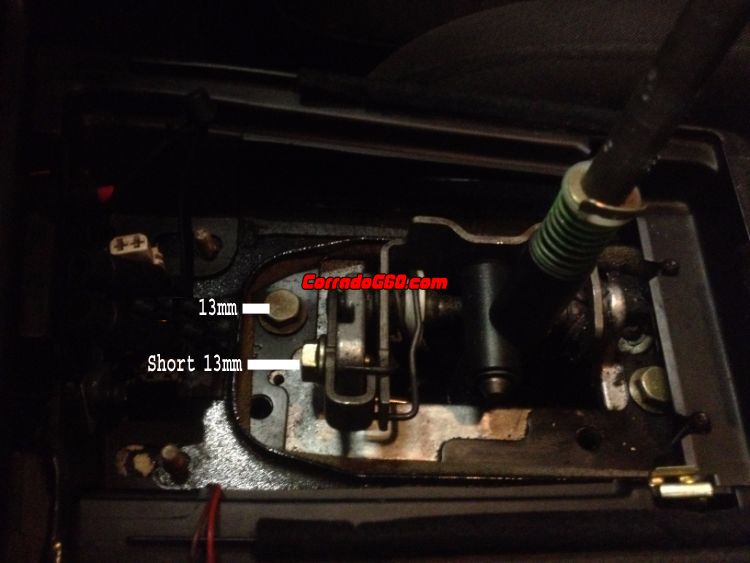

Riley 0 Posted July 20, 2016 (edited) The gear lever end is done via one 13mm bolt pictured here... (The short 13mm). With the car in neutral, mark the two points the bolt passes through (Black thin lever part and thicker silver body). You will see there are two lines/indentations to align, but as parts/bushes wear, you move away from those. Slacken the bolt, and slightly move/hold the gear lever to the left (Or right if you go too far), now nip the bolt up again and test while sat with car running/clutch in. Don't go too tight with the bolt. It's just a case of tweaking it, undo bolt, tweak, undo bolt, tweak. The gearbox end is much the same. And should actually be done with those two indentations lined up (But then if they are worn, you can just try to get it to shift smoothly) Taken from http://www.corradog60.com/viewtopic.php?t=885 Edited July 20, 2016 by Riley Quote Share this post Link to post Share on other sites
