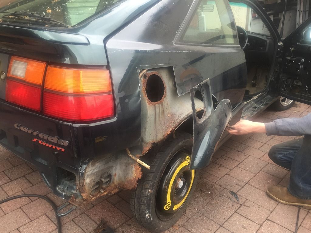

coullstar 0 Posted September 21, 2016 Im trying to remember but how is the rear arch constructed especially around the rear leading edge? I know they are double skinned but at what point does this start? Anybody got a photo of a de-skinned rear arch on passengers side? Just trying to factor in potential repair costs. The area shown circled in the attached photo. Quote Share this post Link to post Share on other sites

Jim Bowen 1 Posted September 21, 2016 I saw this on facebook a short while back, just pinched them from there. Quote Share this post Link to post Share on other sites
coullstar 0 Posted September 21, 2016 Mmm, so it looks like its double skinned almost from the inner lip. Looks like you'd need inner and outer bits repair properly then. Quote Share this post Link to post Share on other sites
easypops 8 Posted September 21, 2016 Here is one of the other side, but Jims picture looks better, as for the repair, you won't really know the condition of the inner arch until you dig deep/cut out the front bit Quote Share this post Link to post Share on other sites
Jim Bowen 1 Posted September 21, 2016 Good excuse to add audi quattro arches and bonnet bulge Quote Share this post Link to post Share on other sites
dragon green 5 Posted September 22, 2016 A crap pic of mine Quote Share this post Link to post Share on other sites
