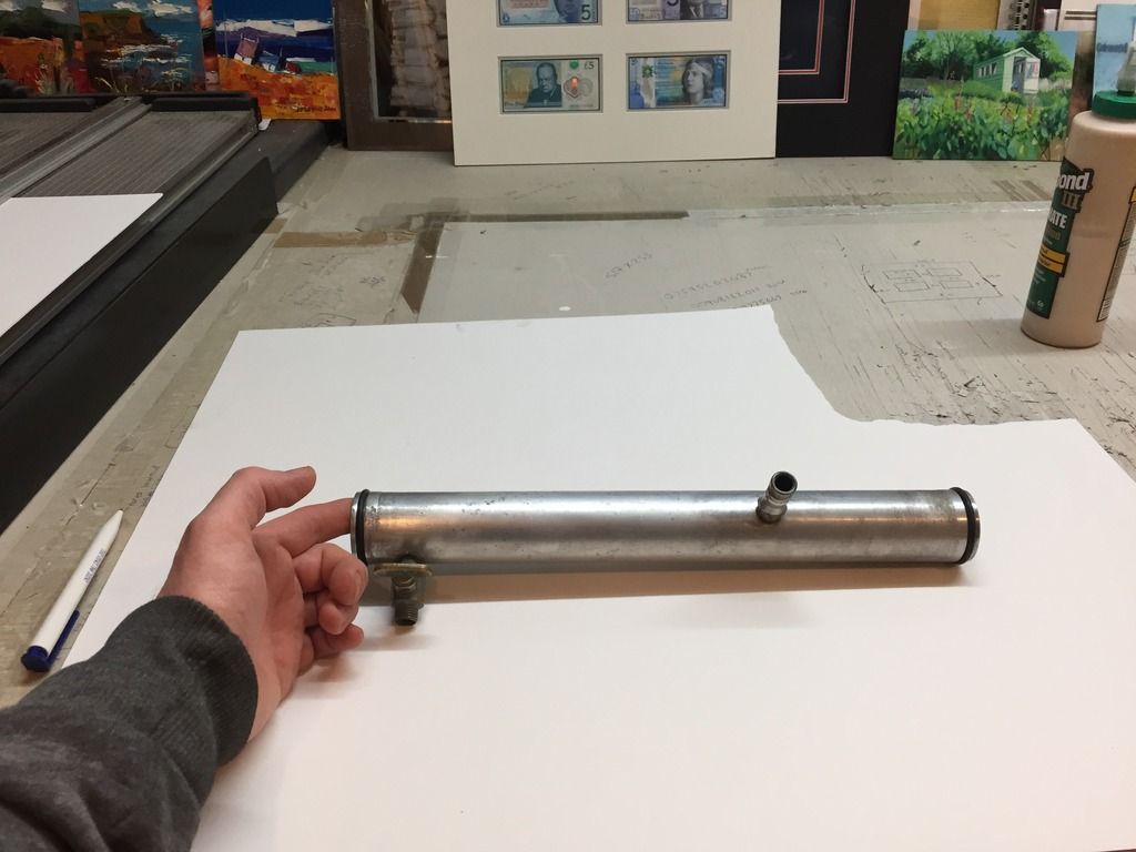

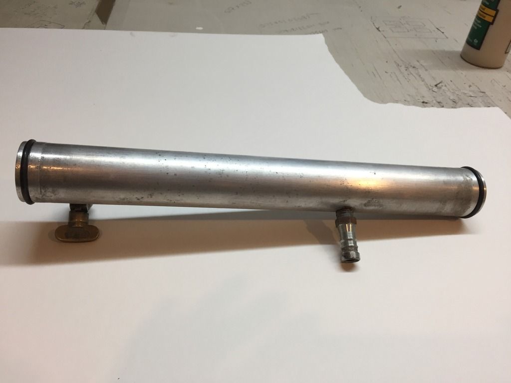

easypops 8 Posted March 8, 2017 There is a metal(possibly aluminium?) replacement, I bought one off here a while back, no idea where it came from originally though, hopefully someone else will know. I'll go and take a picture for you mate Quote Share this post Link to post Share on other sites
easypops 8 Posted March 8, 2017 Here you go mate, it even has a tap at the bottom for easy draining Quote Share this post Link to post Share on other sites
sharpy-vr6 10 Posted March 8, 2017 That's exactly what I'm thinking of. It would great if you or anyone knows where these are available from? Sent from my SM-G930F using Tapatalk Quote Share this post Link to post Share on other sites
easypops 8 Posted March 8, 2017 I bought it from Stonejag, I'd think he will know, maybe worth a PM as I've not seen him on in a while Quote Share this post Link to post Share on other sites
easypops 8 Posted March 8, 2017 Here you go http://www.gruvenparts.com/the-ultimate-crackpipe-all-vr6/ Quote Share this post Link to post Share on other sites
fendervg 33 Posted March 9, 2017 I have one of the Gruvenparts pipes - you'll need to get the mating surfaces and the hole in the block where the pipe fits really clean and smooth before putting it all back together. The drain hole is an allen key screw - quite hard to access though. The OE pipe has a drain plug in the same place as well. There is some debate over whether an alloy pipe really makes much of a difference over the OE plastic, as you don't get to see it and the originals seem to last well over 100K before failure. Quote Share this post Link to post Share on other sites
