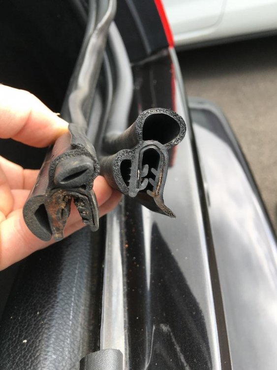

Keyo 47 Posted March 2, 2020 Just now, fendervg said: Yeah, those are the ones. Was wondering if they are per side or light, in which case you'd need 4 to do the lot. Badges are, all have recently been fixed with new blue clips. It's coming out both sides equally.... Yes mate you need four and cut a couple to size- on the part diagram it says sizes. T4 tailgate cut down to size also fits the boot opening an absolute treat. The corrado boot opening seal is obsolete and was a rip off. Here is a new T4 boot opening seal for comparison fitted to my car- If you ever wanted proof that VW load a Part number starting with 535. https://www.ebay.co.uk/itm/VW-T4-TRANSPORTER-TAILGATE-AND-BARN-DOOR-SEAL-T4-REAR-DOOR-SEAL-FIT-ALL-MODELS/324090193145?hash=item4b7547e4f9:g:kn8AAOSwIKNb6t9i Quote Share this post Link to post Share on other sites
