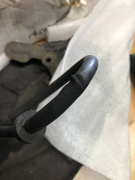

1xshaunx1 27 Posted May 3, 2022 Peddle is a lot better, it was bulging in one area and the sheathing was split at the top end furthest away from the the slave. No nothing to do with gearbox failure that was too much turbo boost and too much grip combined with very rapid clutch drop, all me I’m afraid. I couldn’t see the point in putting it back on the road without sorting that line out, as it was a lot easier to install and bleed with eveything else out of the way. But tbh bleeding was pretty easy. Few pumps on the slave and then the master, 1/2 bottle of fluid and a mate in the car for 10 mins. It’s still fairly easy with the rad and stuff there to bleed, but I had a choice so I waited until I sourced the line. Then put it all back together. one thing that is a lot better is the gear shift, 1st to 2nd and reverse, I spent a bit of time altering where the shift cables go onto the selectors as there is adjustment on the m10 bolts. It was left to tight that needed altering on mine, it’s 10 times better now, I used to have to be careful selecting reverse to avoid gear crunch but miles better now Quote Share this post Link to post Share on other sites

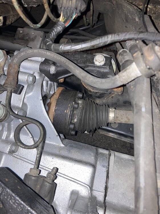

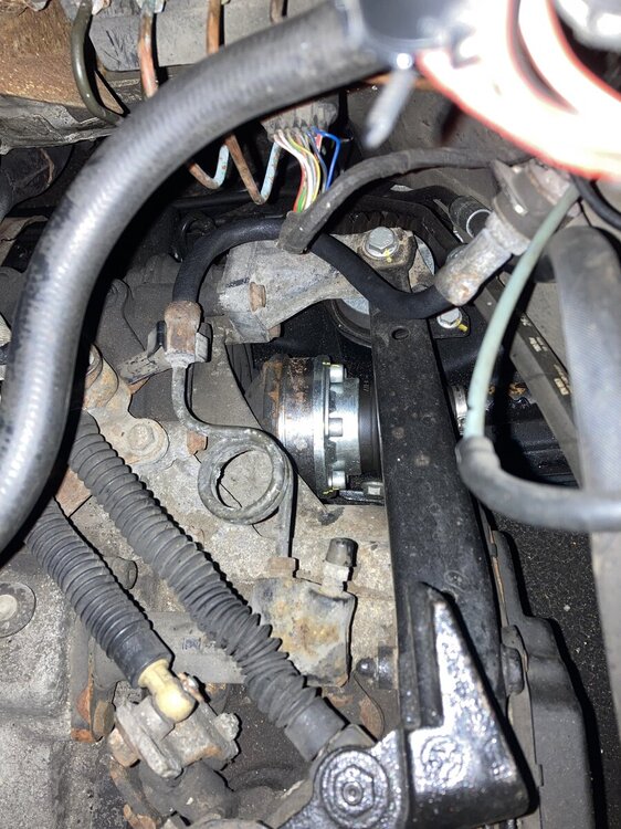

Keyo 47 Posted May 3, 2022 (edited) 26 minutes ago, 1xshaunx1 said: I was going to order one of those, they haven’t had any in stock for god knows how long. To be honest Keyo I was sick of mail ordering crap that didn’t fit, spent nearly £100 on stuff that’s no good. It was refreshing to walk out 10 mins after I walked in with the correct part and having not wasted 2 weeks or any more money. Yes totally makes sense- it might be confusing as etka does not make sense- can anyone make head to tail of this. No 30 on diagram but what about after chassis N 035000 - the goodridge say for a g60 but etka does not define by model just chassis number. Can anyone notice any difference first picture g60 which is goodridge link on etka 357721465a and second vr which etka does not even show a part number - I have a feeling they are the same - late and early for rhd. Edited May 3, 2022 by Keyo Quote Share this post Link to post Share on other sites
1xshaunx1 27 Posted May 3, 2022 I think they are the same, but until you take off and compare you won’t know for sure. you seem to be missing a gearbox bracket on the VR, comes from the gearbox mount towards the front of the car, onto the box ? Quote Share this post Link to post Share on other sites
Keyo 47 Posted May 3, 2022 1 minute ago, 1xshaunx1 said: I think they are the same, but until you take off and compare you won’t know for sure. you seem to be missing a gearbox bracket on the VR, comes from the gearbox mount towards the front of the car, onto the box ? They dont come on 95 cars from factory cutbacks ha . Do you have to bleed anything after ? top up fluid ? Quote Share this post Link to post Share on other sites

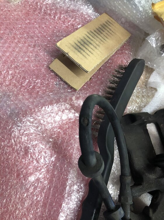

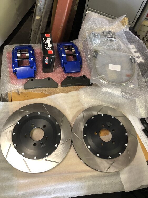

1xshaunx1 27 Posted August 14, 2022 So been thinking of a front brake upgrade for quite sometime, because mine being 30 years old needs an overhaul and I’d rather put the money to an upgrade. So took the plunge and eventually they arrived and I fitted them. Not before time going on what I took off. I cut the big round washer off to use with the new braided lines and here’s what lurked beneath. but they looked alright Quote Share this post Link to post Share on other sites

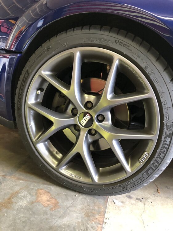

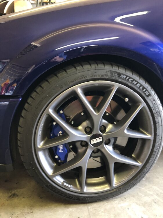

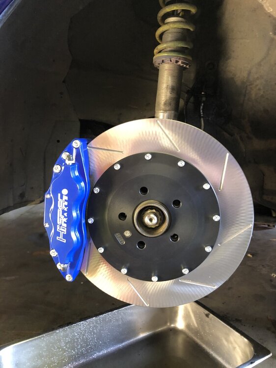

1xshaunx1 27 Posted August 14, 2022 This is what I went for really easy to swap over and much better, but not as neck snapping as I thought, the Brembo discs and ferodo pad combo on my old standard set up was very good though and still a bit more of bedding in to do on the new set up and maybe a full bleed too. That photo doesn’t do justice to the look of the thing though, it looks awesome but not be getting my 15” speedines on any more. Quote Share this post Link to post Share on other sites
Cressa 45 Posted August 14, 2022 Ooooo now they doooo look very nice and necessary with how ridiculously quick your car is. 🙈😂 I take it you sorted out the transmission side of things.. Quote Share this post Link to post Share on other sites
1xshaunx1 27 Posted August 14, 2022 Yes, spare gearbox,new driveshafts and less boost👍😖 Quote Share this post Link to post Share on other sites
g0ldf1ng3r 16 Posted August 14, 2022 2 hours ago, 1xshaunx1 said: This is what I went for really easy to swap over and much better, but not as neck snapping as I thought, the Brembo discs and ferodo pad combo on my old standard set up was very good though and still a bit more of bedding in to do on the new set up and maybe a full bleed too. That photo doesn’t do justice to the look of the thing though, it looks awesome but not be getting my 15” speedines on any more. looking good - are they the 6 pots? ive got the 4 pots from HiSpec & love them 🙂 Quote Share this post Link to post Share on other sites
1xshaunx1 27 Posted August 14, 2022 Yes mate 6 pots with 335 discs Quote Share this post Link to post Share on other sites
g0ldf1ng3r 16 Posted August 14, 2022 1 minute ago, 1xshaunx1 said: Yes mate 6 pots with 335 discs tasty! i went for the 4 pots as had to run the speedline but ive finally got the wheels i want for the VR6 i wonder how much of a bigger disc i could fit under the 16" modena's in comparison to the 15" speedlines - may have to call HiSpec for a chat Quote Share this post Link to post Share on other sites
1xshaunx1 27 Posted August 14, 2022 320 I bet. You’d need new bracket and discs Quote Share this post Link to post Share on other sites
1xshaunx1 27 Posted August 14, 2022 I’ve also got to check I’ve got the right disc on the right side. Having looked at the photos they look like they are side specific as the grooves are going different ways 🤔 Quote Share this post Link to post Share on other sites
g0ldf1ng3r 16 Posted August 14, 2022 52 minutes ago, 1xshaunx1 said: 320 I bet. You’d need new bracket and discs interesting - yes m8 hence the thought as i may refresh discs & pads in the winter when it goes in for the underside refresh in the winter why not go bigger disc if possible eh lol Quote Share this post Link to post Share on other sites
