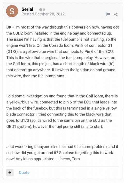

There is only one thing I can’t answer, Pin G/3 on my golf vr6 loom has a short black wire that does nothing. On the corrado loom, pin G/3 corresponds to pin 6 on the ecu plug-Fuel pump relay turn on. The golf loom has the same colour of wire at pin 6 yellow/blue, but on the golf loom it ends in a plug. Logic says remove the black and replace with the yellow/blue pin 6 to G/3?
But I read this from the very guide on here, which basically kills that idea.

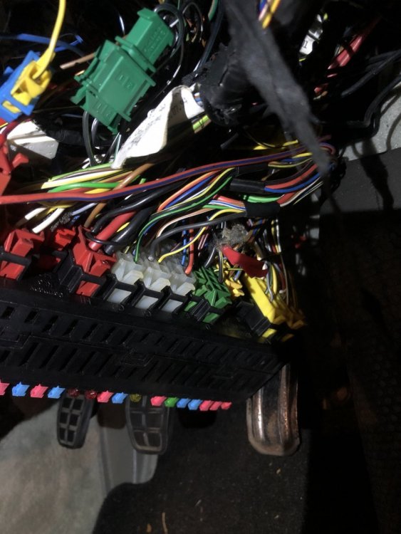

The yellow/blue wire with the black plug in my picture 100% goes to pin 6 on the ecu plug
Sorry, bum steer there! That must have been a new record for me getting the fuse box out and back in again as well as opening the ECU plug to check the wiring just to find that I was mistaken earlier and when I'm not laid in the footwell looking in a mirror the wire in G1/3 turns out to be Yellow/Blue and goes directly to T68/6 at the ECU. The black wire is in G1/4 and that goes to the coil pack on the wiring diagram.See photo for confirmation.
All goes to confirm that the wire you're looking at from the ECU should be connected there, I don't suppose the donor Golf had an immobiliser fitted that was wired into the fuel pump?

That is exactly what I was hoping to see. I really can’t remember as I took the loom out the golf way back when you did your swap. I bought the golf as a non runner as I only wanted it for the OBD2 and Teves20 stuff. I know I didn’t cut that black wire but an immobiliser would make sense.
Anyway, I’ve now put it where yours is 👍😁
No problem Martin, glad to be able to help, lets hope it does the job now. There must have been another issue in the post you put up last night from Serial that was keeping the ECU from switching the fuel pump.

Hopefully mate, I actually messaged him about it a while ago, however he said he couldn’t remember how he sorted it but assured me it’s a worthwhile upgrade.
