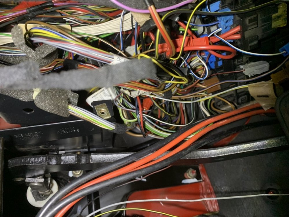

I’ll get you a couple of pictures mate, my fuse box is still hanging loose and I’m sure that bit is still there
  On 5/17/2020 at 2:20 PM, fla said:
Appreciated, thanks

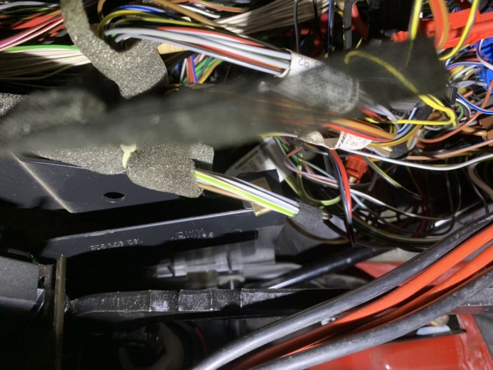

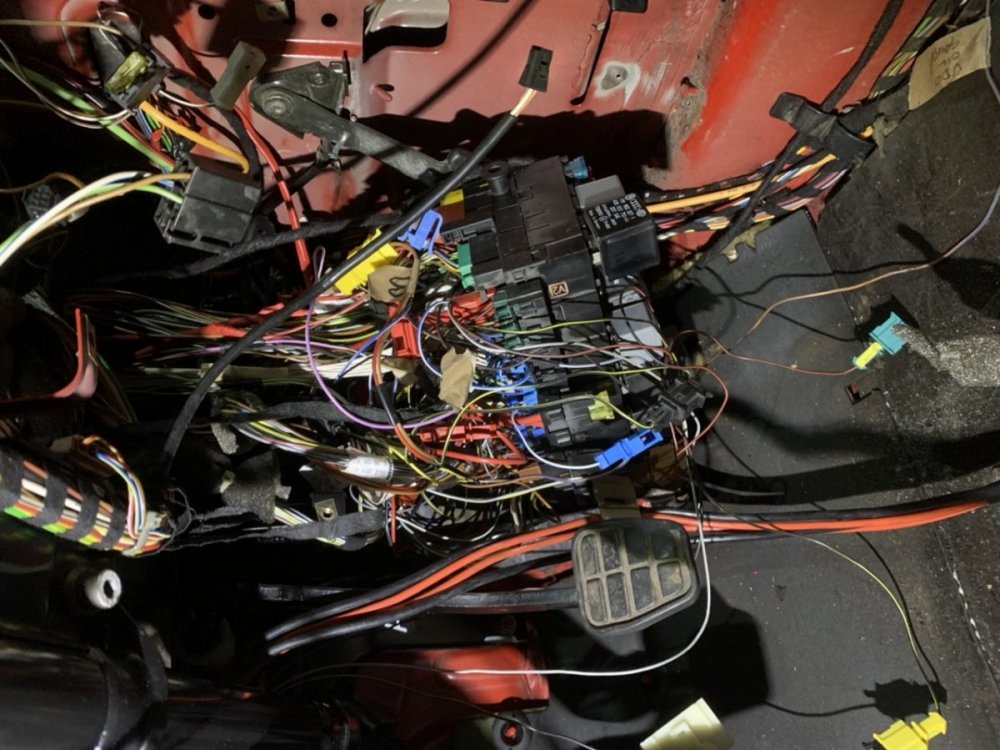

Not the easiest to get a picture of, it sits just to the right of the brake pedal if that helps you locate it. You can see the brake pedal switch just above it
Thanks Martin.  So does it slot on the pedal box or elsewhere?  Not a problem if you cant picture, i can just about see where it sits. I've been trying to fit it to the side of the fuse box but couldn't find anything to clip it to!
Hasan
fitted!  Pics were a great help.  It slots in at the top in the side opening of the fuse bracket and towards the front on the pedal box lip edge.  Its not a super tight fit so it it rattles around i'll put some felt padding in there.
