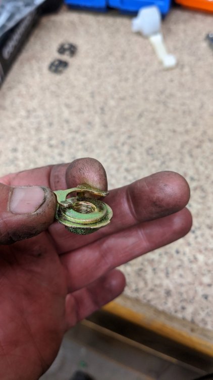

Keyo 49 Posted May 24, 2020 On 5/24/2020 at 12:36 PM, seanl82 said: Can anyone identify this, and know where it goes please!? Must be an internal part because it looks new - Quote Share this post Link to post Share on other sites
seanl82 23 Posted May 24, 2020 On 5/24/2020 at 9:53 PM, Keyo said: Yeah I've fitted them already thanks Quote Share this post Link to post Share on other sites
seanl82 23 Posted May 24, 2020 On 5/24/2020 at 9:59 PM, Keyo said: Must be an internal part because it looks new - No I had it electroplated with a load of other fixings after I removed it Quote Share this post Link to post Share on other sites
seanl82 23 Posted May 24, 2020 On 5/24/2020 at 9:56 PM, easypops said: Ok mate, I’ll look again 😁👍 Haha, legend! Have a look around the trailing edge of the rear axle if you can Martin. I'm sure it was around that area somewhere but I can't see it on any diagram. Could have been to sort a previously stripped thread maybe.... Not come across any yet though. 🤔 Quote Share this post Link to post Share on other sites
easypops 8 Posted May 24, 2020 On 5/24/2020 at 10:10 PM, seanl82 said: Haha, legend! Have a look around the trailing edge of the rear axle if you can Martin. I'm sure it was around that area somewhere but I can't see it on any diagram. Could have been to sort a previously stripped thread maybe.... Not come across any yet though. 🤔 Did you get it plated? or is that the original colour? I keep thinking seatbelt when i look at it? What size is the thread, looks fairly substancial Quote Share this post Link to post Share on other sites
seanl82 23 Posted May 24, 2020 On 5/24/2020 at 10:24 PM, easypops said: Did you get it plated? or is that the original colour? I keep thinking seatbelt when i look at it? What size is the thread, looks fairly substancial Yeah it's been plated. It's an M8 collared nut inside a retaining/captive clip. Quote Share this post Link to post Share on other sites
James. 9 Posted May 24, 2020 (edited) Ohh I love these. First picture is the captive nut from the brake compensator spring. Is there a prize ? Edited May 24, 2020 by James. Quote Share this post Link to post Share on other sites
easypops 8 Posted May 24, 2020 On 5/24/2020 at 10:31 PM, James. said: Ohh I love these. First picture is the captive nut from the brake compensator spring. And that's why I couldn't find it as I've done away with the bias valve thingy. Well done James Quote Share this post Link to post Share on other sites
seanl82 23 Posted May 24, 2020 On 5/24/2020 at 10:31 PM, James. said: Ohh I love these. First picture is the captive nut from the brake compensator spring. James, you're a star! It's not on any of the diagrams either. Thanks mate, really appreciate it! 👍 Quote Share this post Link to post Share on other sites
James. 9 Posted May 24, 2020 My pleasure. Bank holiday job ready and waiting ! Quote Share this post Link to post Share on other sites

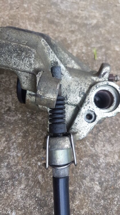

twinbeltg60 3 Posted June 1, 2023 On 5/24/2020 at 6:57 PM, seanl82 said: Thanks mate. Yeah looks like those are identified then. Not sure why I have a different type. No idea what the other one is in the first pic though...... Hi, Only noticed this, and so you may have corrected this already, but I just thought you should know the handbrake cable clip shown in the picture is not fitted correctly, it will not hold anything on, the clip horsehoe end should butt up against the cable metal collar, and the end "legs" should clip over the caliper internal bracket where the cable passes through, see pic of my yet to be rebuilt caliper for ref. Cheers. Quote Share this post Link to post Share on other sites
gotvach 10 Posted June 1, 2023 On 6/1/2023 at 4:32 PM, twinbeltg60 said: Hi, Only noticed this, and so you may have corrected this already, but I just thought you should know the handbrake cable clip shown in the picture is not fitted correctly, it will not hold anything on, the clip horsehoe end should butt up against the cable metal collar, and the end "legs" should clip over the caliper internal bracket where the cable passes through, see pic of my yet to be rebuilt caliper for ref. Cheers. I shall have to fix that! Looking at it again with fresh eyes I can see now that the curves suggest it should be either side of the hole. Thanks for letting me know. Went through an MOT like that too. Quote Share this post Link to post Share on other sites
