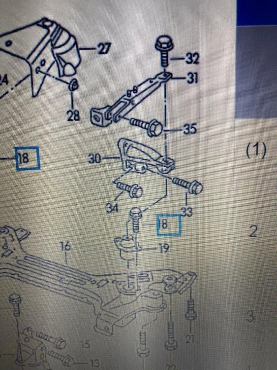

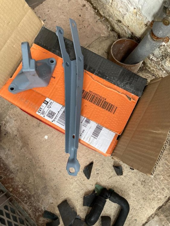

I have purchased a used 02A  gearbox to start building up the 5 th and 6 th gear add on - means I can swap the boxes out and keep one original  and only have the car at stealth for one day. .

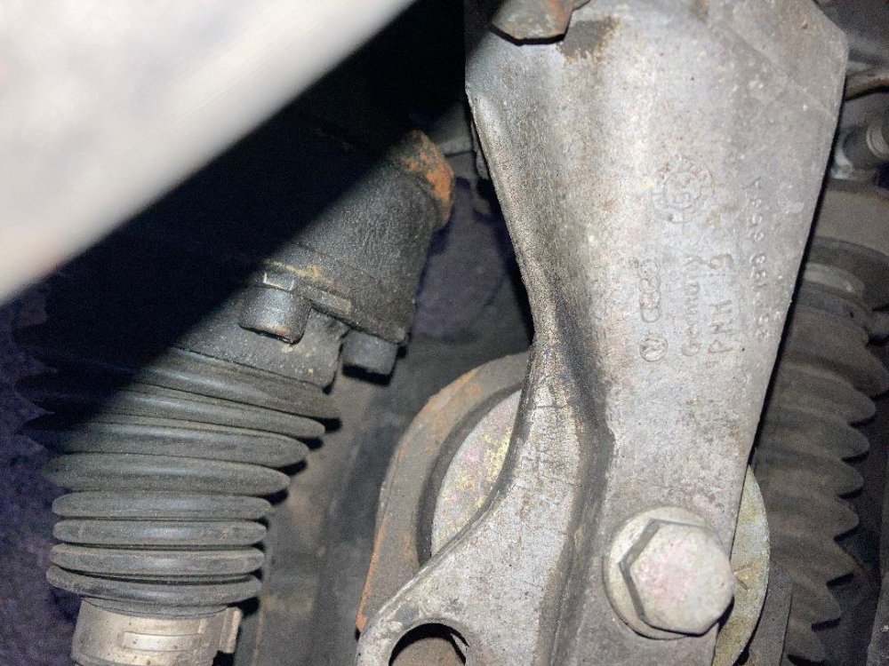

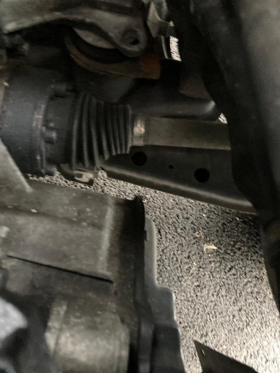

My question is this long bracket came with the box and I cant see one on my box- is it meant to be on my car- my car is a 95  . Shall I fit it when I put the box on - looks like a good bit of extra support.
Thanks
Bracket No 31 on diagram and pictures of it missing on my rear right engine / gearbox mount.

Ooo I will check mine tomorrow to see if it has that fitted and let you know 🧐
Thanks I dont believe late cars have it fitted but could be wrong.
Also is ATE the oe manufacturer for slave cylinder ?  I see TRW are available to who from my experience are a quality oe brand.
Thanks
Mine is a late car and doesn't have the long bracket. I also noticed it in the Bentley and wondered what it was for!
