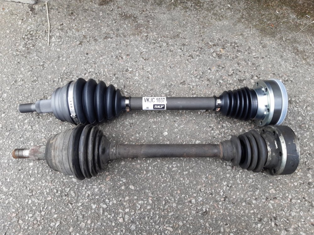

Ostkakan 11 Posted July 24, 2021 Update. Changed right driveshaft today, the old one fall in to pieces when it got removed 🙈 I still have some knocking sound, I found out left driveshaft have some play when i push it out and in. The left shaft is new. Should that be any play? Quote Share this post Link to post Share on other sites
Dox 23 Posted July 24, 2021 Push in towards the gearbox, pull out towards the hub? Yes, the shaft has to lengthen and contract as the suspension elongates and compresses. The distance between the gearbox and hub varies in use Quote Share this post Link to post Share on other sites
Ostkakan 11 Posted July 24, 2021 Just now, Dox said: Push in towards the gearbox, pull out towards the hub? Yes, the shaft has to lengthen and contract as the suspension elongates and compresses. The distance between the gearbox and hub varies in use I dont see it pull out towards the hub, it feels more on the inner cv/gearbox moves. When i push it i have a play for like 5mm, i dont have any play on the right side. I think to remove the shaft tomorrow and check it out. Quote Share this post Link to post Share on other sites
Dox 23 Posted July 24, 2021 Its the inner CV that has length adjustment, in out is fine, up / down /around is bad Quote Share this post Link to post Share on other sites
Ostkakan 11 Posted July 24, 2021 25 minutes ago, Dox said: Its the inner CV that has length adjustment, in out is fine, up / down /around is bad Okej, thats wired that it still have knocking/ticking... Quote Share this post Link to post Share on other sites
Dox 23 Posted July 24, 2021 Just now, Ostkakan said: Okej, thats wired that it still have knocking/ticking... It could still be faulty, just in / out is not a sign of a faulty joint Quote Share this post Link to post Share on other sites
Ostkakan 11 Posted July 24, 2021 1 hour ago, Dox said: It could still be faulty, just in / out is not a sign of a faulty joint Okej thanks. Would be super bad luck with new and faulty joint Quote Share this post Link to post Share on other sites
1xshaunx1 27 Posted July 25, 2021 13 hours ago, Ostkakan said: Okej thanks. Would be super bad luck with new and faulty joint It happens sometimes unfortunately and can’t be discounted Quote Share this post Link to post Share on other sites
