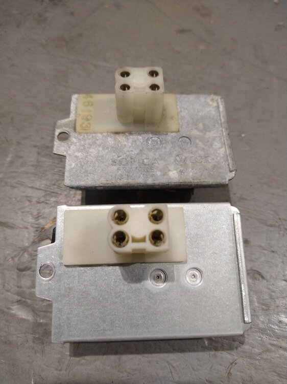

Crasher 3 Posted September 26, 2022 The four speed right hand drive resistor 536 959 263 is not available aftermarket anywhere, the Febi resistor part number 19770 is 3 speed but if that is what you have used it should not be possible to plug it in as the centre pin is blank and won't accept the plug with five pins installed. Quote Share this post Link to post Share on other sites

Crasher 3 Posted September 27, 2022 What was the FEBI part number? Can you post a picture of the connector? Quote Share this post Link to post Share on other sites

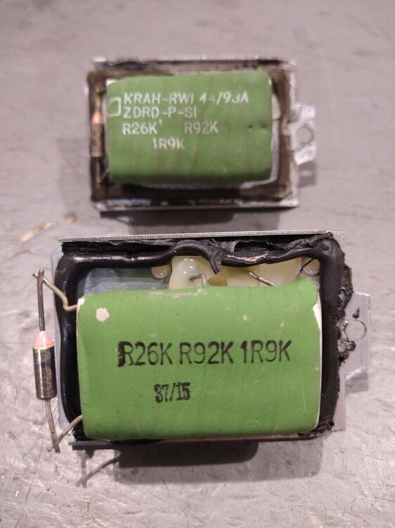

ABV-VR6 12 Posted September 27, 2022 It was this one Quote Share this post Link to post Share on other sites
