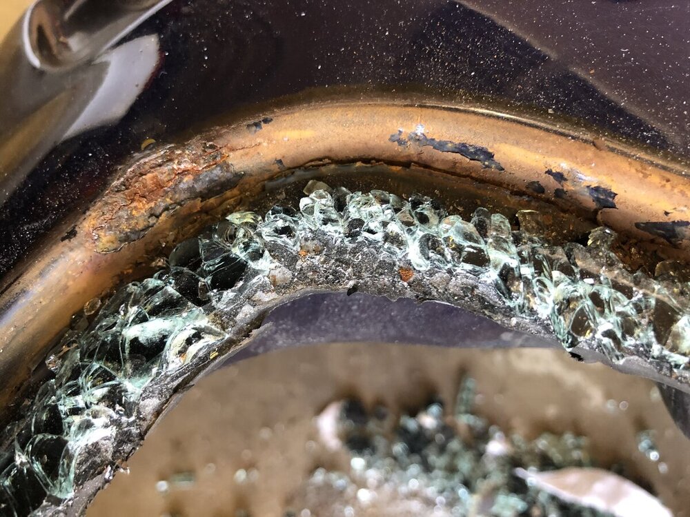

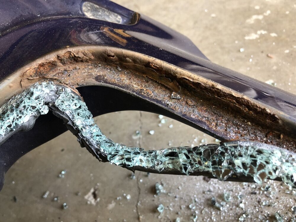

1xshaunx1 27 Posted January 16, 2023 I’ve posted these photos before somewhere but can’t find it. As you can see when I broke the glass you could just pull the rest away. No bonding going on just rust eating away under the seal and water finding somewhere dry to go. it’s amazing the damage that might lurk behind a screen that’s had a removal without some proper paint being applied before refitting the screen . The rubber that goes around the screen can hide an awful lot of mischief. Any sign of bubbling under any glass or window seals needs investigating before it gets too much for a cheap scrub and lick of paint to rectify. Leaving it can mean thousands instead of hundreds of well earned Pounds. Quote Share this post Link to post Share on other sites
fla 9 Posted January 16, 2023 Thats pretty serious Shaun, thanks for posting, great picture, certainly gives a lot of detail. Did you have new metal welded in? How did the body shop ensure all the old sealant was removed? Quote Share this post Link to post Share on other sites
1xshaunx1 27 Posted January 16, 2023 Sharp knife and wire wheel I think. Those pictures are of the old hatch though which was replaced. Quote Share this post Link to post Share on other sites
