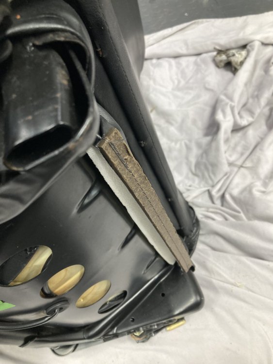

ChrisL 16 Posted December 9, 2023 Does anyone know how the seat base material secures at the back of the seat base please? The leather is fastened to a strip of wood that looks to push into a slot but it just pops out. Quote Share this post Link to post Share on other sites
tonedef 8 Posted December 10, 2023 I can’t remember exactly and I’m offshore so can’t look at mine, but if it’s like others I’ve done you roll the “strip of wood” half a turn inside the leather (if that makes sense) before pushing it into the slot. That way it doesn’t pull straight out again. Quote Share this post Link to post Share on other sites
