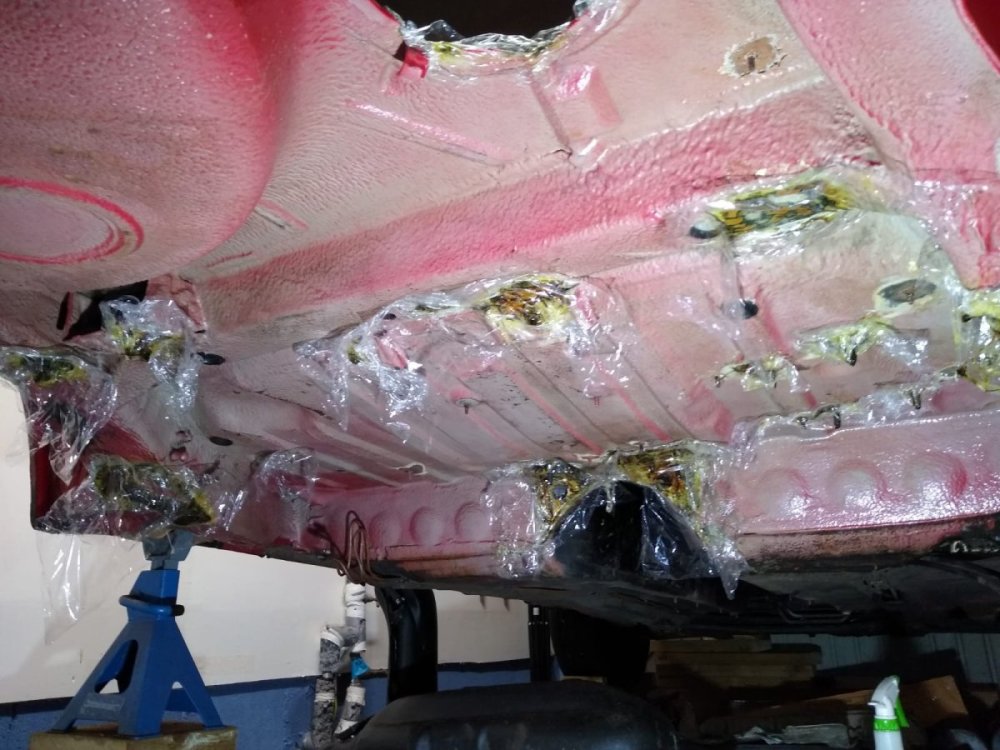

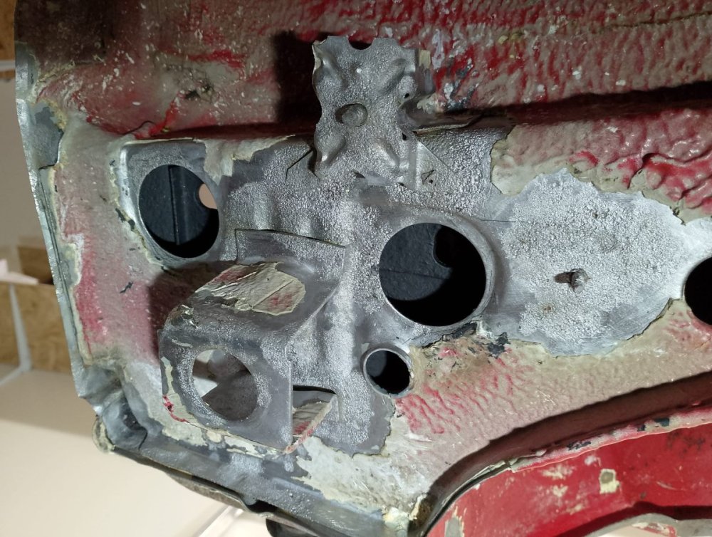

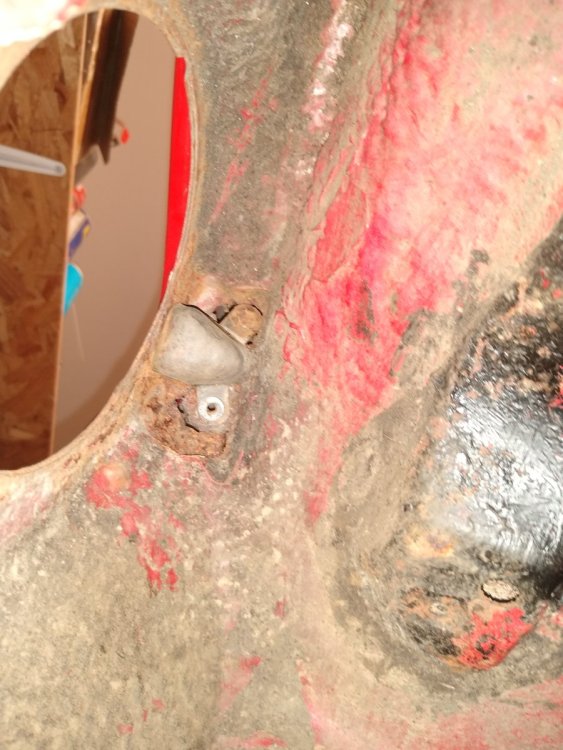

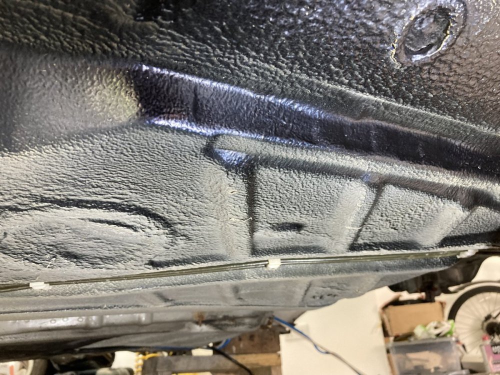

Wild-Animal 2 Posted January 31, 2024 Hi all, Had the vehicle for 13 years this year... sitting in a storage for about 10 years, I hadn't started it in 6 years. Some fresh fuel... and it started first turn of the key - couldnt believe it. That decided the fate of the car - it had to be kept. I now have the space to work on it again. My plan is to get the whole underside sorted, fix all the rust and clean the underside ... it is proving to be a big job. These cars are very well undersealed from factory, but with the dirt and moisture in the UK and if its not cleaned, its inevitable.... rust The bits of rust that I am not cutting out, I am treating it with a rust remover. Really recomend the Bilt Hammer Products. Surfex HD for removing all the grime on the underside, you mix this with water as per your requirements. And the Deox-Gel for removing rust. I am putting the Deox-Gel on multiple times to remove the pitted rust. Its gonna be a long road to get this all cleaned up, and new metal put in. Quote Share this post Link to post Share on other sites

Wild-Animal 2 Posted February 1, 2024 thanks ChrisL, if you have any other products/ recomendations - I am all ears! I am currently using a brass brush the size of a toothbrush and srubbing the underside with the Surfex HD, then wiping with sponge kitchen scrubers. Quote Share this post Link to post Share on other sites
ChrisL 20 Posted February 1, 2024 I used a toothbrush with surfex HD almost neat then used white spirit as well. Quote Share this post Link to post Share on other sites
Wild-Animal 2 Posted February 1, 2024 thanks Chris! its good to get inspiration. Ah, almost neat.... my mixtures measures are getting stronger each time - seems to be better for getting the stuff off. Yours looks great, nice work, I bet it was a good feeling once it was done. Quote Share this post Link to post Share on other sites

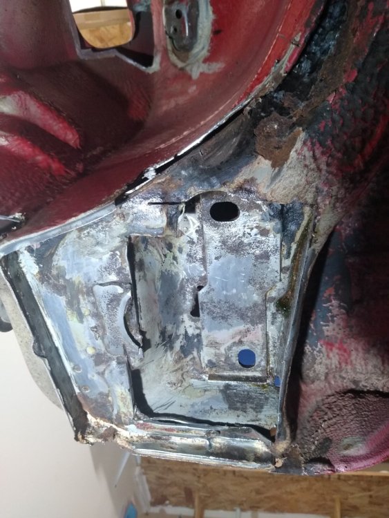

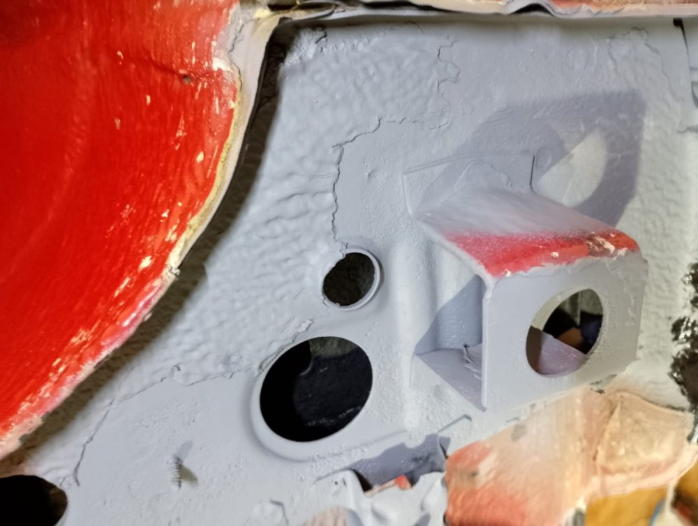

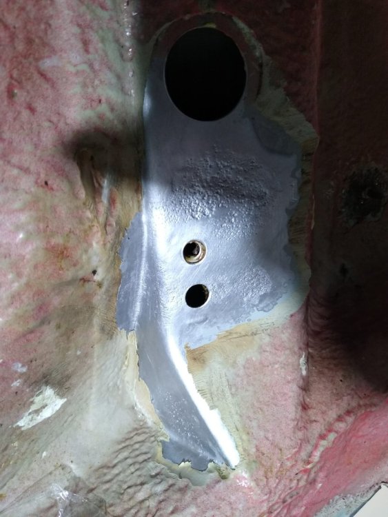

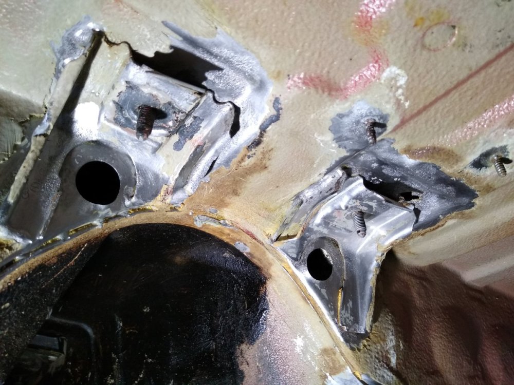

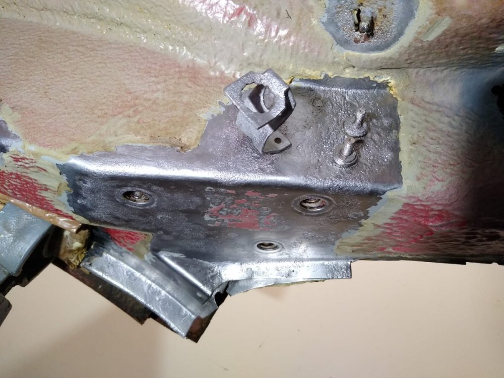

Wild-Animal 2 Posted February 16, 2024 Making some progress. I have been having sucess with the Deox-Gel to get back to the bare metal, I even managed to get some primer on in a couple of spots! slow progress.... Quote Share this post Link to post Share on other sites

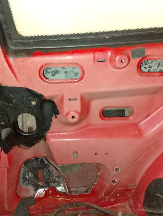

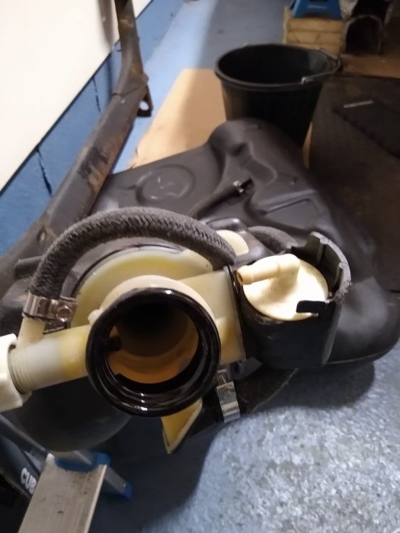

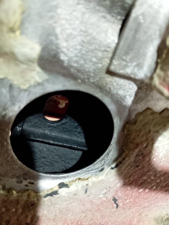

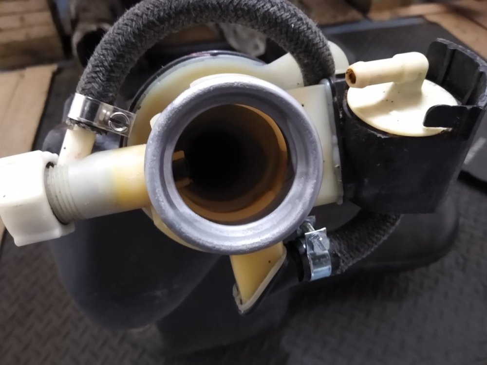

Wild-Animal 2 Posted February 19, 2024 I got the tank return lines replaced. Also removed all the rust and paint off the metal filler neck and painted with an enamel paint. Quote Share this post Link to post Share on other sites

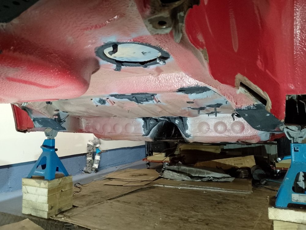

Wild-Animal 2 Posted February 28, 2024 Some more progress Quote Share this post Link to post Share on other sites

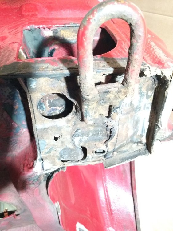

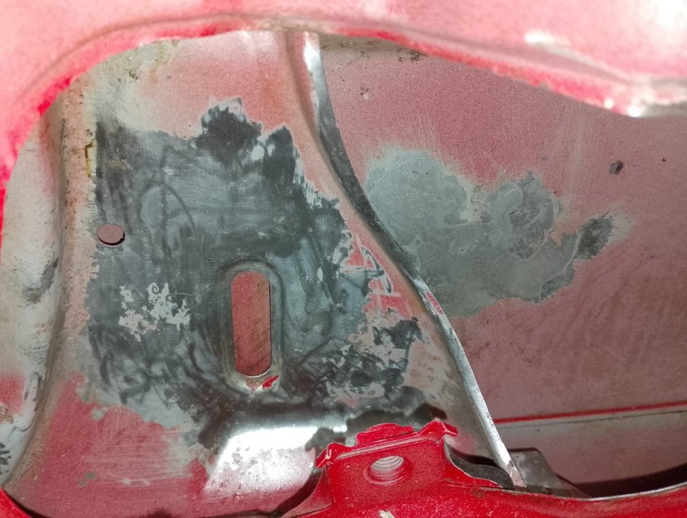

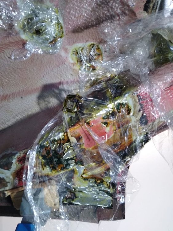

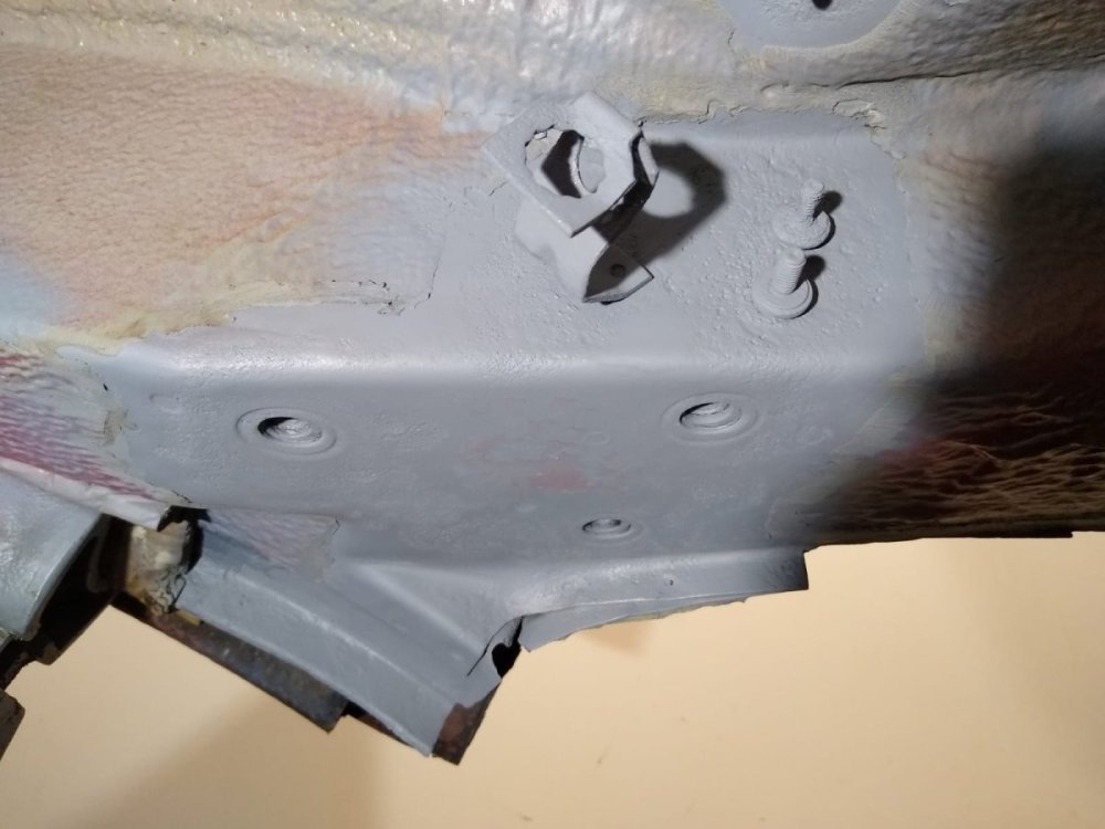

Wild-Animal 2 Posted April 13, 2024 (edited) Slowly making progress ...... removing all the rust with the Deox Gel on the underside. Gravity is not in your favor so it takes about 7 goes with any steel that is pitted. If you want to remove all the rust. Edited April 13, 2024 by Wild-Animal Quote Share this post Link to post Share on other sites

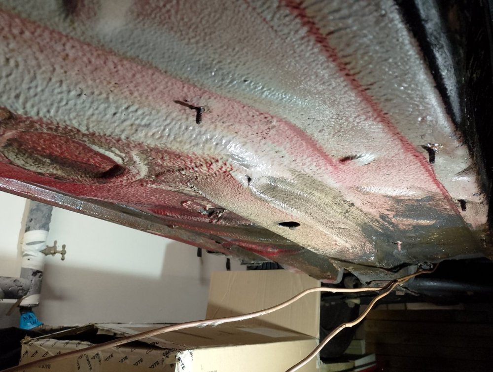

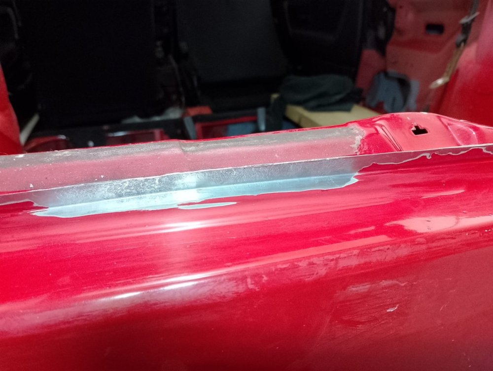

Wild-Animal 2 Posted April 13, 2024 (edited) A spot of spring cleaning down the sill, since I have access. Edited April 13, 2024 by Wild-Animal Quote Share this post Link to post Share on other sites

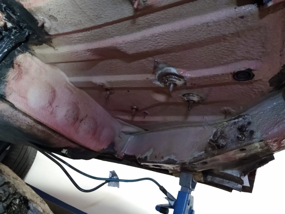

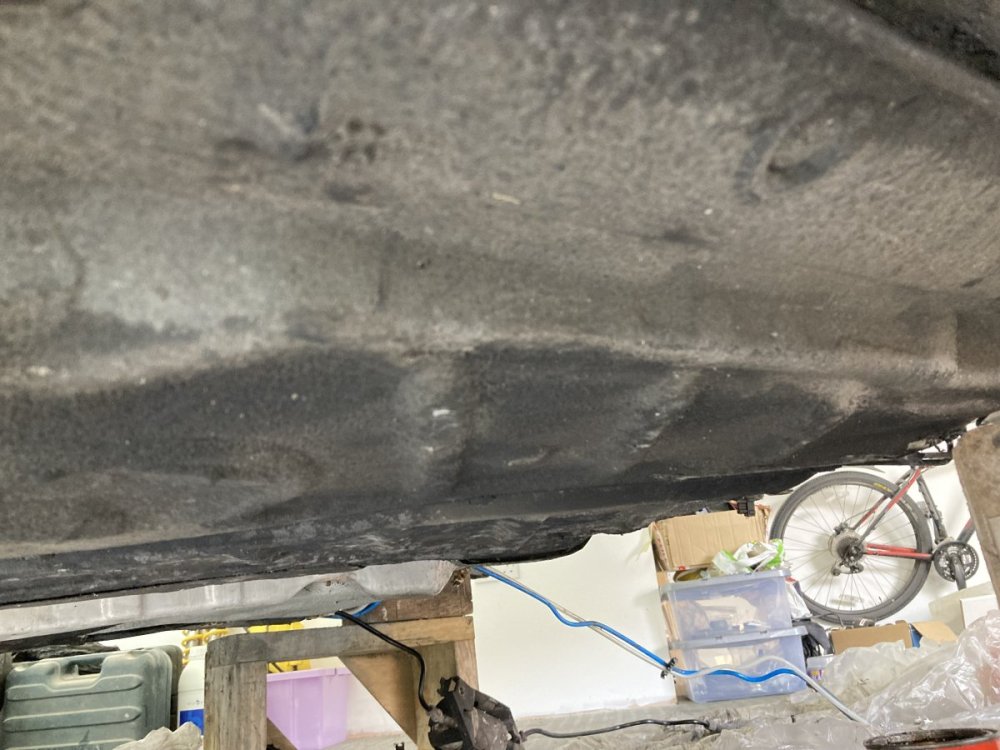

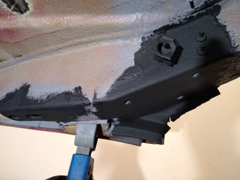

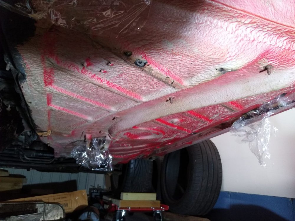

Wild-Animal 2 Posted August 8, 2024 (edited) Progress has been slow. Another area complete..... back to bare metal. With rust thats on the underside of the car, it takes about 8 applications of the DEOX Gel to remove it. As gravity ends up fighting you. Edited August 11, 2024 by Wild-Animal Quote Share this post Link to post Share on other sites

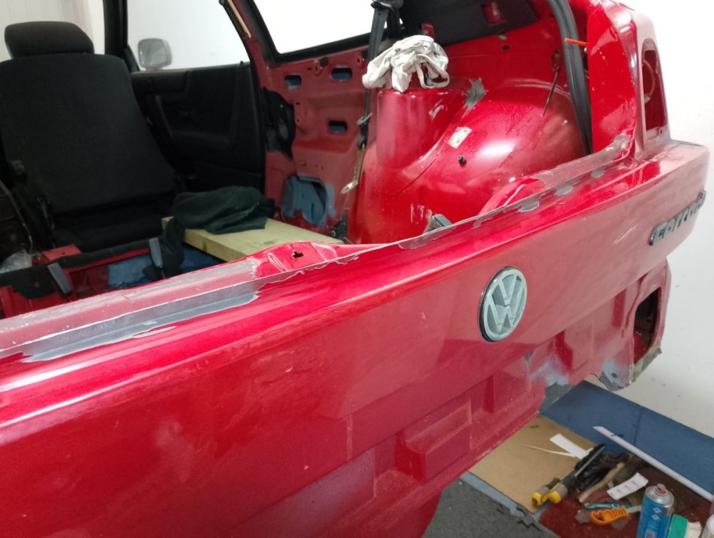

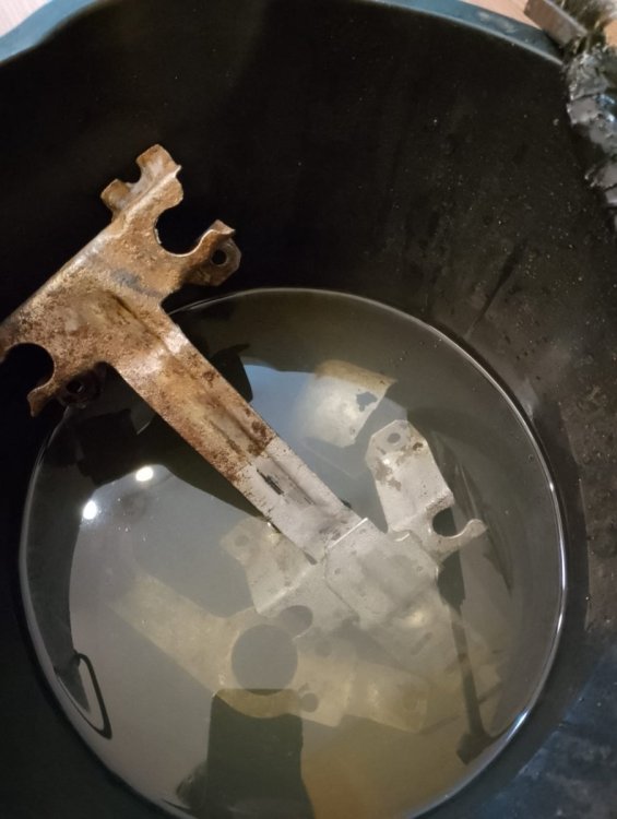

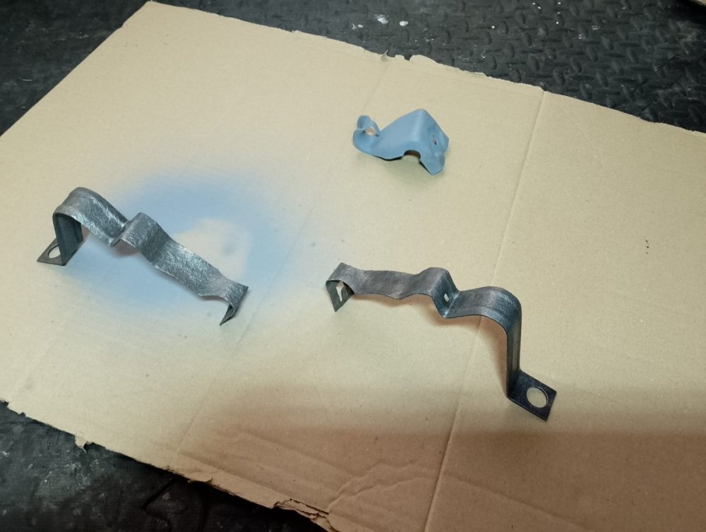

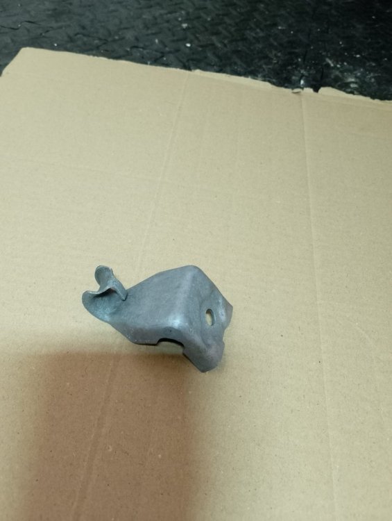

Wild-Animal 2 Posted February 23, 2025 Some more progress .... I have been managing to get all the rust of the parts, and even a bit of paint put on. The evapourust is great for small parts, take the loose stuff off and leave it in a bucket for a few days. 1 Quote Share this post Link to post Share on other sites

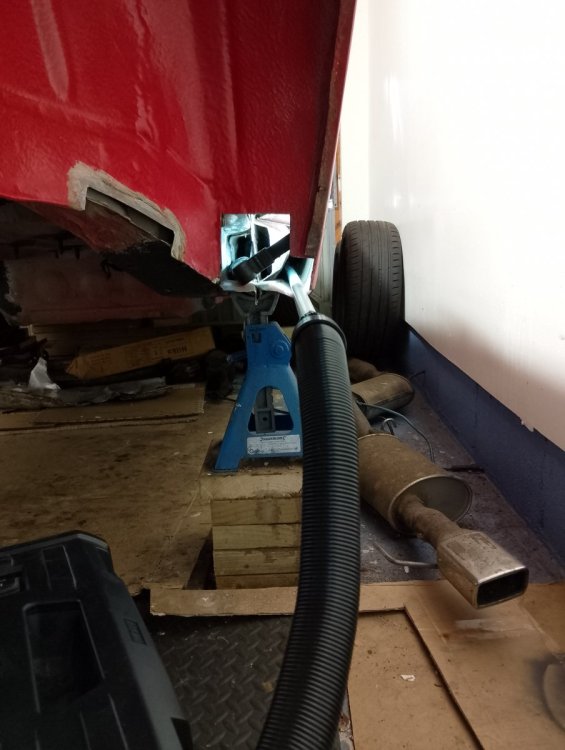

Wild-Animal 2 Posted December 21, 2025 The journey continues .... boy is it taking some time. I finally got to some welding. 1 Quote Share this post Link to post Share on other sites
