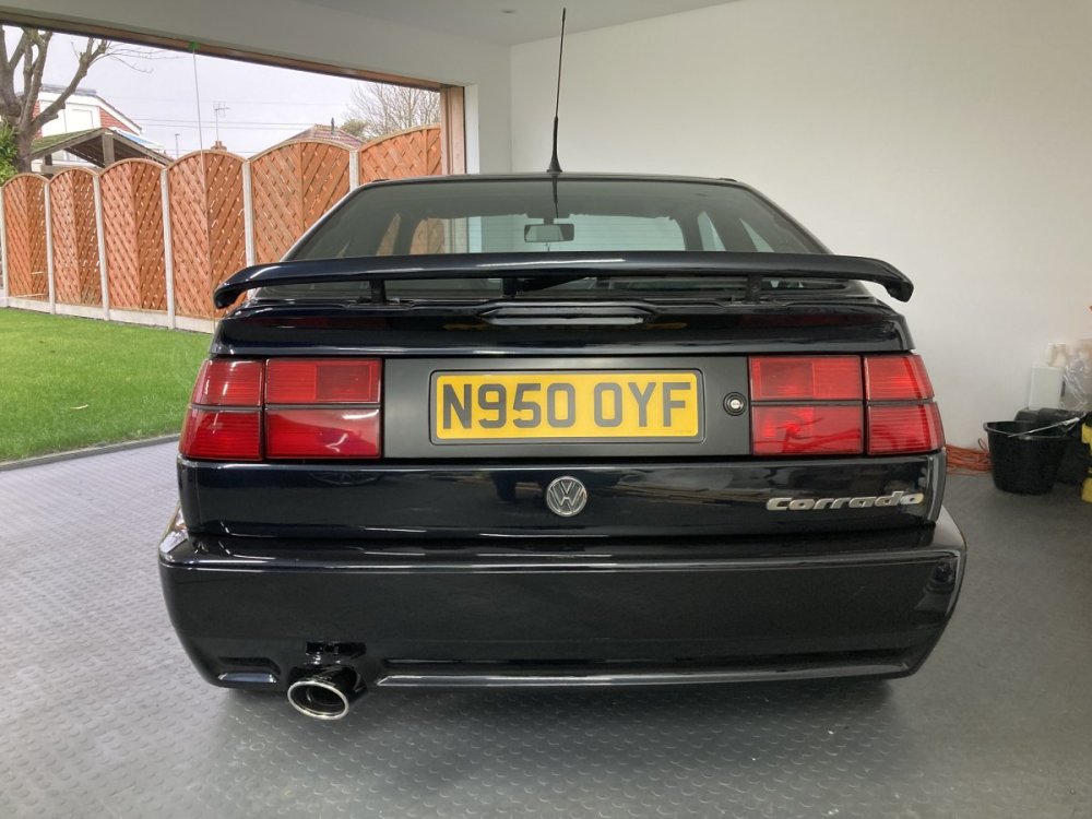

I’ve got a supersprint system. Not a massive tailpipe but it does sweep up and to the side like a standard system
Thanks Chris, that looks good!

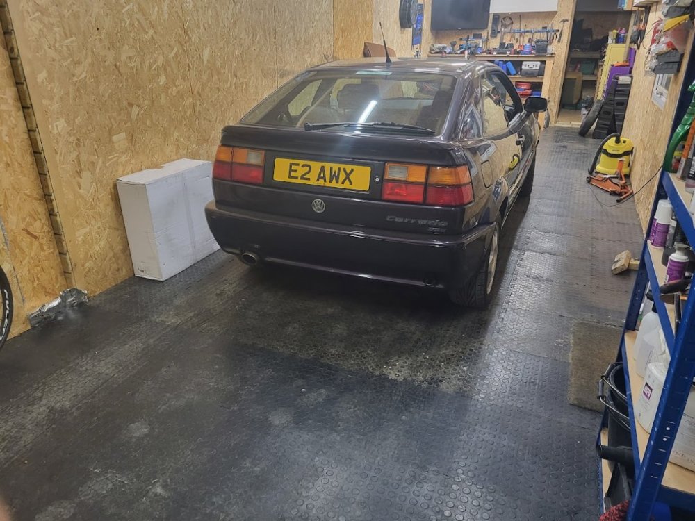

I have a miltek on mine, excuse garage mess..
  On 2/27/2024 at 12:27 PM, _Matt_ said:
Jetex is a good option on both cost and fit. Miltek is another option but it more expensive than Jetex however looks virtually the same when fitted.

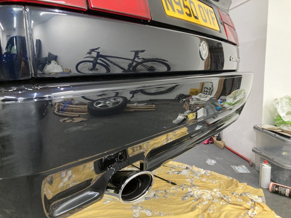

Just coming back to say that (on a friend’s recommendation) I went to Infinity Exhausts near Bristol. They make you a custom stainless steel exhaust. In my case I just asked for as close as possible to original. At £450 fitted, I thought it was a bargain and would really recommend them to anyone in the South West. https://www.infinity-exhausts.co.uk
Edited by Sallyanne
I don’t I’m afraid unless I try to crawl underneath! I’m really pleased with it though as it still sounds original and if anything, goes better than ever!
