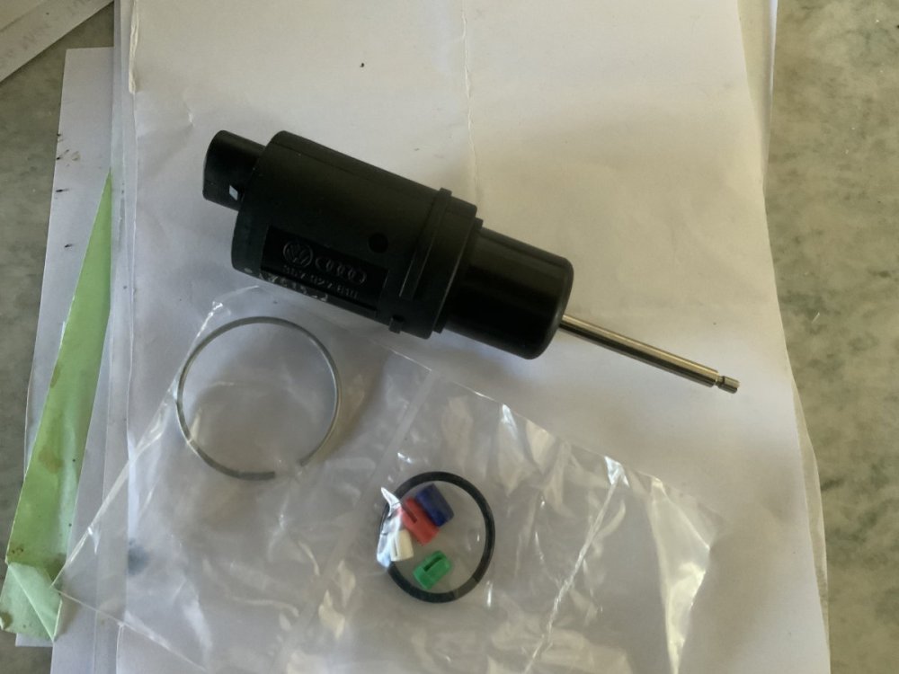

dragon green 6 Posted May 25, 2024 ABS light came on, had my local garage run vancom, turns out it’s the brake pedal sensor ! luckily I bought a spare many moons ago before they went extinct . After un-wrapping it,(foiled bag) I have the coloured plastic bits in a separate bag, I can’t find anything in the Bentley manual, does anyone know where they go ? or will it be self explanatory when I take the old one out Quote Share this post Link to post Share on other sites
_Matt_ 33 Posted May 25, 2024 Iirc one of the them will go on the end to match what you have in the car... however I last fixed on of these myself in 2019 so my memory might have failed me. Quote Share this post Link to post Share on other sites
dragon green 6 Posted May 25, 2024 I guessed as much, as it was used on a few models, thanks for the reply Quote Share this post Link to post Share on other sites
Cressa 46 Posted May 26, 2024 I think it is self explanatory when you get to the old one. Like Matt I took mine out and repaired it a few years ago so not the best memory either. It's in an awkward position, but was an easy fix just by soldering the old one. Nice to have new though 👌 Quote Share this post Link to post Share on other sites

dragon green 6 Posted May 30, 2024 Haven’t got round to it yet, I sort of fixed it,I unplugged the light Probably do it next week, when I’ve got a bit more time,I will post 5he outcome Quote Share this post Link to post Share on other sites
dragon green 6 Posted June 11, 2024 For full closure, the Corrado uses a green plastic “thingy”Really not a job for the faint hearted Quote Share this post Link to post Share on other sites
fendervg 33 Posted June 12, 2024 It's a bit of a pain alright - another reason why som upgrade to the later ABS system - this does away with the brake pedal sensor. Quote Share this post Link to post Share on other sites
