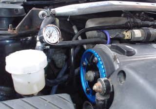

fitted a fuel pressure guage today and am wondering what pressure in psi should it be, the guage is plummed in the pipe that runs from the fuel pump to the regulator
if you haven't seen it before
and plummed in
it is currently sitting at 14 psi, can't imagin it's fitted wrong as its just plug between the pipe, (no electricals)
i think the way youve plumbed it in will only show pump pressure,not system pressure?wot are you trying to achieve? The pump can pump up to 12bar (1bar=14.75psi) k-jet systems normally run 4-5bar system pressure and digipants normally run 3-5bar
i believe i have fitted it backwards now, got no destructions with it so, i'm guessing the fuel has to flow a certain way, as i squeezed the fuel pipe and the pressure went up, so probably looking at around 3-5 as you said.
acheive nothing really just saw this shiny guage and had to have it, but obviously want it to work

The system pressure should always be checked off of the pressure feed line and a G60 will run 2.5 - 3.0 bar and a VR6 will run 3.5 - 4.0 bar when testing pressures.
