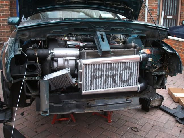

Andy D 0 Posted June 21, 2005 I have just fitted this cooler to my car its made by pro alloy and I got it thought Jabba. It fitted nicely and with minimal modification. Quote Share this post Link to post Share on other sites
dubmad 0 Posted June 21, 2005 what mods did u have to do to make it fit? how much was the kit? Quote Share this post Link to post Share on other sites
Sandy 0 Posted June 21, 2005 I have just fitted this cooler to my car its made by pro alloy and I got it thought Jabba. It fitted nicely and with minimal modification. Do you still have a standard front bumper ? Cheers Quote Share this post Link to post Share on other sites
carpoid 0 Posted June 21, 2005 Andy D, Your pics never appear for me !! Seen the Jabba/Pro ones and they do look good, they fit with standard bumper Sandy - there is a thread if you do a search Quote Share this post Link to post Share on other sites

Andy D 0 Posted June 22, 2005 Yes i still have standard bumpers you have to trim front pannel which sounds worst than it really is. If you are going to fit this cooler get a touch up pen before so you can paint the bare metal after trimming. did this pic work???? Quote Share this post Link to post Share on other sites
