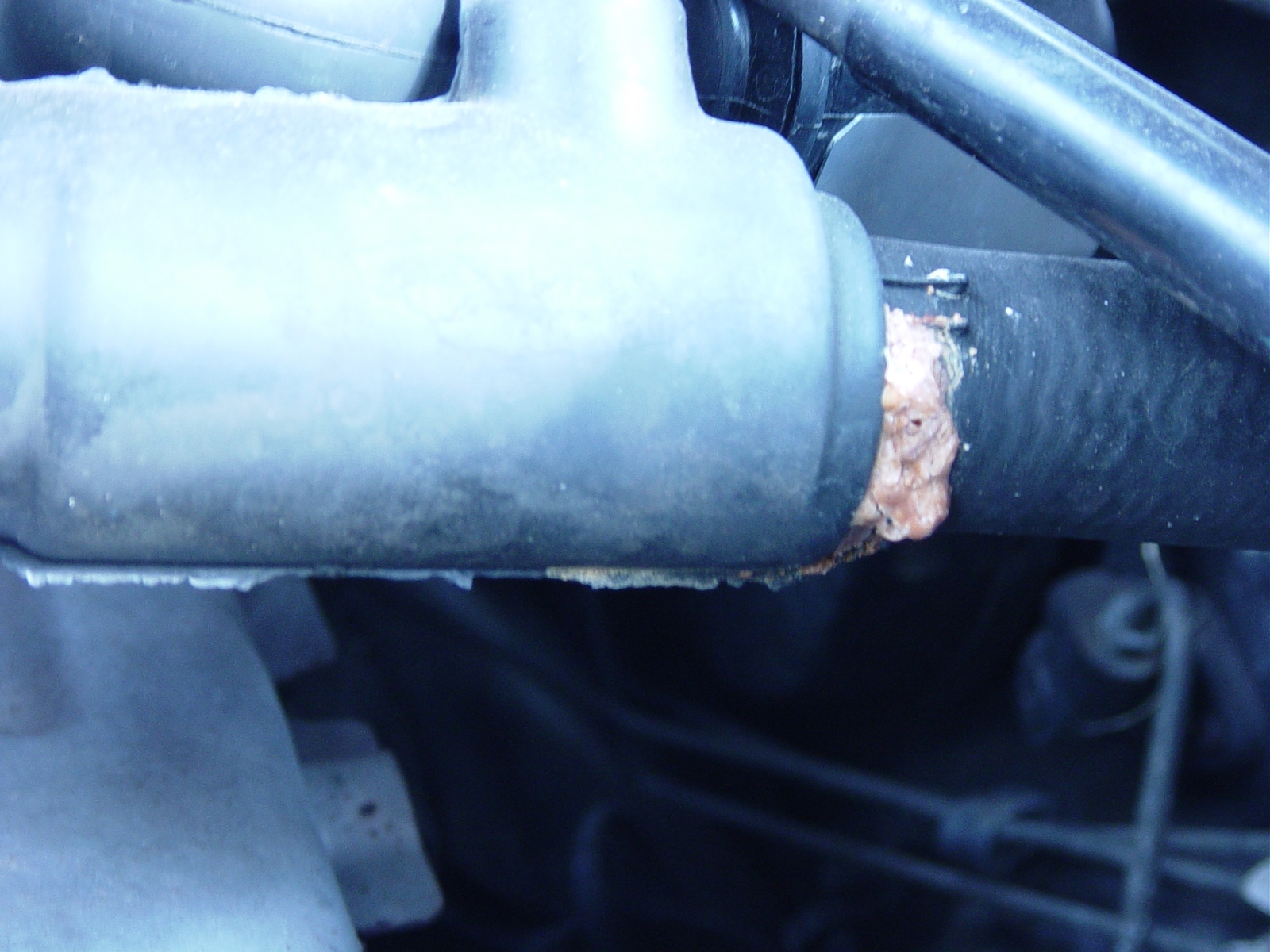

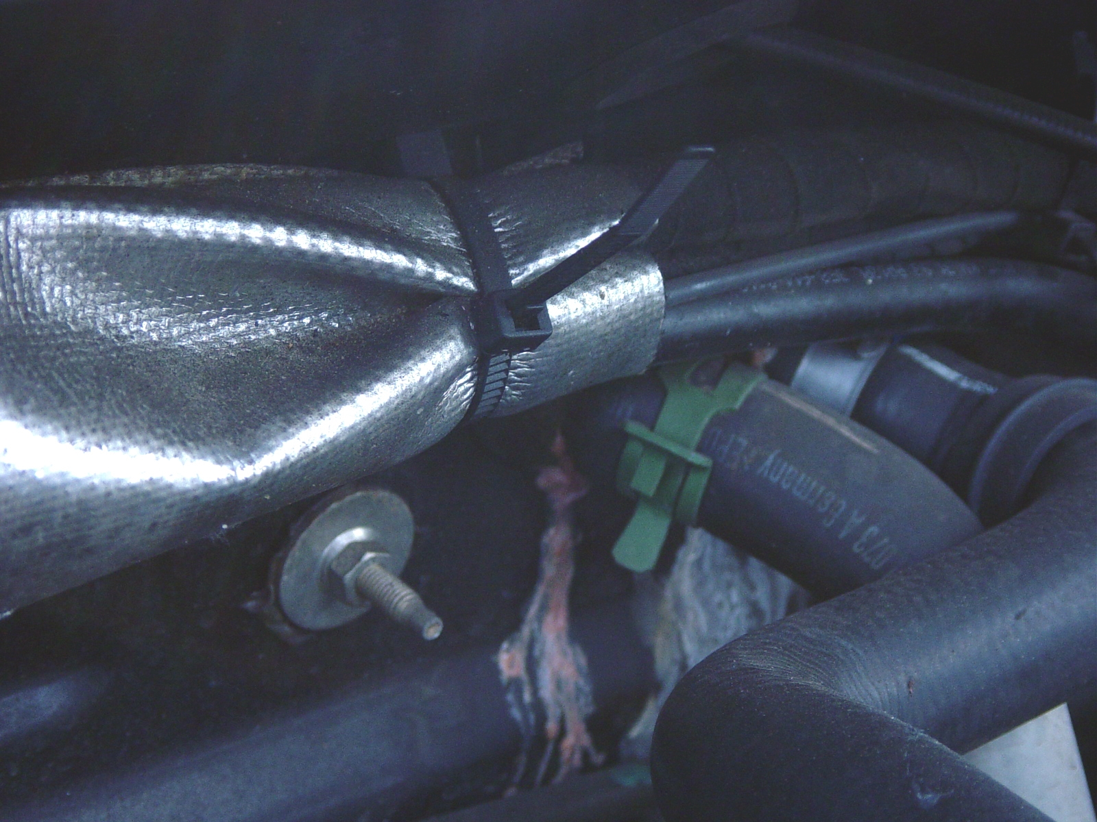

Nick_Micouris 0 Posted July 15, 2005 Hi All Does anyone know what this is? Seems to be around these hoses and it looks troublesome. I opened the bonnet because I could smell fuel and then saw this. Surely it is unrelated? It seems that two hoses have some kind of discharge at the heat exchanger end. Pic1pic2 Quote Share this post Link to post Share on other sites

Nick_Micouris 0 Posted July 15, 2005 from what I can tell - it looks like the actual heat exchanger itself is leaking - I take it that this is a nightmare job? Quote Share this post Link to post Share on other sites

Nick_Micouris 0 Posted July 15, 2005 yeah I am sure it is coolant as they seem to be coolant hoses. The stuff on the hose in pic 2 is of the coolant pipe but the leaks in pic 1 seem to be coming from the actual heat exchanger itself. are they pricey and is it a dashboard out jobby? Quote Share this post Link to post Share on other sites

Henny 0 Posted July 15, 2005 please tell me you just forgot to put the + on the end of the G12 in that last post? If not then this could well be the gunk you get if you mix G11 and G12... :| Does your heater still work? Quote Share this post Link to post Share on other sites

Jim 2 Posted July 15, 2005 I'm not technical but i'll have a go ;) Basically the coolants we all know about are G11, G12 and G12+ - G11 is NOT safe to be mixed with G12 and vice versa because its known that they can form some kind of weirdy gel which will clog the water cooling channels. VW developed G12+ as a replacement for both, which can be mixed with both without any problems. We're concerned that Nick might have replaced his G11 coolant with G12.. and even though he drained the system, traces of the G11 could still have remained and reacted with the G12. Quote Share this post Link to post Share on other sites

Henny 0 Posted July 15, 2005 Nick_Micouris, some places have been known to sell it without telling people of the dangers of mixing the 2 types... :mad: VAG won't supply it anymore... 8) That gunk does look very much like the gunk you get when you mix the two though... and the fact that it's on the lines to/from the heater matrix which is one of the lowest points in the coolant system and doesn't tend to drain properly unless you flush the system through with a hosepipe, you can see where we were coming from... 8) If it's not G12/G11 gunk, and it's not RadWeld, then, to be honest, fuctifino.... :? Does it smell? Quote Share this post Link to post Share on other sites
Nick_Micouris 0 Posted July 15, 2005 what is possible, is that someone prior to me used either regular G12 or Radweld and it was never flushed properly! Any advice on how to drain, flush and refil properly? I have bought 5x bottles of VAG G12+ Quote Share this post Link to post Share on other sites
