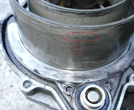

Riley 0 Posted August 12, 2005 yep,none near the edges/apex strips thank god! and its still got the tight spot now even though its stripped,i know what the other guy means,it sort of jumps round,and the top timing bit starts going the wrong way :? (no timing belt attatched mind) Quote Share this post Link to post Share on other sites
stevemac 0 Posted August 13, 2005 Riley, Looks like your tight spot could be the inner of the scrolls in your picture - black mark around the upper edge, close to the seal ? Quote Share this post Link to post Share on other sites
Riley 0 Posted August 13, 2005 near the apex strips steve? Quote Share this post Link to post Share on other sites
stevemac 0 Posted August 13, 2005 yeah, that's the one Quote Share this post Link to post Share on other sites
