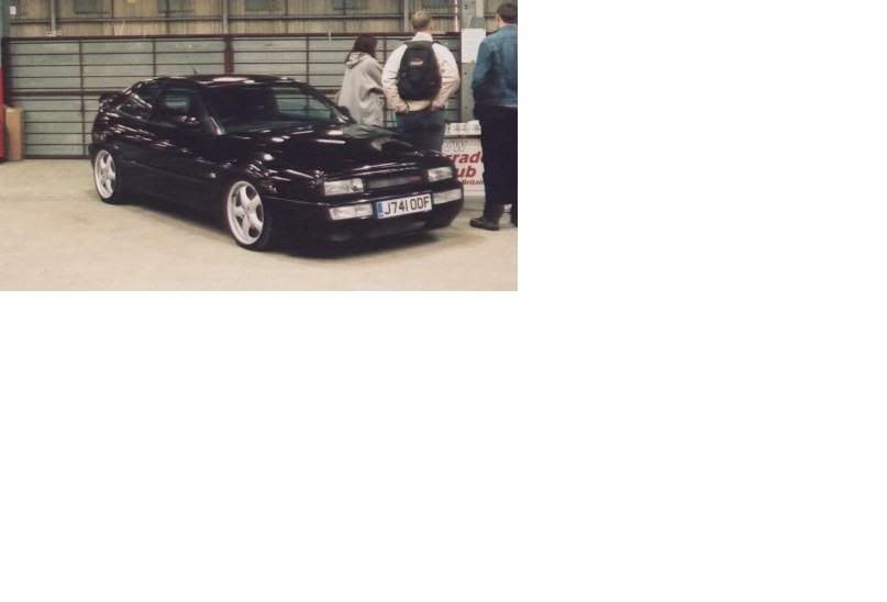

cheesy 0 Posted September 4, 2005 I had 18's fitted to my previous c with between 60-80mm drop chris Quote Share this post Link to post Share on other sites

cheesy 0 Posted September 5, 2005 The et of my old ones were 37 so 35 wil be fine is yours a 16v/g60? chris Quote Share this post Link to post Share on other sites
cheesy 0 Posted September 5, 2005 You should be fine, u might want to consider rolling arches thou chris Quote Share this post Link to post Share on other sites

cheesy 0 Posted September 7, 2005 Just a thought, the wheels may catch on the struts if ya running shocks and spings, some people have fitted them with this set-up. mine were fitted with coilovers I don't know about the handling but the ride will be even worse The ride was very good when i was running 18's better than the previous 17" wheels chris Quote Share this post Link to post Share on other sites
