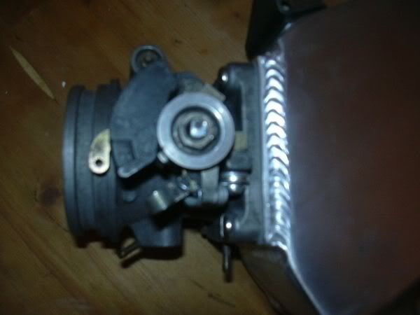

flusted 0 Posted December 3, 2005 Heres the pics,im well impressed with my mates fab work,hes custom made the plenum and welded it to a 42mm top half of manifold,incorparating the flange for the porsche tb Quote Share this post Link to post Share on other sites
boyleonthebum 0 Posted December 3, 2005 cool, looks impressive 8) Quote Share this post Link to post Share on other sites
