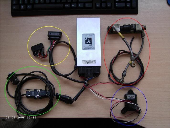

Dec 1 Posted June 28, 2006 Ok, I know this is beyond a long shot, but does anyone know anything about setting up this k-star yoke. I have the k-soft v4 software for it and various ignition + fueling maps. But I'm not sure how you can get this to control four injectors :? :( Basics first....in the pic below: Yellow circle: Connection to ECU Green: Com1 PC connection Blue: 3x (+5v, GND, Signal), wires for the MAP sensor Red: 2 (Red + brown) wires for the fifth injector control? :? So, If there is only two wires (for the single injector) how is it possible to wire 4 injectors? Quote Share this post Link to post Share on other sites

VEEDUBBED 0 Posted June 30, 2006 That looks like an old cosworth air injector photoed within the red circle, on the previous page,it was used to control boost pressure from the turbo,very good,precise way of doing it. The compleat Weber/IAW injection system fitted to cosworth fords,delta intergrales,even horrible cars such as fiat tempras,lancia prismas etc,etc takes some beating,only four wires and a chopper disk on the crank pulley and your done,even the VW's 16v dist. has the same attachment as those cars for the phase sensor,i did it and it was a very good set-up and you have the added advantage that the IAW set-up uses a RRFPR and can use either low or high imp. injectors,unlike digifant 1 were your stuck with high imp.units. The injection unit also has a standard 3 bar map sensor(Lancia delta integrale 16v'89 onwards). Quote Share this post Link to post Share on other sites
