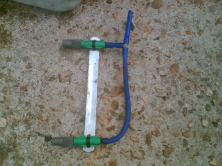

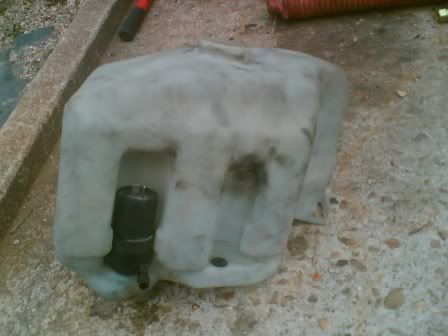

flusted 0 Posted August 2, 2006 Heres my headlight washer bottle and pump il be using for my sprayer. And heres the nozzles mounted on a bike stabilizer bracket! Just got to wait for my pressure switch to arrive# These jets are guna drown the intercooler Quote Share this post Link to post Share on other sites
Kevin Bacon 5 Posted August 2, 2006 Good skills..... let us know if you can feel any difference. Quote Share this post Link to post Share on other sites

flusted 0 Posted August 6, 2006 I have it plumbed up to rear wash tube at moment and can definatly feel the difference!!!! I gave it some stick without it,then gave a spray for a few seconds,then after a short time to allow water to cool it , i floored it again and it pulled better Quote Share this post Link to post Share on other sites
