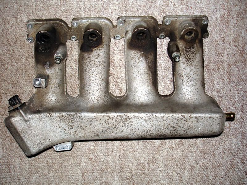

mrbeige 0 Posted September 11, 2008 If you find Crooksey's members gallery, he has a modded 1.8T inlet. Not too sure if he has a picture of it on its own. There is a guy on Ed38 with a Passat 16vT as well, with a 1.8T manifold, but I'm not sure if he welded on a fabricated flange or not..... Standard manifold (this is the one I have) Found a pic of his manifold.... Quote Share this post Link to post Share on other sites
don_stavrou 0 Posted September 11, 2008 thanks i think i got the idea now so all you basically use off the old mani is the flange that bolts onto the side of the engine..? then drill any holes etc.. thanks Quote Share this post Link to post Share on other sites
