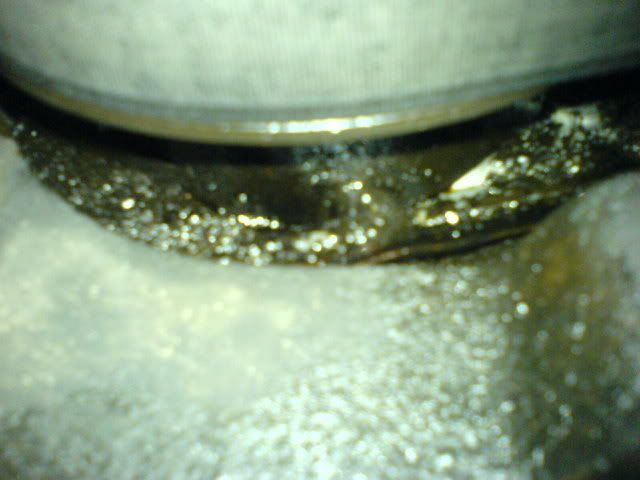

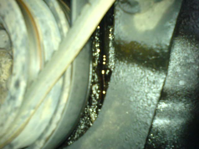

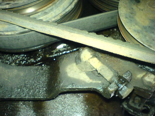

g60greeny 0 Posted January 13, 2007 just took a few snaps,it only seems to really leak while the engines runnin? anyone shed any light as i know feck all :lol: Quote Share this post Link to post Share on other sites
g60greeny 0 Posted January 13, 2007 these pics no help ? Quote Share this post Link to post Share on other sites

g60greeny 0 Posted January 13, 2007 i'm not sure the pics are any good,thats the underside of the engine,could it be to do we the sump? Quote Share this post Link to post Share on other sites

Tempest 0 Posted January 13, 2007 The oil you're trying to point out to us in those pictures, can you see any trails as to where it is running to (oil leaves a trace)? If you can see a clear path from that pulley in your picture, then you'll have to replace the oil seal behind the pulley (looks like the crankshaft pulley seal that's gone). If the oil is leaking when the engine is running, TBH, I would not drive the car anymore until you het the problem fixed ;-) Tempest Quote Share this post Link to post Share on other sites
g60greeny 0 Posted January 13, 2007 yeah its been parked up all night i left a tray underneath it last night expectin it to be full this mornin,which it wasnt so i started the engine up an thats when it starts to drip? cramkshaft pulley seal,is that expensive? also the noise i thought was a wheel bearin could that be linked as i checked the wheel i thought it was its solid no movement @ all? Quote Share this post Link to post Share on other sites
