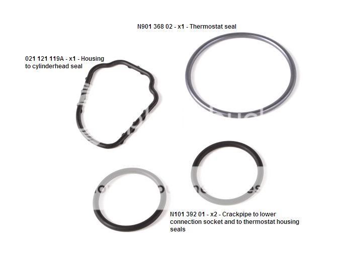

Ok well i'm thinking of doing a right up later but the seals I used were
021 121 119A - x1 - Housing to cylinderhead seal
N101 392 01 - x2 - Crackpipe to lower connection socket and to thermostat housing seals
N901 368 02 - x1 - Thermostat seal
N903 168 02 - x3 - Sender units seals
Hope this helps.

So just to confirm, these are the only seals you need for the thermostat housing itself?
I thought there might be a seal between the thermostat housing and the cover (as well as the thermostat O-ring) ??
