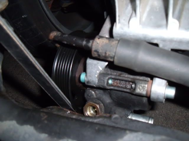

quicky1980 0 Posted April 8, 2010 Cheers Right, engine sitting nicely on its new front mount and it means I can still use the standard water/oil cooler :clap: Only problem I now face is that the front subframe fouls on the power steering pipe that connects to the pump. No idea what to do, dont want to bend the pipe as it may snap, dont want to cut the nicely powder coated front subframe. ar5e! Here's a picture with the pipe disconnected. Bought a load of new parts from tps inc new bolts for the front hubs and new lambdas which werent cheap! It's great to see the car back on all four wheels again Quote Share this post Link to post Share on other sites

KipVR 1 Posted April 8, 2010 Is that the 12V PAS pump with the 24V pulley? Quote Share this post Link to post Share on other sites
quicky1980 0 Posted April 10, 2010 Is that the 12V PAS pump with the 24V pulley? Sure is, the pulley itself is aluminium too looks very nice. Kip, tried calling you today but the number I called didn't go through. any chance you could pass it on to me again? Loom finally arrived today so spent today fitting it through the bulkhead, what an ar5e of a job! :censored: done some tidying and little jobs. Might be ready to turn the key tomorrow, feeling a bit apprehensive about it all lol Quote Share this post Link to post Share on other sites

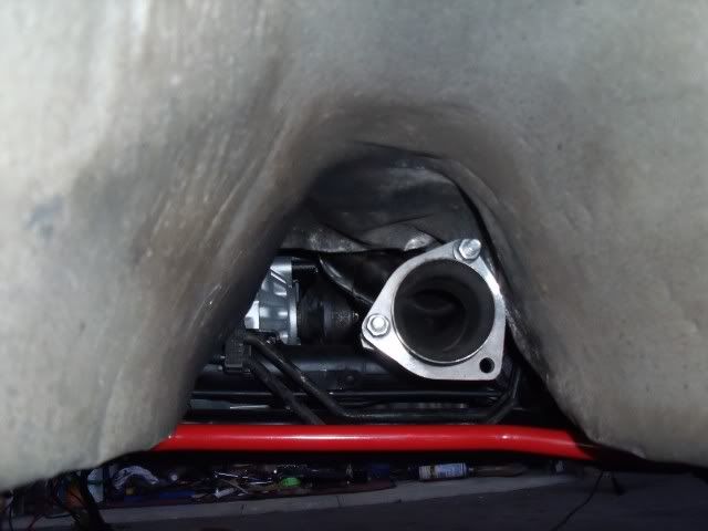

quicky1980 0 Posted April 15, 2010 damn it! now i have a fuel leak and exhaust issue to sort out. The fuel leak should be straightforward enough to sort out but the exhaust is a bit confusing. The manifold sits very close and touches underneath the car :shrug: argh!! Quote Share this post Link to post Share on other sites
herisites 0 Posted April 15, 2010 damn it! now i have a fuel leak and exhaust issue to sort out. The fuel leak should be straightforward enough to sort out but the exhaust is a bit confusing. The manifold sits very close and touches underneath the car :shrug: argh!! Dubpower manifold by any chance? Mine's the same, I even had Pete out with a fcuking great gas bottle and blow torch and we tried bending them slightly, we budged them just enough to not touch but they're still too tight and they push the rest of the exhaust out and mine now rattles on everything! :bad-words: The problem is, Pete developed these manifolds for the Mk2 Golf and is selling them as Corrado ones as well even though the alignment is clearly not correct. When I was last at Stealth they had a Mk2 with R32 and Dubpower manifolds and they fit perfect on that, mine was exactly the same as yours. Quote Share this post Link to post Share on other sites
herisites 0 Posted April 15, 2010 Here's how mine was with the exhaust all on. Also what engine mounts are you running? I was VT front and gearbox and std rear, I changed the gearbox to a mk2 golf diesel one (which certainly helped with engine vibration and smoothness!) and that helped the exhaust alignment slightly as the solid mount was slight higher I think. Quote Share this post Link to post Share on other sites
quicky1980 0 Posted April 15, 2010 :mad2: :censored: The exhaust isn't cheap so Dubpower will be hearing off me very soon, esp' when they knew it was specifically for a corrado! Started her up again today and fixed the fuel leaks :D but noticed that the engine hunted quite a bit. Any one have any clue why mine hunts so badly? Does it just need to run under driving conditions to "learn" the fueling etc? Quote Share this post Link to post Share on other sites

RedTyphoon 0 Posted April 16, 2010 Nice job. :notworthy: I have same problem with Dubpower downpipes. Its bloody too close. I was especially asking Pete if his done any modifications on it. As I know some of you had problem with it. :bad-words: But i have to say on mine its sits very close but not touching the tunnel. Can anyone tell me why all of you doing conversion are putting slimline fans instead of factory ones? Quote Share this post Link to post Share on other sites

pete_griff 0 Posted April 18, 2010 hey Sam - congrats on getting it sorted as far as it is. sorry to hear people are having these downpipe woes - i made a custom job from Pete's original item to allow me to run the r32 twin cats so i never had the problem - looks to be a bit of a 'mare though pal; hope you get it all sorted ok and asap. congrats again - please keep us posted :D EDIT - the hunting also sounds like you've got an air leak to me too - try there first IMO Quote Share this post Link to post Share on other sites

quicky1980 0 Posted April 21, 2010 Hiya mate the corrado looks great! I work just up the road from you at tc harrisons i havnt seen the corrado around though! I've seen a red corrado driving around Peterborough, and another red one parked up near the Nene parkway. Are these yours? I'm still having manifold and de-cat issues. It causes a really bad fit to the whole system, maybe I got a bad manifold? Will try and get Pete from dubsport to sort something out. The bad running may have been sorted. I raised the fuel pressure to 3 bar (that figure right?) and think I found an air leak in the induction hose joint so heres hoping. All is good. Tell you what, it sounds soo much quieter at idle. Anyone know why my interior engine temp gauge doesnt work? Is this normal? I may have damaged the front wheel bearings as I forgot to tighten up the driveshafts before moving the car forward and backwards under its own steam. But will suck it and see. Last things to do now are, wire up the fan, do up the driveshafts, fit the slam panel/bumpers/lights and indicators and then I think Im done :-) Quote Share this post Link to post Share on other sites
